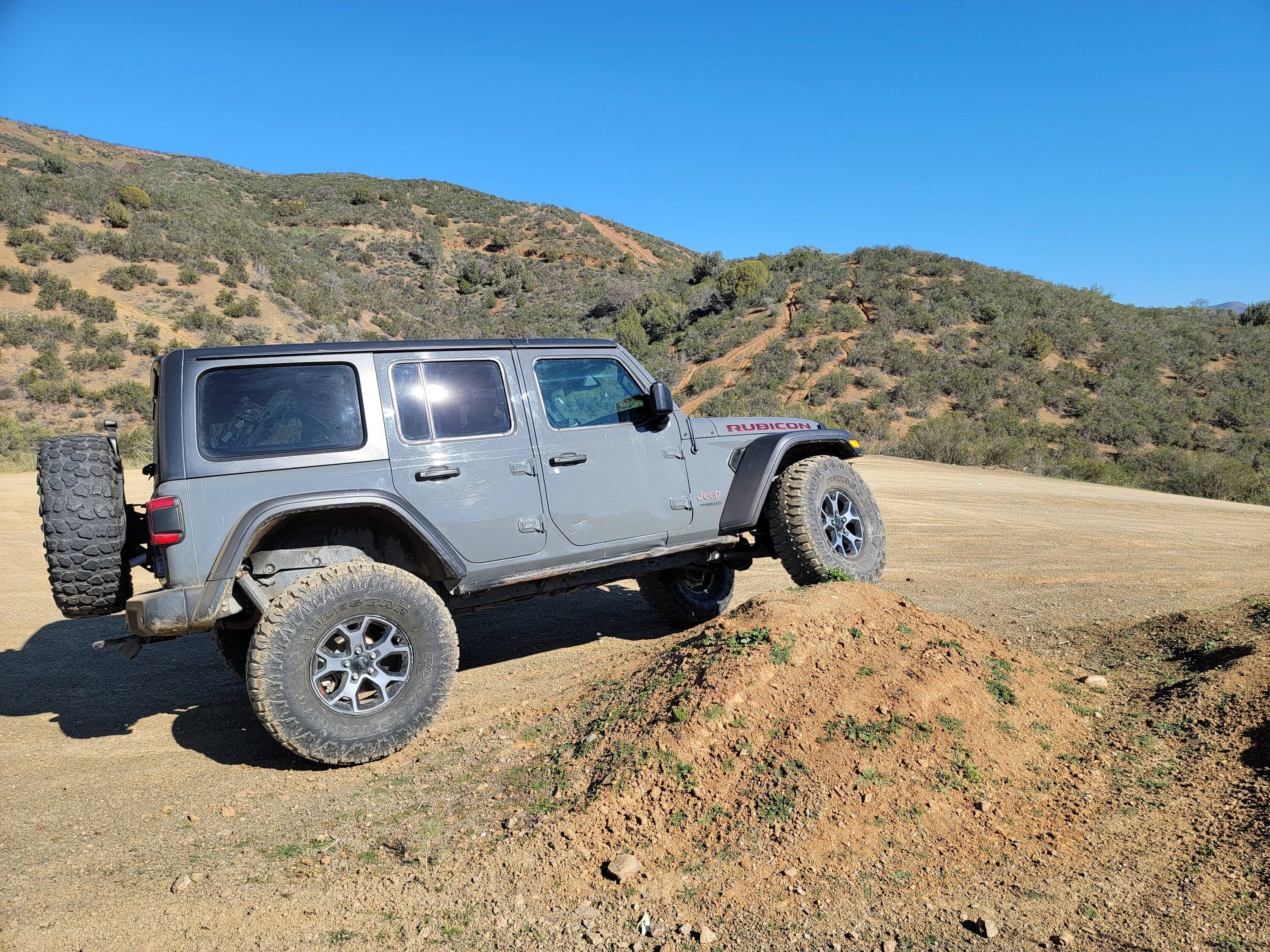

I for one really liked the handling of the flipped drag link on our 2019. Running 2" Bump stops front and rear on 3.5" of lift was just about perfect. With the rocksports we had on originally there was about 1.25" of left over uptravel in the shock up front at full bump. At that point the 38's were rubbing the fenders and the tie rod would just rub the frame if turned passenger at the same time. In my opinion it was about the perfect combination of parts to maximize my up and down travel, on road manners, and not get in to trimming fenders etc. Off the shelf parts in a budget friendly hodge podge. This thread and the fact that the 2022 already has a little play in the pitman arm tie rod end pushed me to pull the trigger on the steersmarts no drill flipped drag link and bracket. Being an XR it already has the long bump towers, we will see how much I need to add once it's installed. I'll definitely report back here once I have it dialed in. Flatter suspension links are ashtrays good wether it's control arms, track bars, or drag links. On this rig I'm going for flatter than factory XR components with the 3.5" lift springs. The front has control arm drop brackets already. Steering is next. Rear drop brackets will likely wait until winter. I like to get some time, road miles, and wheeling in with each mod so I can truly judge the difference each makes. As you can see, enough bump to keep 38s out of the fenders is enough bump to flip the drag link. Now if you're trimming fenders and trying to really maximize up travel it would get in the way. I liked the handling difference enough I might even consider notching the frame in order to ruin it in an lcog build.
