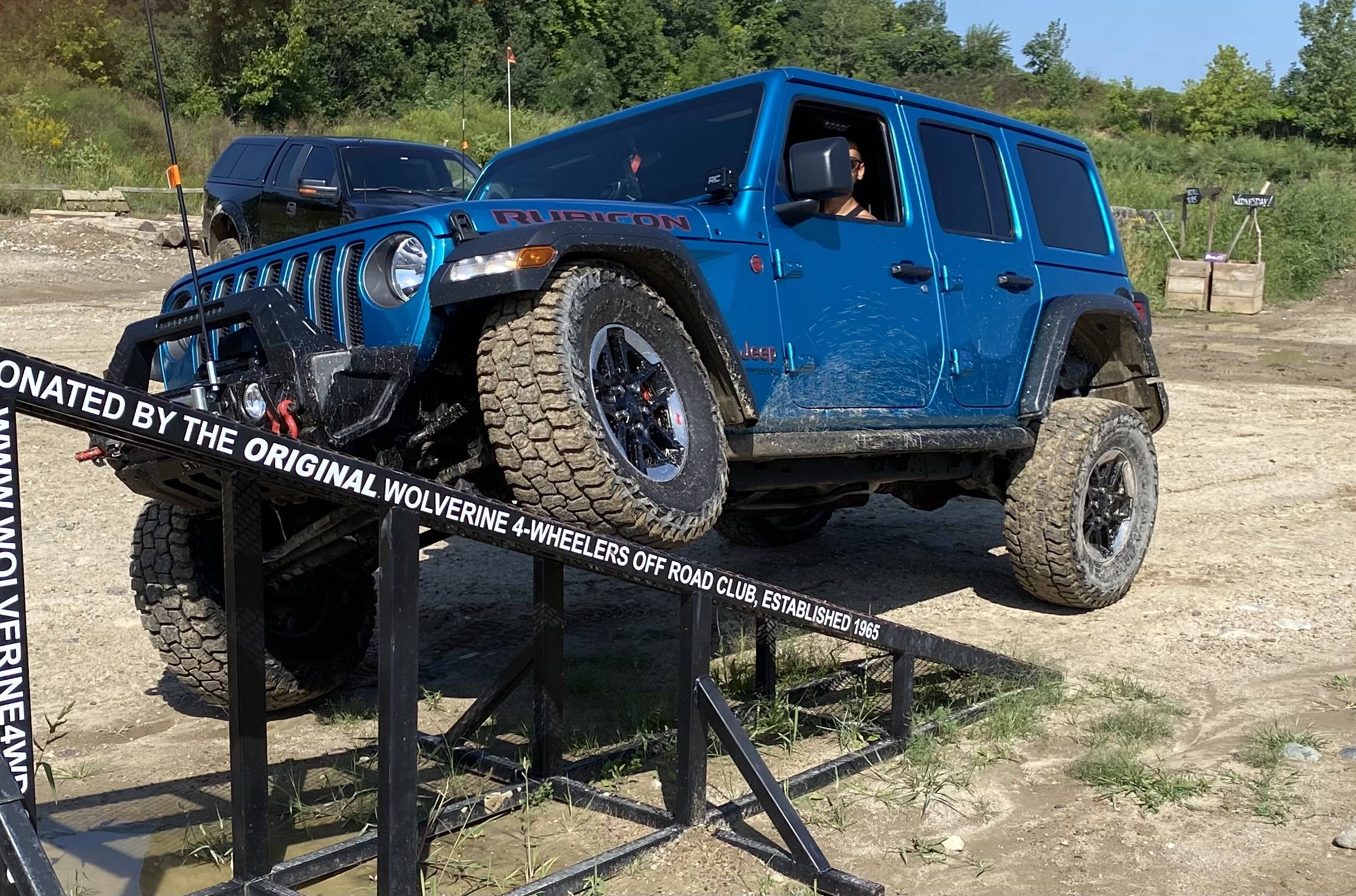

If it is not a Rubicon, the fenders are already lower so I would imagine that it will still rub. The suspension might help but the other than +45 offset on the rubicon with 35s will rub or even contact the border of the fender if it has to much of a negative offset. You want an offset that the entire tire is stuffed inside the fender wells. This is the first mistake People do when changing the wheels on a wrangler. They put these extreme negative offsets or spacers and then complain that 35s rub on a Rubicon. If it is just for looks and it’s never going to see off-road, then you can get away with it.

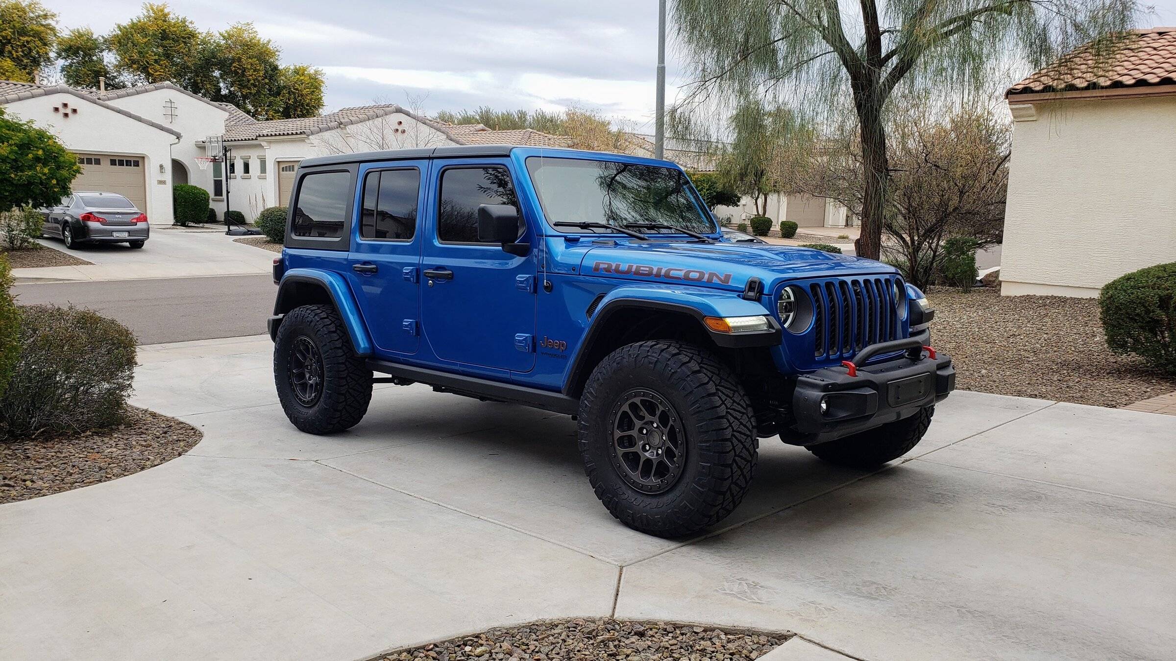

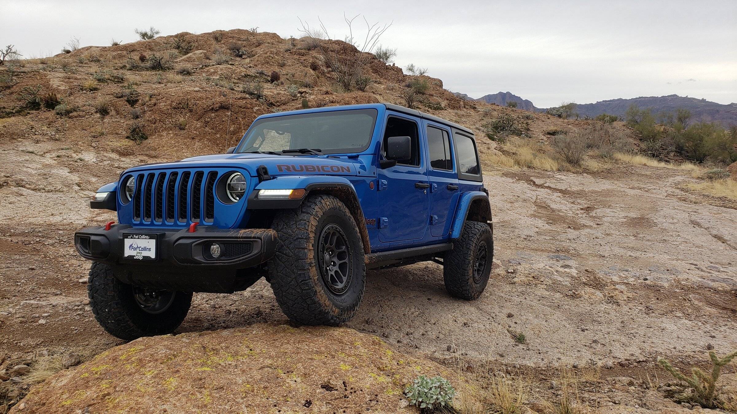

I bought a set of XR takeoffs in January also and considered myself lucky to find them. $1300 for a set of 5 with rings and lug nuts.
I wanted a JLUR XR Diesel, but since it's not offered I'm just building my own (with upgraded suspension components). To each their own ?
I also went the do it yourself XR diesel option.

They look great on the blue!
Those are some meaty tires. Nitto Grappler 35/12.5?
Actually 315/70/17. the are a smidge wider, but a smidge shorter than the 35/12.5. I wanted wider for sand.
