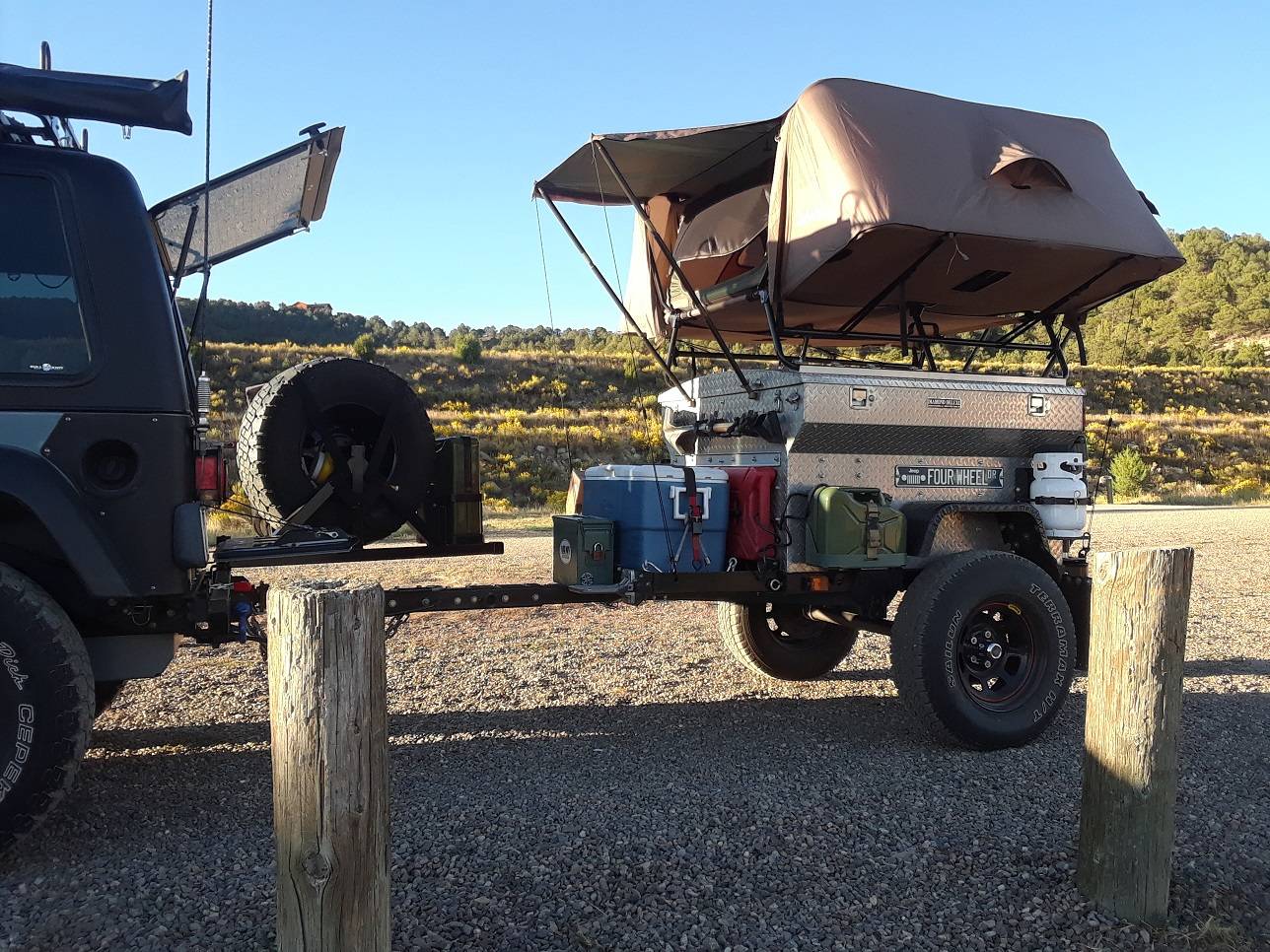

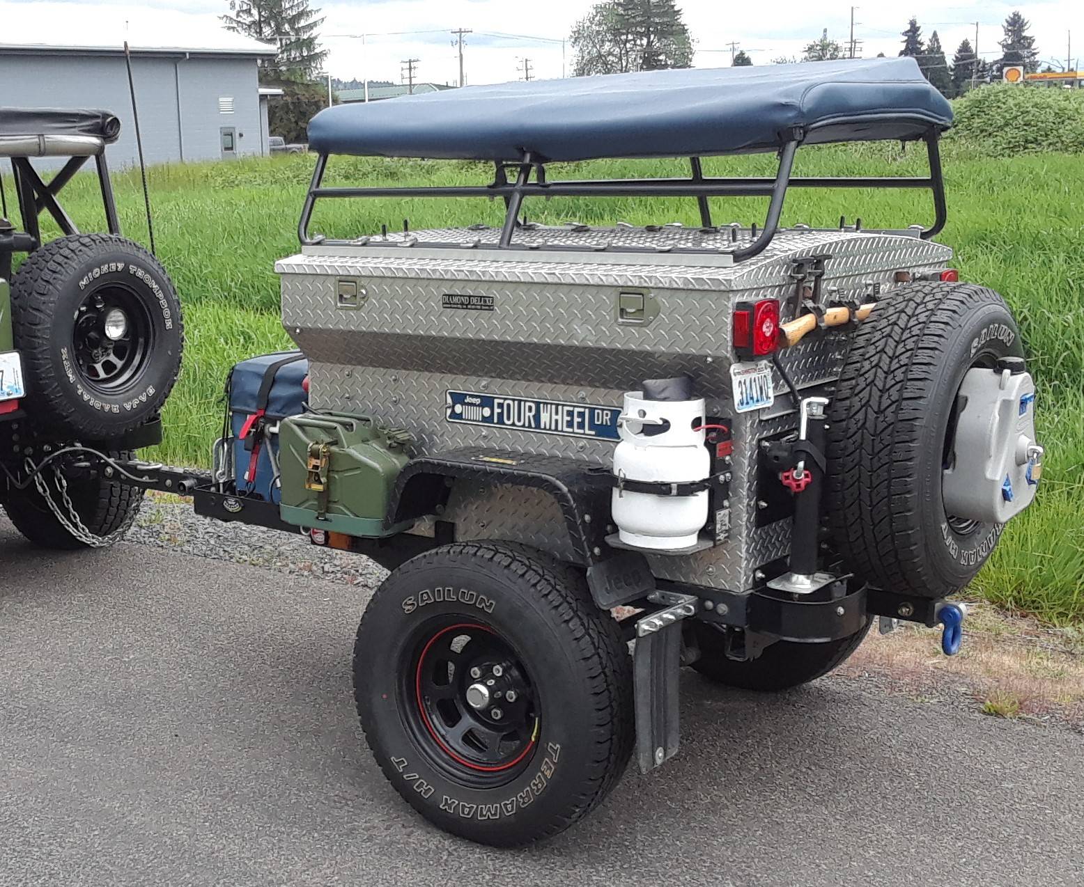

What brand of trailer is that ? I’m guessing that you like it ? Any downsides to it ?

Recap: OP is interested in taking his JLU on Overlanding trips, and still keeping it as a daily driver.
The payload isn't that great on any Wrangler-type Jeep. And when overlanding, you've got heavy stuff, and you've got lighter but bulky (space occupying) stuff. And if you want to keep your Jeep as a daily driver, you probably don't want to be driving around in a loaded-up Jeep all the time.
That's where a little trailer comes in. I built it - mine is based off a Harbor Freight trailer frame. The tub measures at the base 40" x 50". It has 235/75/15" tires, and has a couple more inches of clearance under the trailer's straight axle compared to the Dana 44 under my TJ with 33" tires. It has been towed literally tens of thousands of miles over the years over all sorts of terrain and does great. My trailer stays parked in the shop loaded up till I want to go. The tub is tall enough so I can stack two 8-gallon action packers on top of each other and still have a couple inches to work with with the lid closed.
The tub is just an aluminum diamond plate box with a hinged locking lid (think truck cross-bed toolbox). I had it built like a WWII trailer tub because I think it looks cool pulled behind a Jeep. No fancy slide outs or anything - a box with a lid. There's a matching spare tire for the trailer bolted to the back of the tub, so no matter what vehicle I tow it with, I've got a spare for the trailer.
It is amazing how much stuff you can put inside and outside the trailer's tub. I have Cabela's Double sized tent cot bolted to the lid as my RTT. The lid can still open with the tent opened up.
Here's a link to the trailer build. I'm a nurse not a mechanic or fabricator - if I can build this, you can too. I had a company build to tub for the trailer.
Mini Harbor Freight (type) Trailer Ultimate Build-Up Thread | Jeep Enthusiast Forums (jeepforum.com)
So for me, a small trailer gives me the best of both worlds - I can drive my Jeep as a daily driver, and when I want to go Overlanding, I'm pretty much packed and ready to go (just add perishable foods in the cooler). Once I get my new JLU, I'll probably still bring the trailer Overlanding. The JLU should barely notice it is back there. My four-cylinder TJ definitely knows it is back there.
Please PM me if you have any questions about the trailer.
