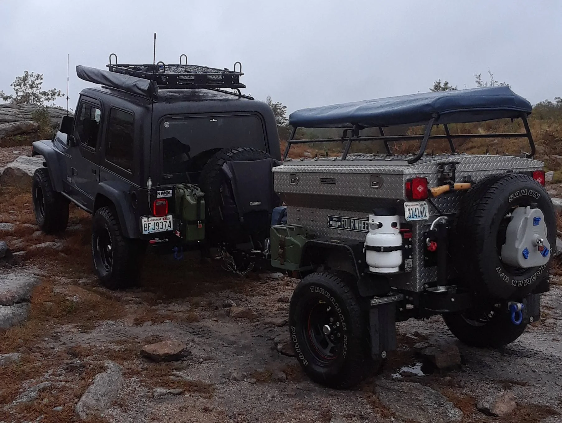

For lots of payload or to just bring lots of stuff (bulk storage space - cubic feet) to keep you comfortable and happy (or your spouse comfortable and happy!) when overlanding, more than your Jeep can handle safely (even after upgrading to more of a HD suspension) or has room for inside, I would suggest a trailer. Preferably one on the smaller side.
Jeep Wrangler JL Willys vs Rubicon Overland Adventure.2
Even a small trailer like this one (built on a heavily modified HF 4' trailer frame) can carry inside and outside the tub a lot of stuff and weight. A new JLU would hardly know it was back there.
It is easier on your vehicle to pull a loaded trailer (within reason of course) than to carry the weight in/on the vehicle, even accounting for the weight of the trailer.
Here's a very long build thread on my lil' trailer if you're interested in something like this. Even once I get my new JLU (ordered with the tow package) I might take my trailer on some of my overlanding trips (depends on the trip - a lot of my camping gear is more bulk than weight though, and I'll have a lot more room in the back of my JLU than I do now in the back of my TJ).

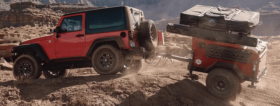

Getting a small-ish trailer (I'm talking WWII sized kinda trailers or like the red one pictured just above) would be cheaper in the long run than selling his Willys and buying a Jeep truck. With the truck you would lose the inside cargo carrying space. Yes, you could put a topper on the truck bed.
