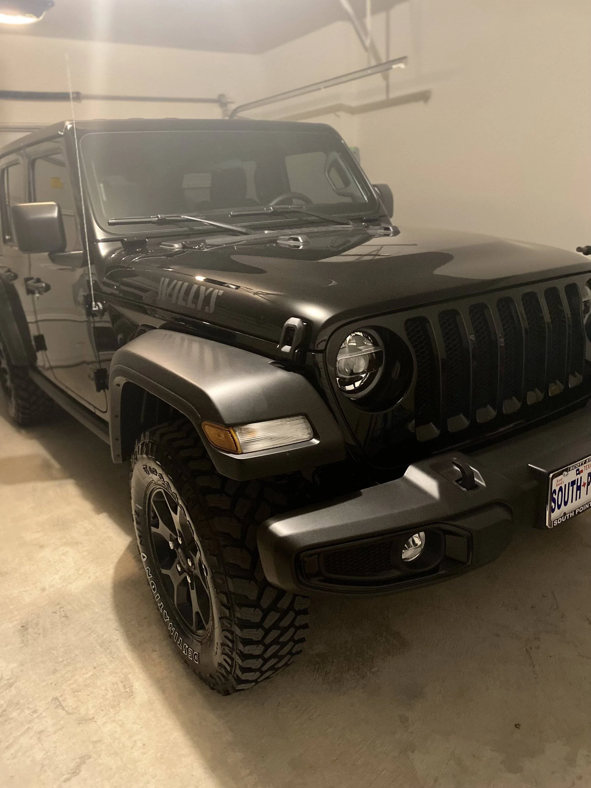

Hi,
I have both, 2021 Willys and a 2022 Rubicon. If you are not planning to do much serious off roading then get the Willys. My Willys also came with the Firestone Destination mud tires that work very well in mud or deep snow, but are totally Useless on ice. My Rubicon came with the Falken Wildpeaks that work really well on ice and snow and ok in moderate mud.
For a daily driver you are better off with the Willys on a set of Falkens. I find my best off road settings for the Willys are to shut off the traction control and the electronic stability control.
If you want a little more security then mount a winch and you pretty much can go anywhere in your neck of the woods. The Falkens give you about an inch of extra lift. Instead of the tent I picked up a Geo Pro 12rk. With this set up I can have a base and explore.
