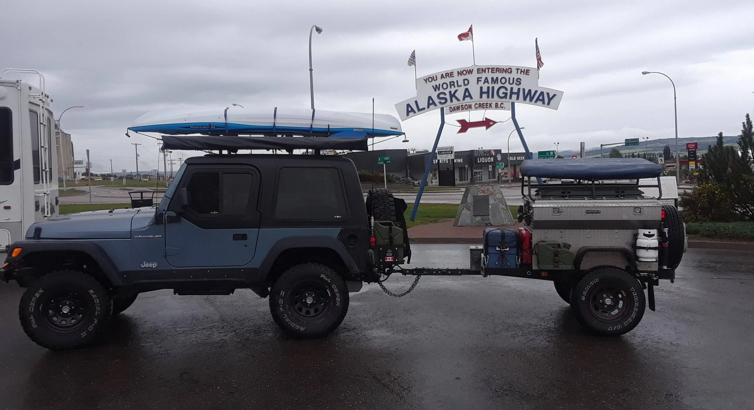

Here's my current overlanding set-up (before the Mickey Thompson Baja Boss AT tires). I need a trailer because there's not much room in a TJ. And a JLU will be so much more comfortable to drive in for the long distances I tend to Overland with (I'm usually gone at least a week or more). I think my new JLU will feel plush compared to my TJ.
Jeep Wrangler JL Willys vs Rubicon CA pre-run.2
Speaking of Canada and Alaska... I get around.
Jeep Wrangler JL Willys vs Rubicon Arctic Trip.3
