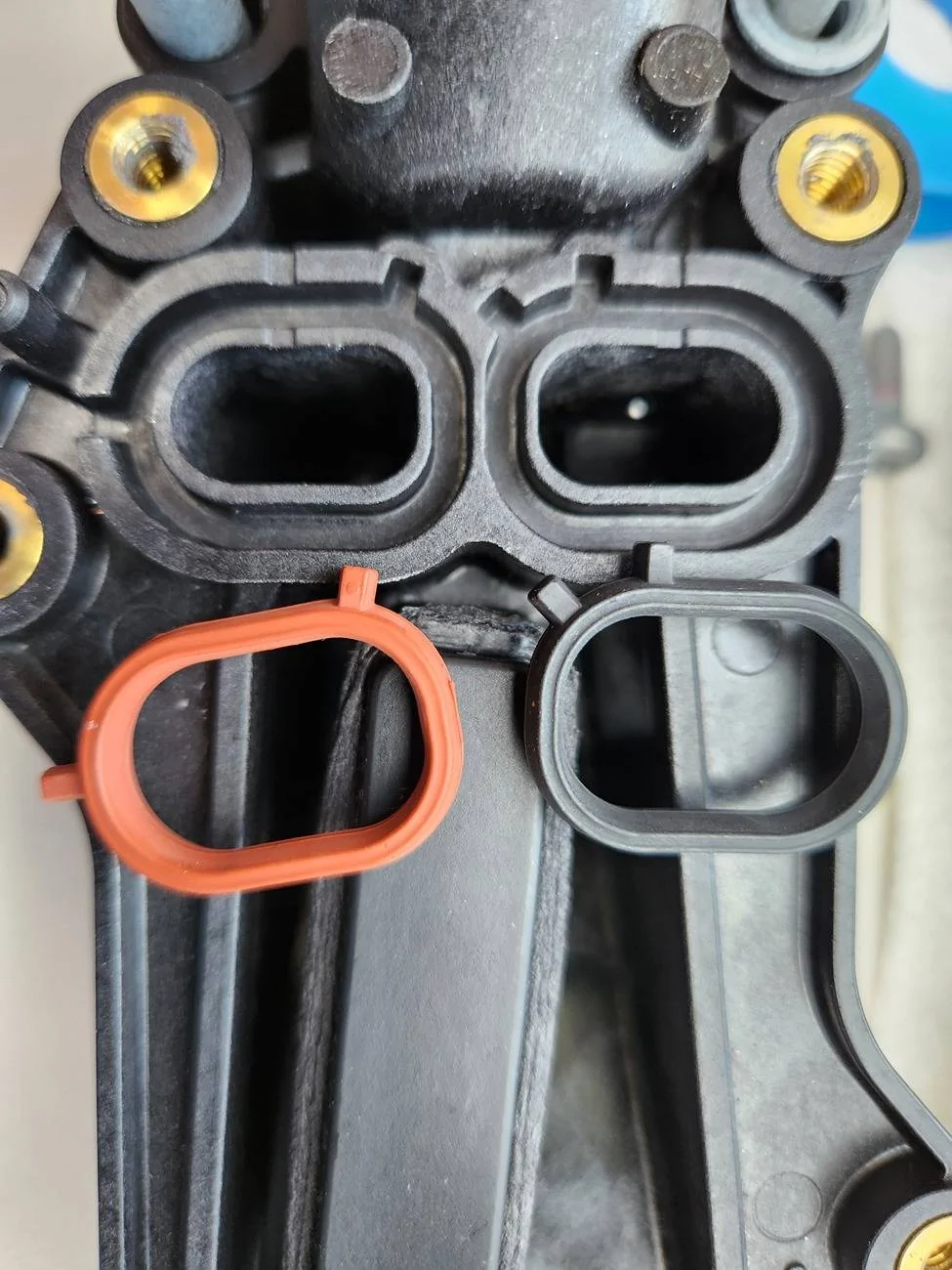

I always use the Mopar ones cause they're cheap enough. Your o-ring is in the grove like 1/4" from the top, right? Assuming yes, but dang, that's weird.
Jeep Wrangler JL V6 engine issues 1729798159596-xw

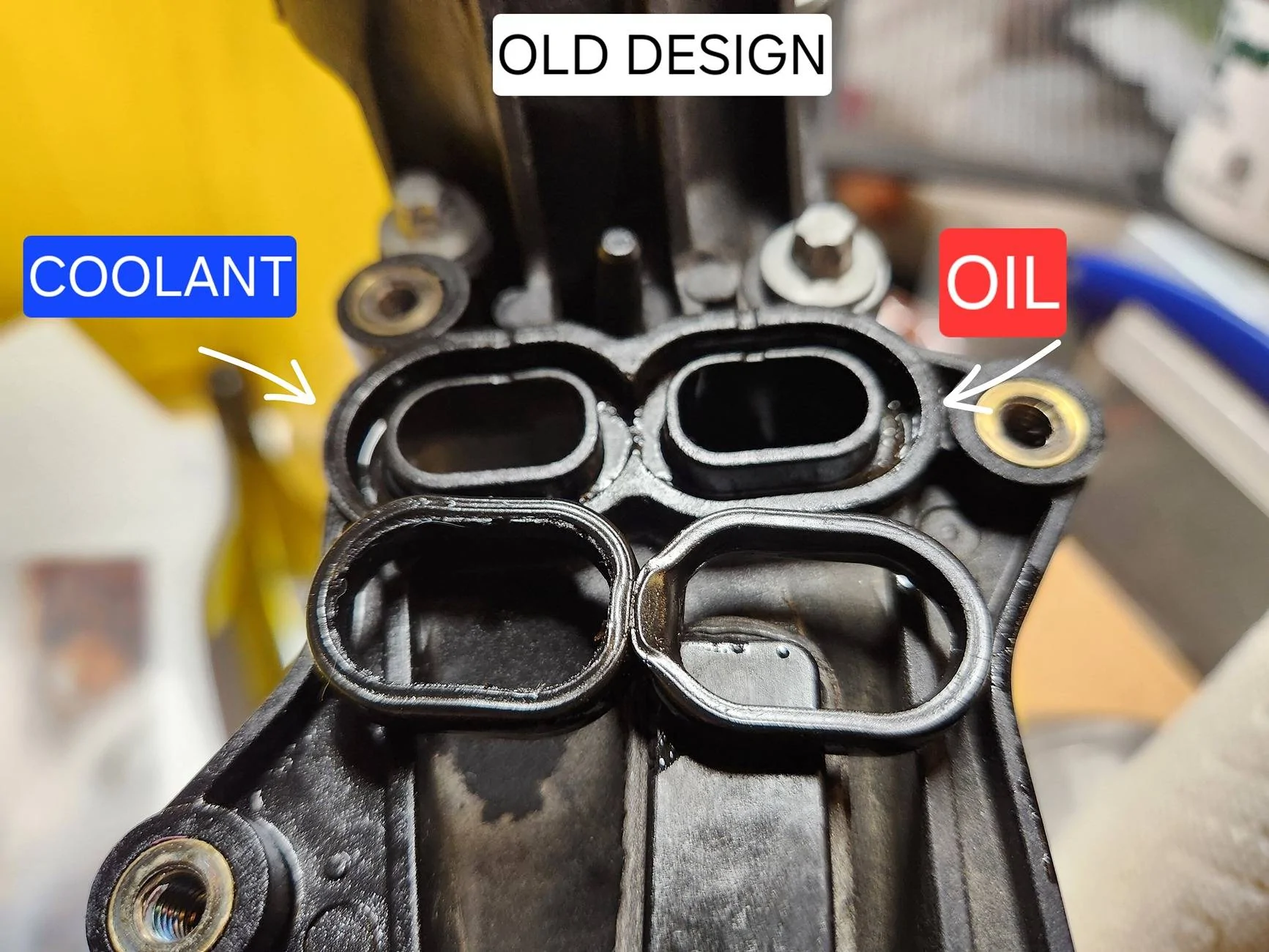

What problems are you referring to with the dorman aluminum housing?

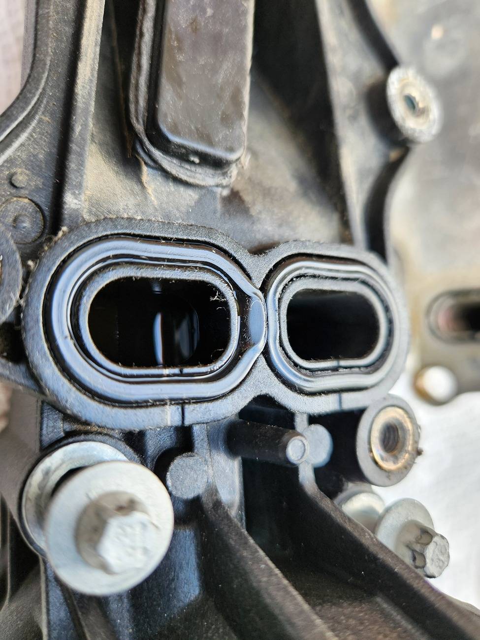

Dorman copied the old mopar "figure 8" design of the seal configuration between the cooler and the housing.
This is what happens to "figure 8" seals.
Jeep Wrangler JL V6 engine issues 20240301_155435
Jeep Wrangler JL V6 engine issues 20240305_035357 (1)
