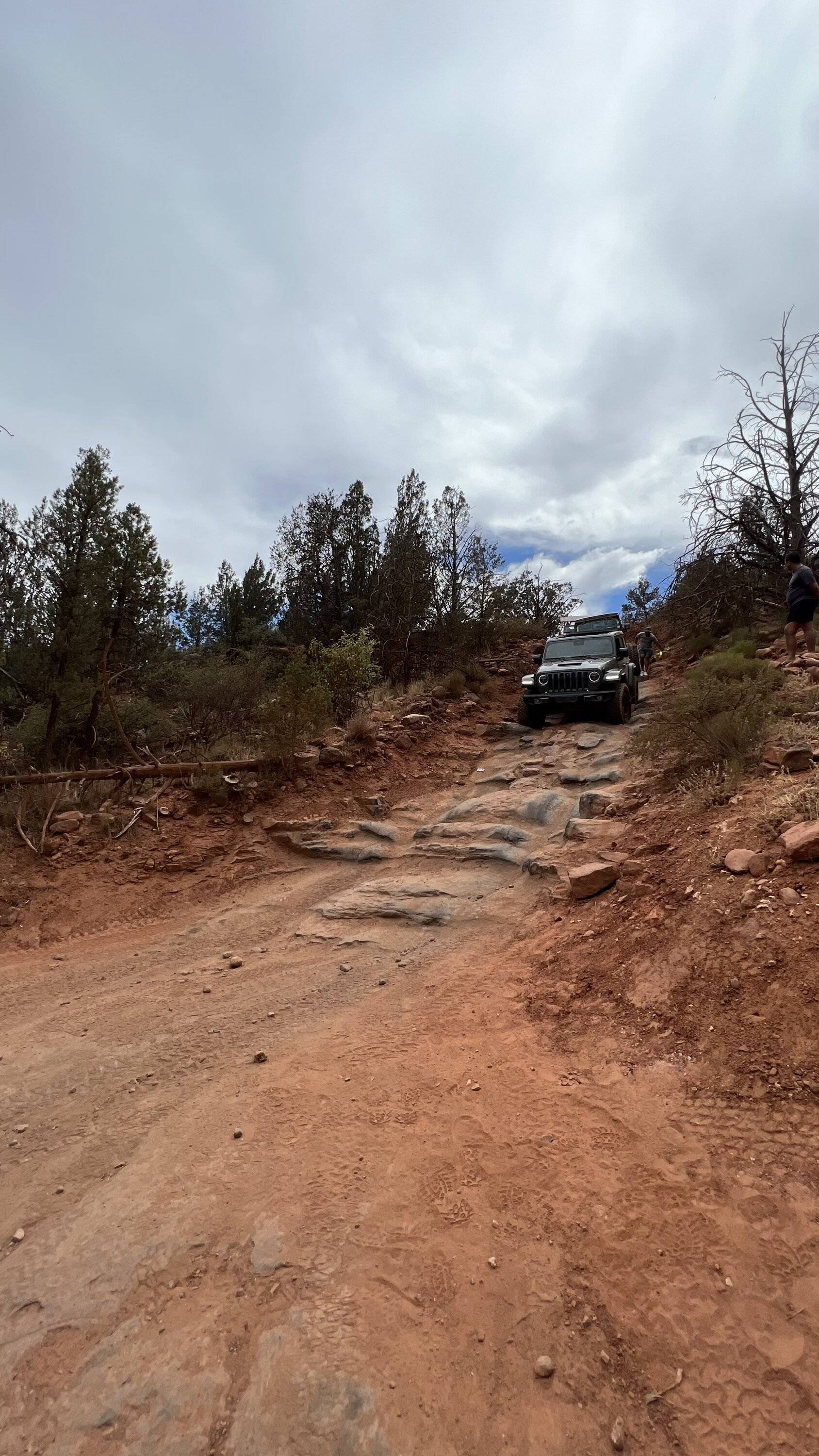

Dealing with the same
Issue right now but I have had my seatbelt on and it still does going downhill. The starter just turns the motor over but nothing. My theory is that on a decline the fuel pump isn't getting fuel. Level it out let the fuel pump run for a few and then starts right up. Seems like the fuel pump is at the back of the tank and doesnt get enough gas when on a decline.
edit: the hill I was going down on was maybe a 12-15 degree angle (pic below of the jeep when it died) and I could hear it sputtering like it was out if gas and just died. Had 1/2 tank at the time

Looks like Devils' Stair Case on Broken Arrow....It would be interesting to fill up and run that section again....

I can probably replicate the situation in a safer location, dont want to get stuck up there again. Took another jeep to yank me to level ground to get it started.
Another thing to note is that while on the decline my fuel registered as empty. On level ground back to half tank.

Does the 392 have a different fuel pump/pickup location than the 3.6L? This whole thread is worrisome. Rock crawling in Moab but needing to do so with 3/4 to a full tank is going to cause issues for a lot of 392 owners. Sounds like it's a problem that needs a recall with a corrected fuel pickup to correct the issue. I'm not sure enough owners of 392's will experience this in the numbers to get this to that point to be resolved. Meanwhile I feel like I just ordered a wrangler that may get me into a bad situation that my current one wouldn't of.

When you fill up at a station, when you're at 1/2 tank on the Jeep gauge, what does the gas pump register? Just wondering if the sensor in the gas tank is correct...
