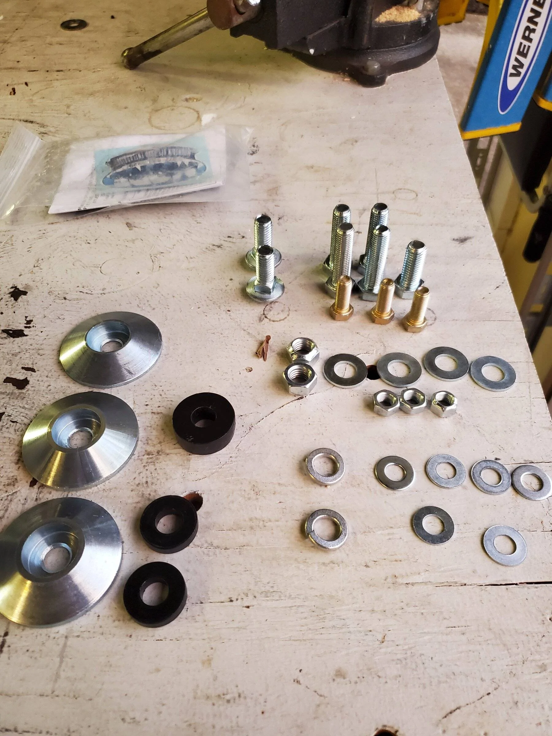

Parts are good, minus ups testing them out. I was worried about missing hardware since it was rolling around in a open top and side box. All there.

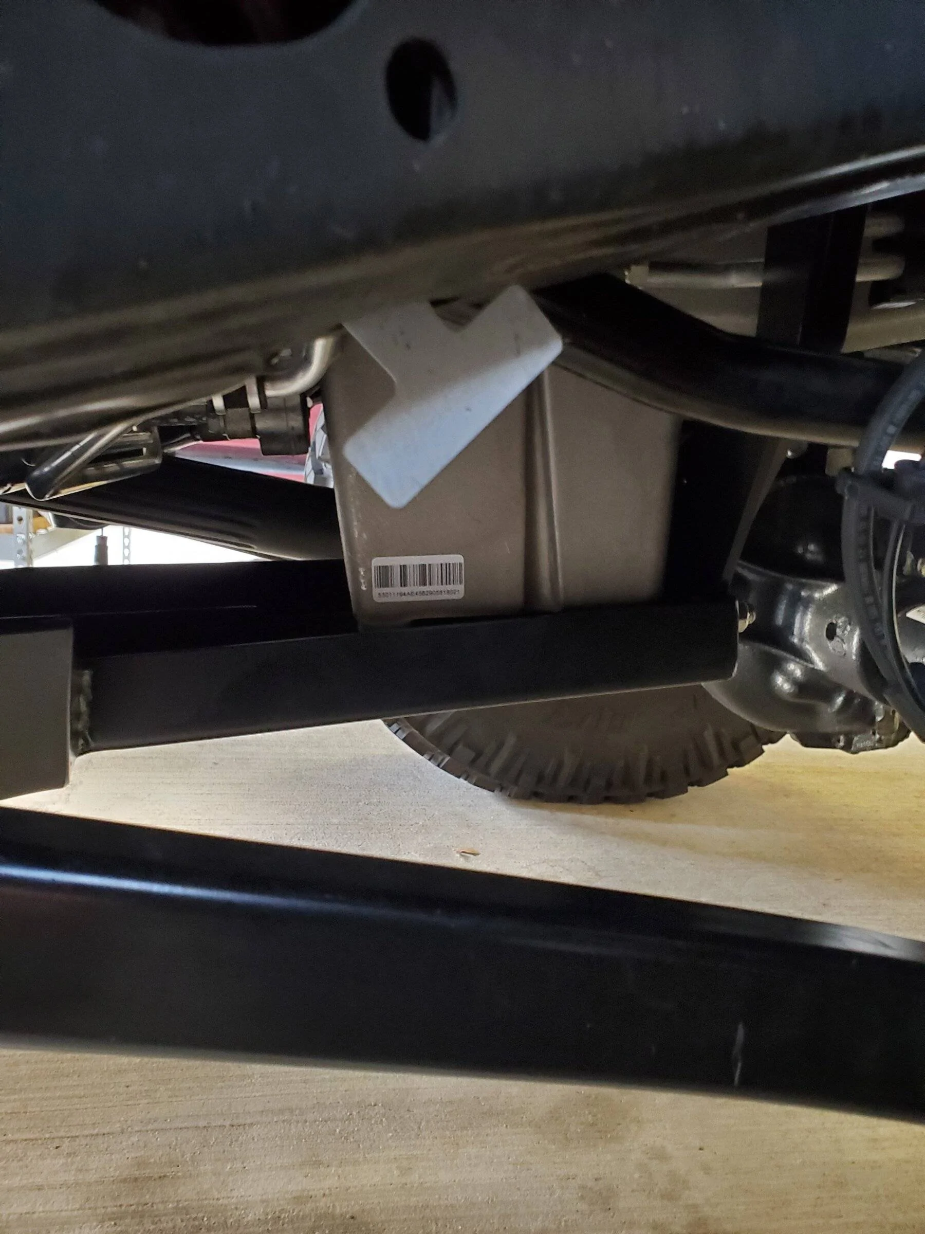

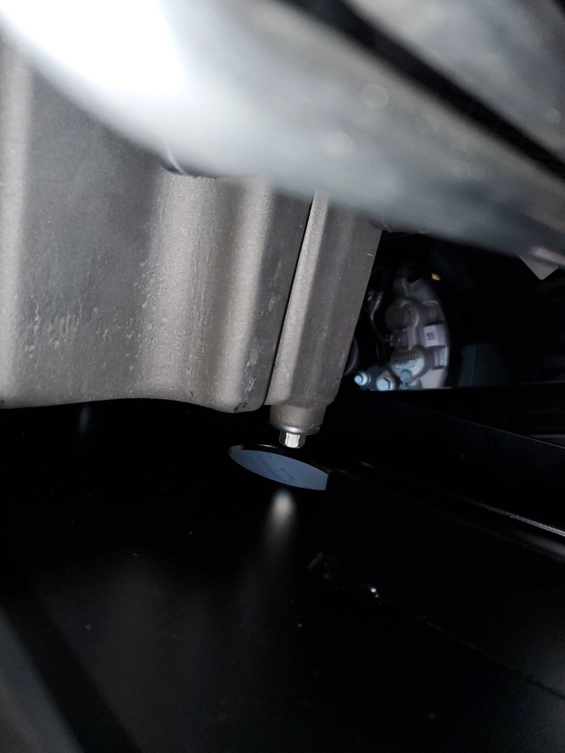

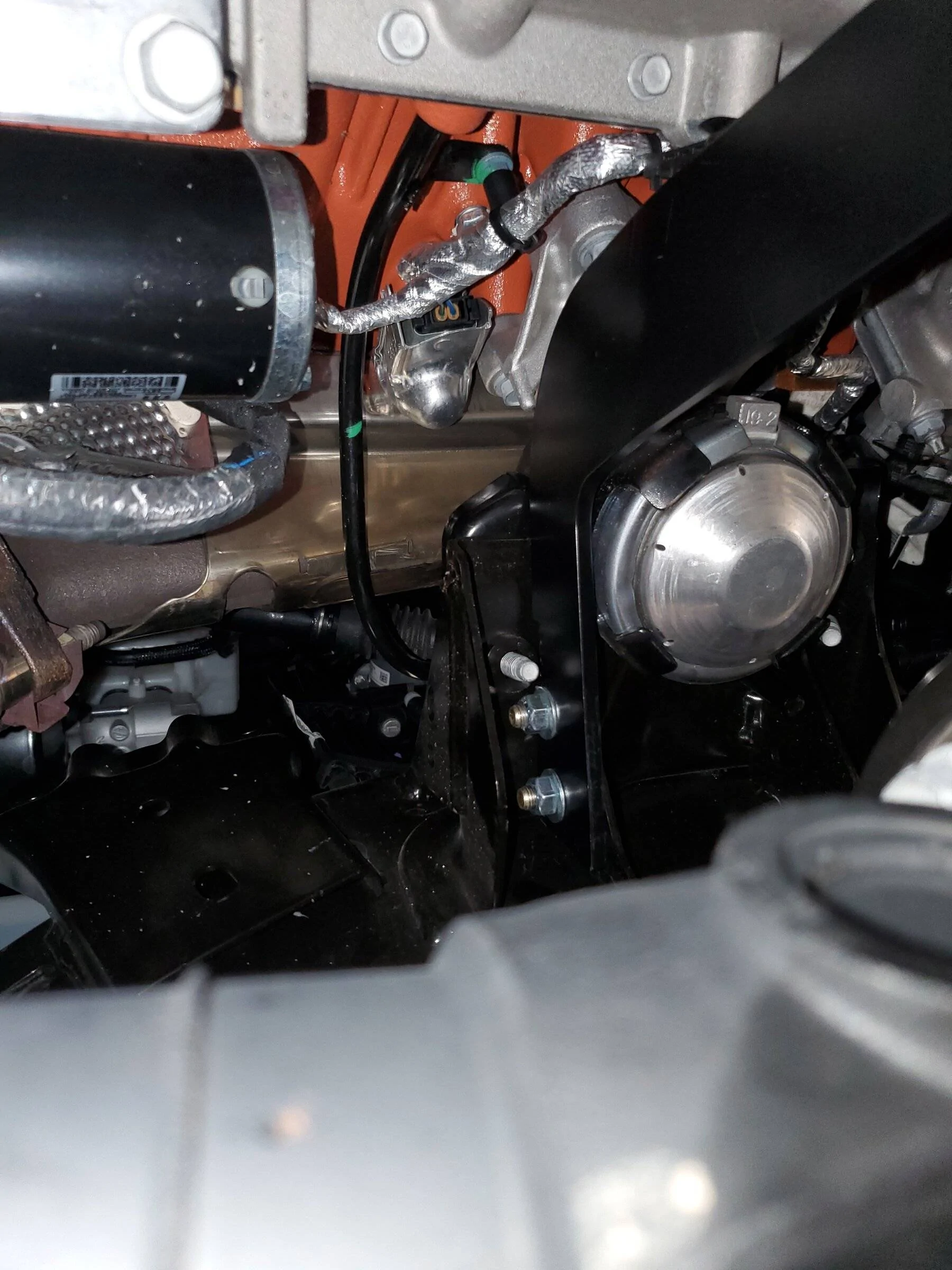

The engine cradle bolts were easy until my 14 mm ratchet wrench broke, then it was just slow going. The design is good and i think since it is one piece tying the frame rails together it will reduce frame twist, i was a little worried with any skid plate that the rotation of the engine on the engine mounts might contact the side of pan into the skid under load. I think the design will help against that. I can get about a finger and a half clearance all around the pan.

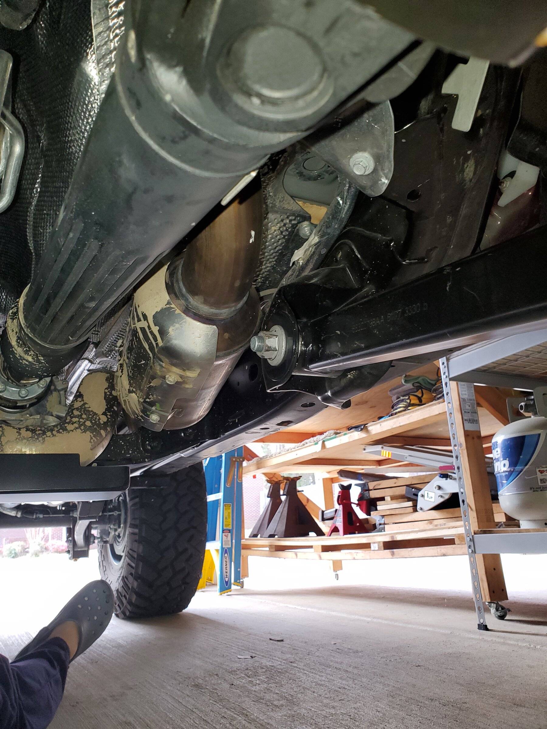

To my suprise the kit came with another piece to cover the drivers cat. I did not install it at this time,
Not sure if i ever will. No doubt it would provide maximum protection, but i dont really like how it mounts and if you need it you are already bad into the front driveline.....so leaving off for now.
