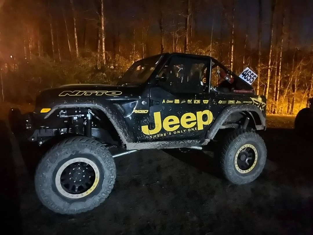

Been doing some research. Speaking with others that have had this issue. Specifically the people at Rock Krawler. They have experienced this “safety issue” as well. There’s no solution. It’s to prevent the transmission from being damaged if the Jeep is rolling backwards. This issue even caused them to roll over. Their “solution” is to start the obstacle with more speed. lol
Once the tires start slipping and the Jeep loses its forward momentum the Jeep stops and requires you to put it in park. Sometimes the engine shuts off as well. Good times! Thanks @JeepCares!
Jeep Wrangler JL 392 engine dies 2636326139188825697
