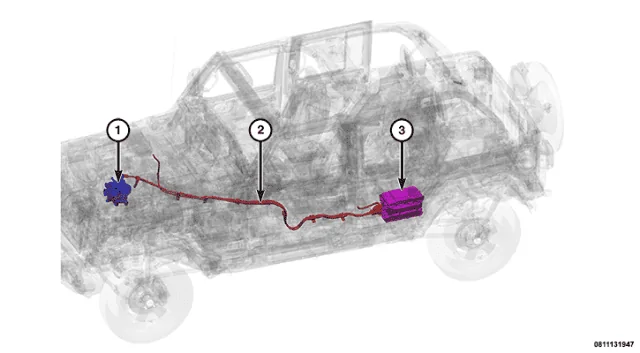

No one with etorque has actually looked under the fuse box to see if it’s just empty space or if they used the space to put something else related to eTorque, but as the poster after you said, we can guarantee you will not find a small auxiliary battery there, or the eTorque battery for that matter, because the eTorque Lithium battery is next to the gas tank on the drivers side and it has its own liquid cooling and skid plate.
Here is a schematic of where the battery is located, the battery being number 3, with #1 being the Motor/Generator Unit and #2 being the orange 48v positive and negative cables going between the PPU and the MGU:
Jeep Wrangler JL Thoughts on ETorque long-term? 1691B225-8534-4267-86E0-C98E49BB4C1A

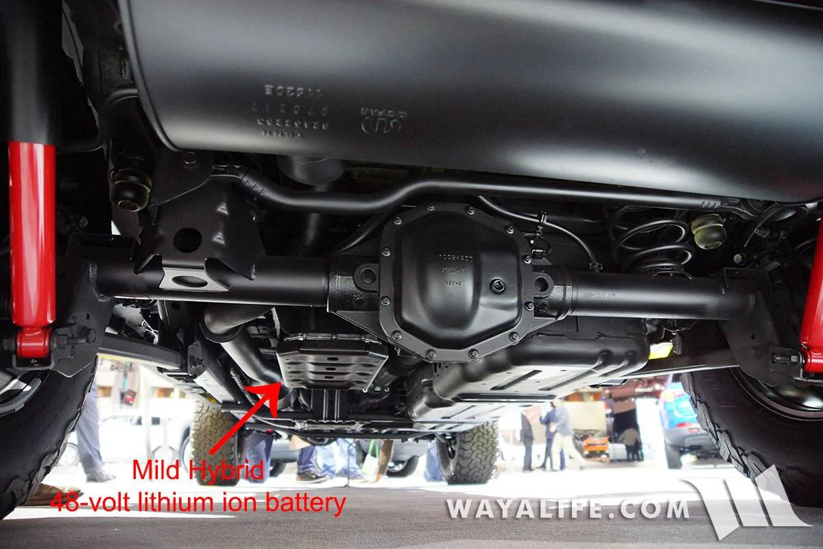

Here is a photo of it under the jeep:
Jeep Wrangler JL Thoughts on ETorque long-term? F3CC99E8-E93B-4801-B9AC-7F552CD0A73F

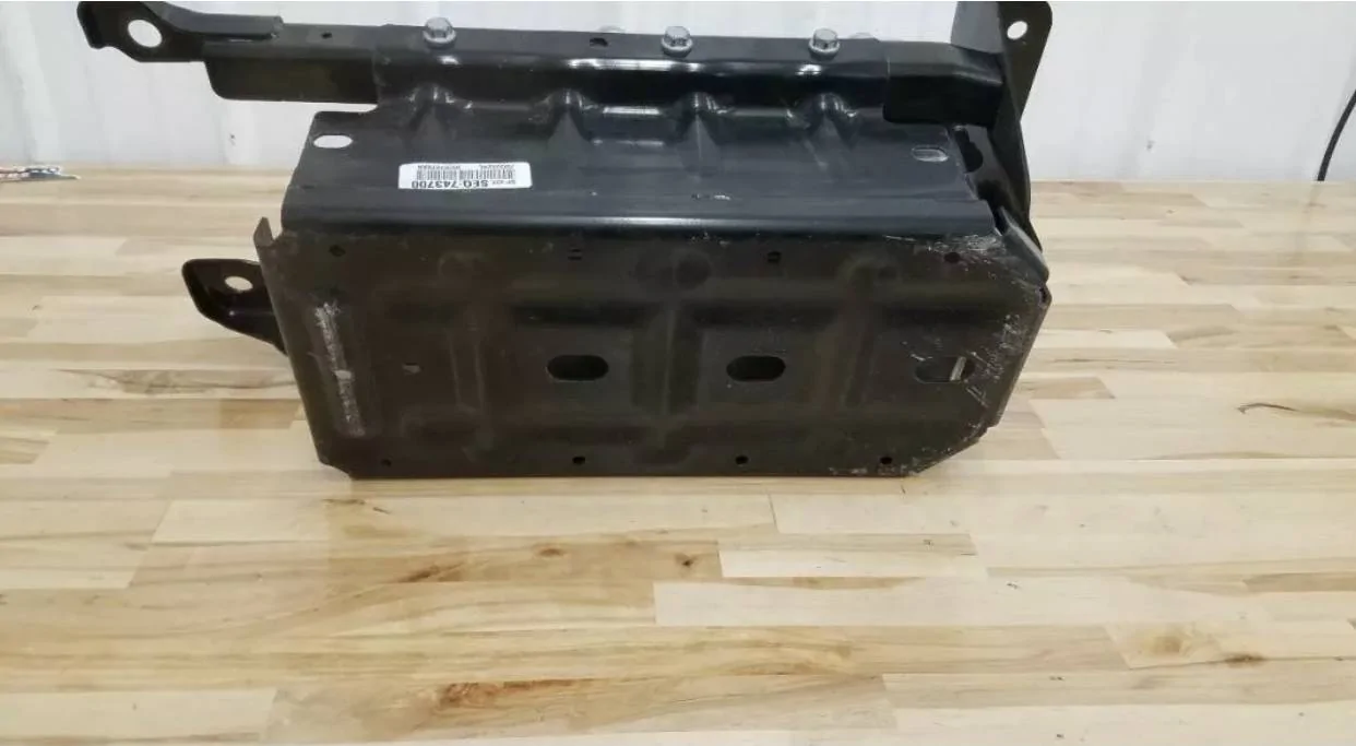

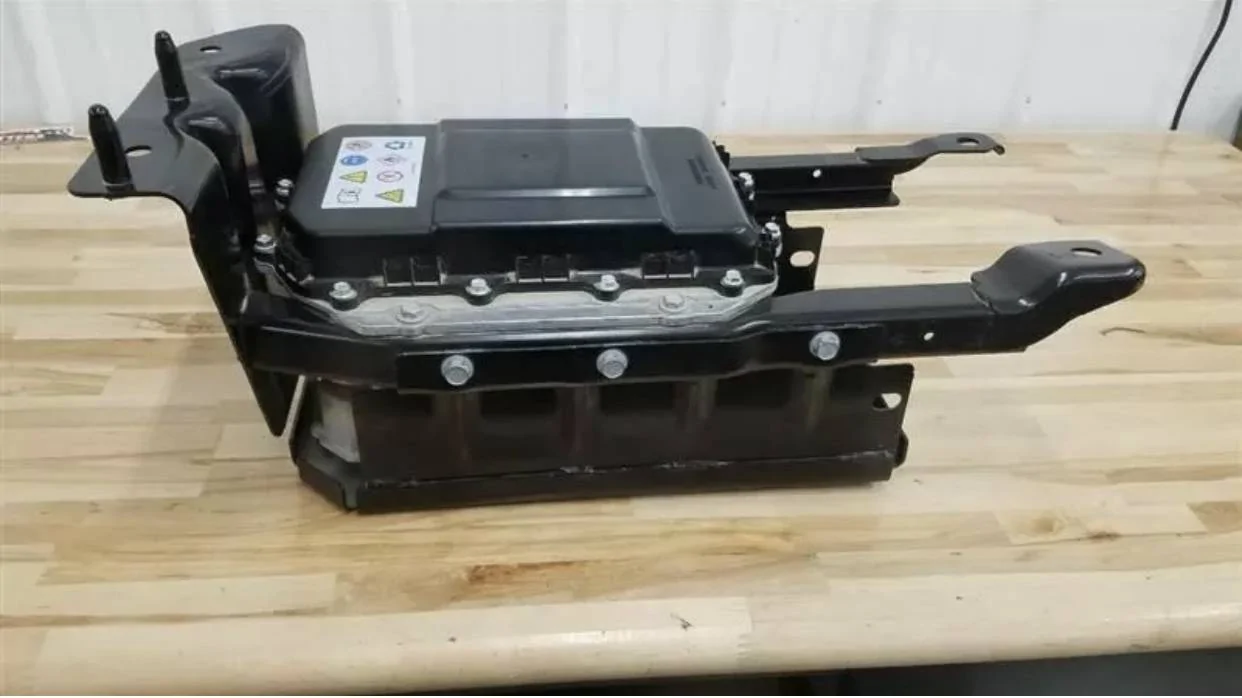

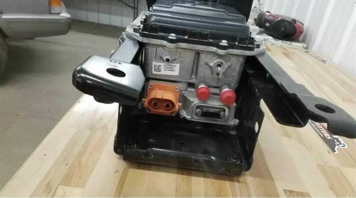

Here is the battery (called a Power Pack Unit) out of the Jeep:
Jeep Wrangler JL Thoughts on ETorque long-term? 6F5C56B6-3B73-4E50-BC84-D85ADD0972DB
Jeep Wrangler JL Thoughts on ETorque long-term? 76C5D24A-CC84-4395-B685-85175E4B6CA4
Jeep Wrangler JL Thoughts on ETorque long-term? A9F054CF-3F79-4DA8-BC4F-680A59DCE8AB
The PPU includes a 3kW DC to DC converter used to power all accessories during a Start/Stop event and to charge the conventional Lead Acid battery whenever the engine is running.

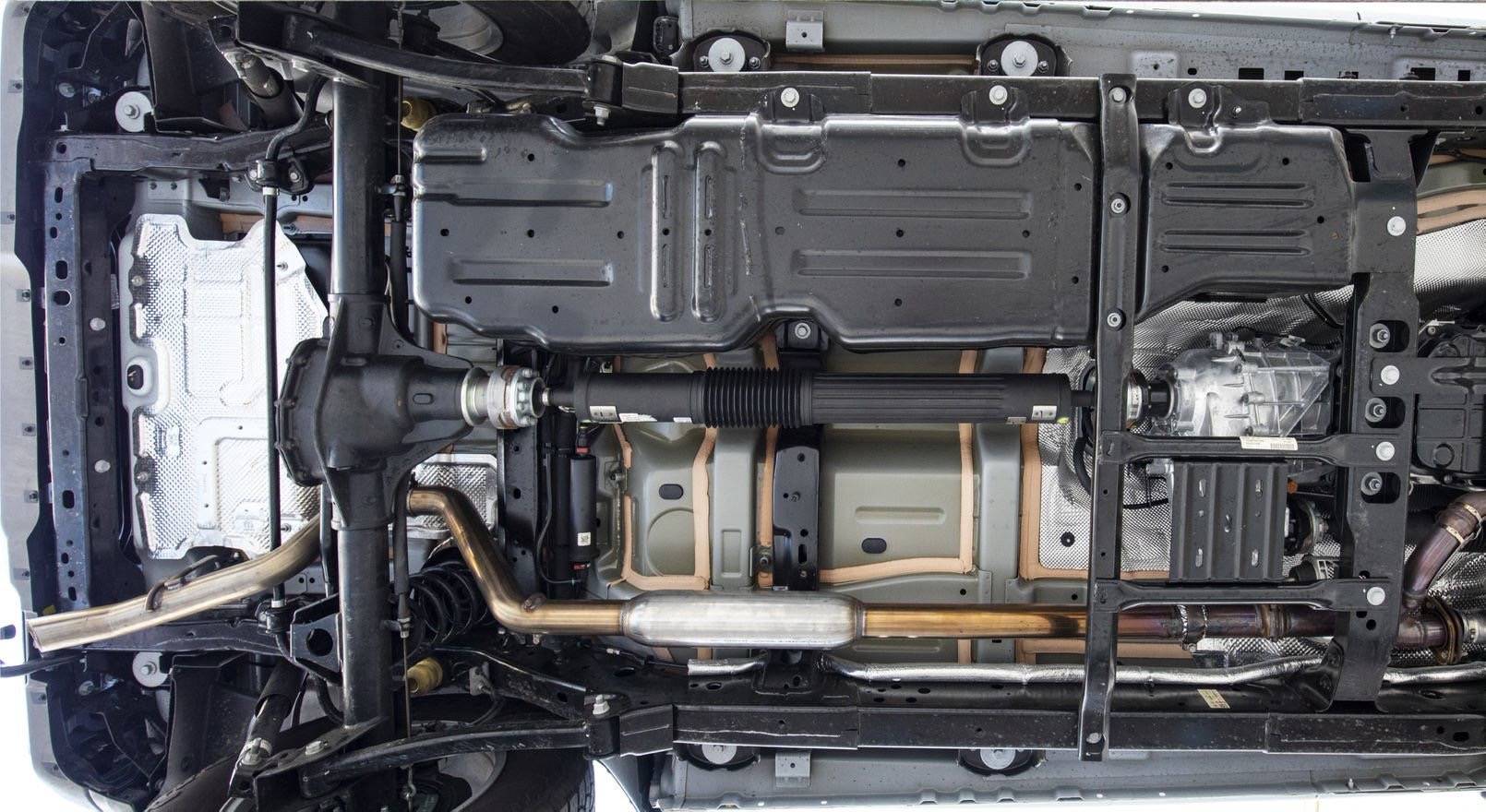

And finally, here is a photo of the undercarriage of a Jeep without eTorque, where you can see the empty space beside the gas tank where Jeep engineers chose to place the PPU on eTorque Jeeps:
Jeep Wrangler JL Thoughts on ETorque long-term? 81131AD3-6832-407D-BFF6-0AFC072D64D9
