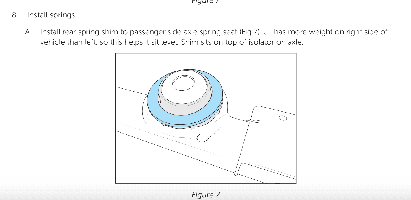

AEV lifts come with shims for the passenger side springs.
