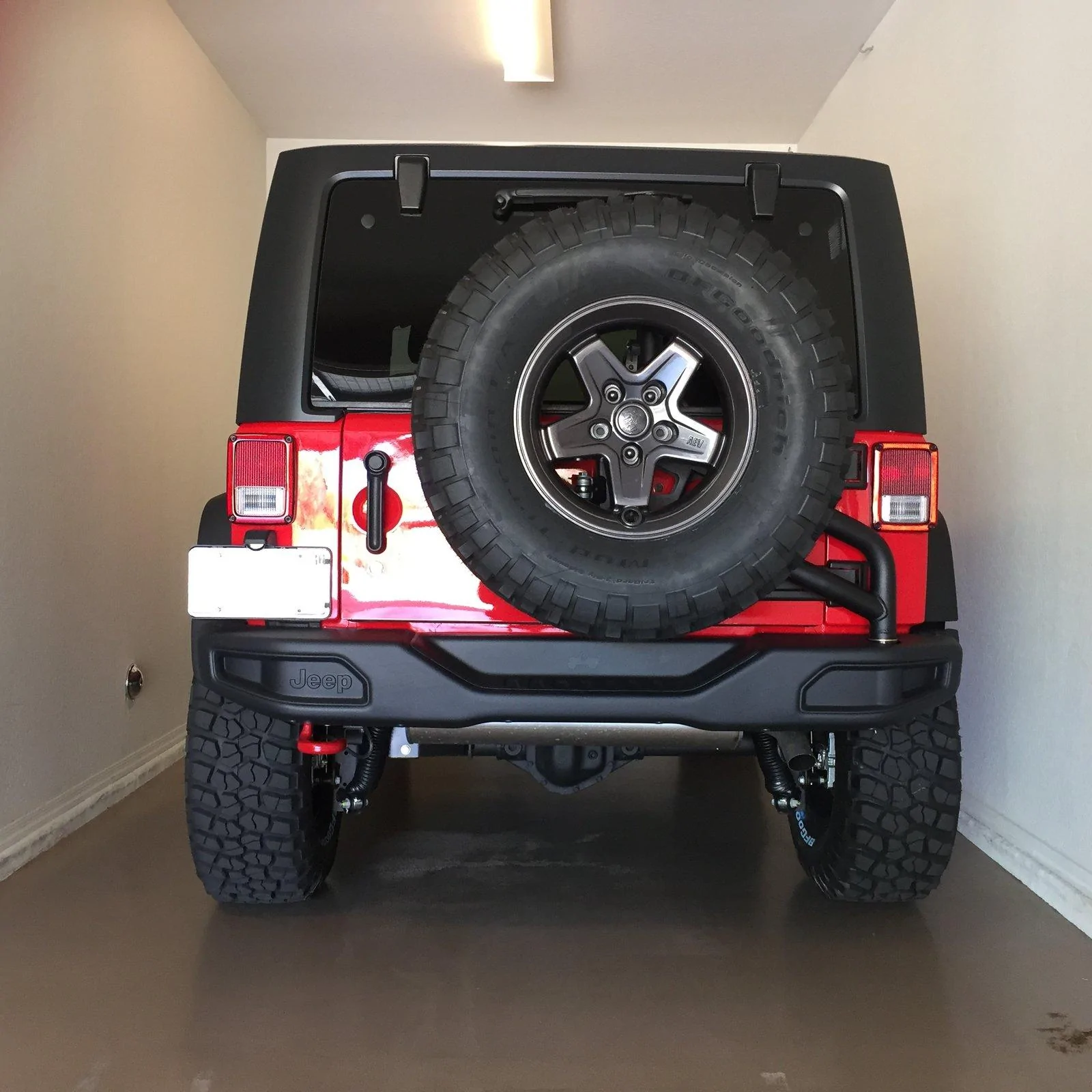

I'm selectively OCD. On my previous two Jeeps I ran the AEV tire carrier and, for some reason, the off-center spare didn't bother me. I still scratch my head as to why not.
Dude.......why would you show me that :whatsgoingon:
......:facepalm:.........is that for real ? .......:)
