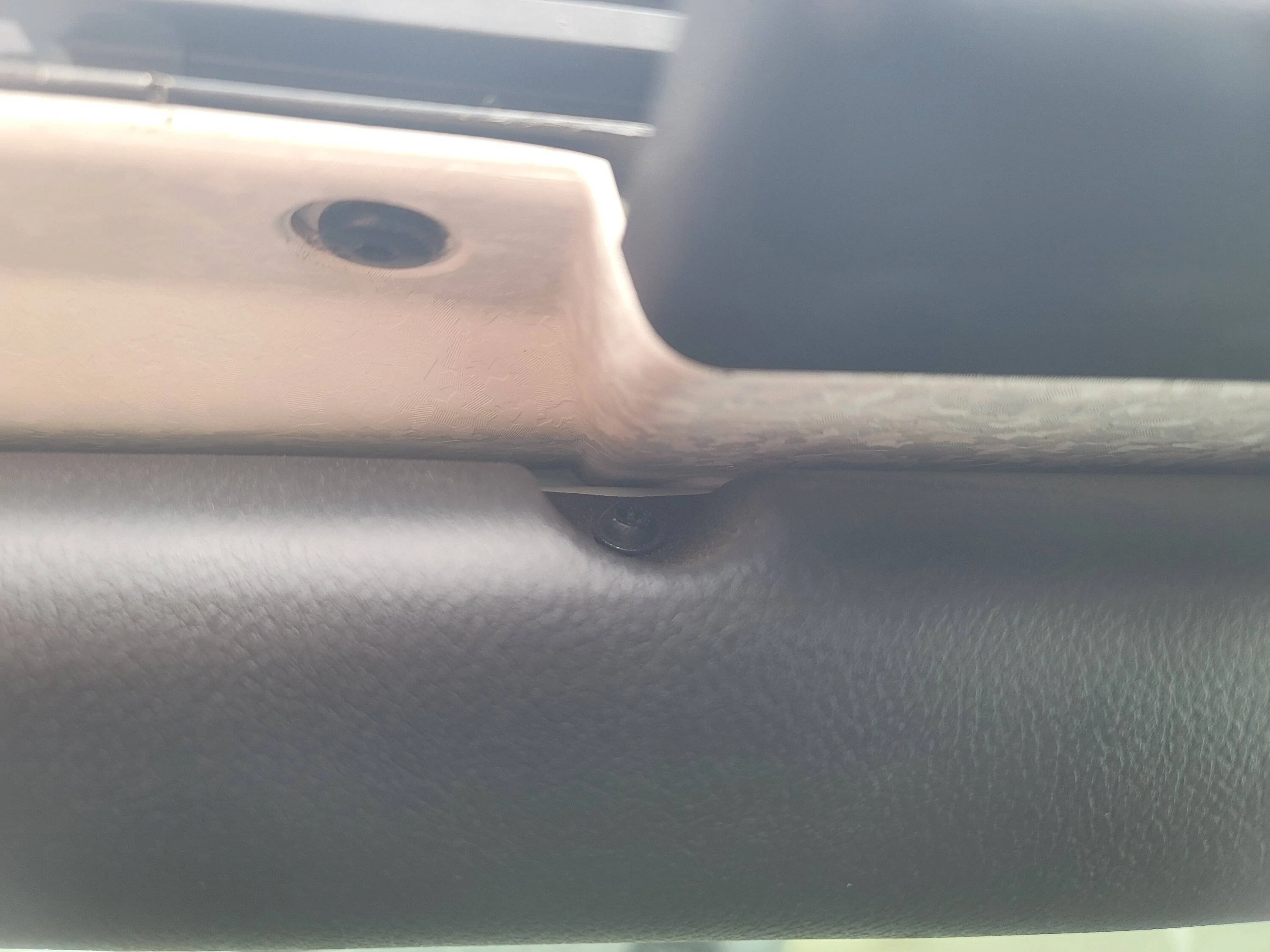

Just installed the single TACCOM clips on my visors as a preventative measure, and it reminded me of another odd issue I'm experiencing with the visor design.
Although the two screws holding the visor into the rectangular-ish plastic base (photo below) are tight, the whole thing is wobbly and loose. Frankly, I was never that concerned about the visor breaking off, because the base is so much looser and flimsy. Same goes for the clip that holds the other end of the visor in place. I thought about removing both assemblies to figure out what's going on, but then I thought it might just make things worse. Before I decide to do any exploratory surgery, does anyone else have this issue too? Is it easily repairable or is this just another damn "Jeep Thing" we have to live with? Appreciate any recommendations and happy Jeepin' all!
