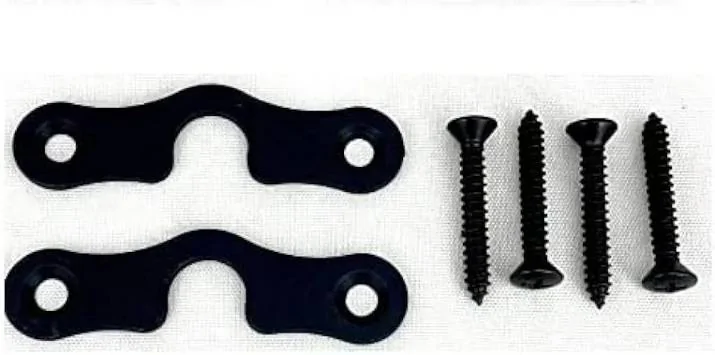

No need to go that route any more as $7.50 will get you a permanent fix for both visors:
The Original TACCOM Compatible Heavy Duty Aluminum Sun Visor Clips(2) for Jeep 2018 and Newer JK, JL, JT Gladiator and Wrangler https://a.co/d/0nOkfdL

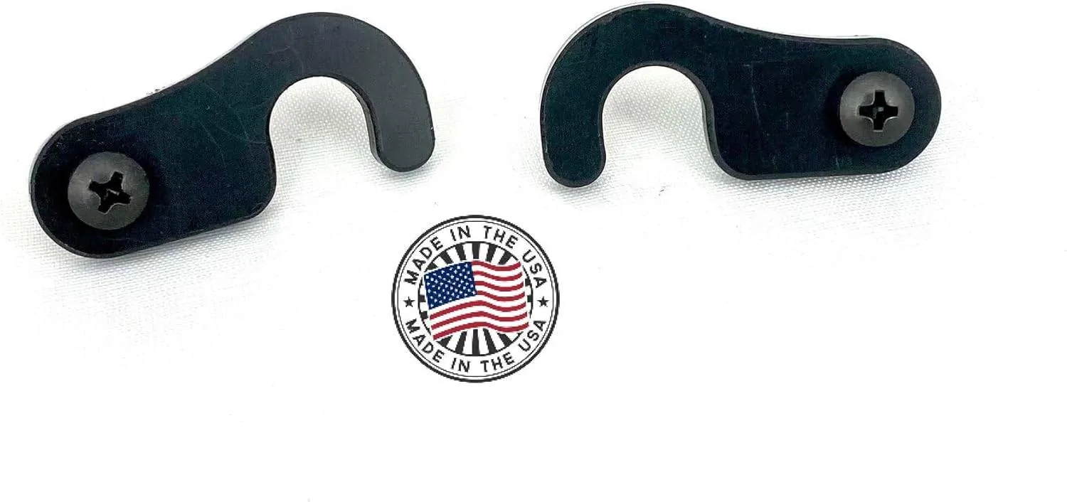

Go with the original " Taccom" offering and not with one of the many knockoffs.
Since your visors are presently aok, go with the single Taccom. Buy here. They are selling for 70% off right now!

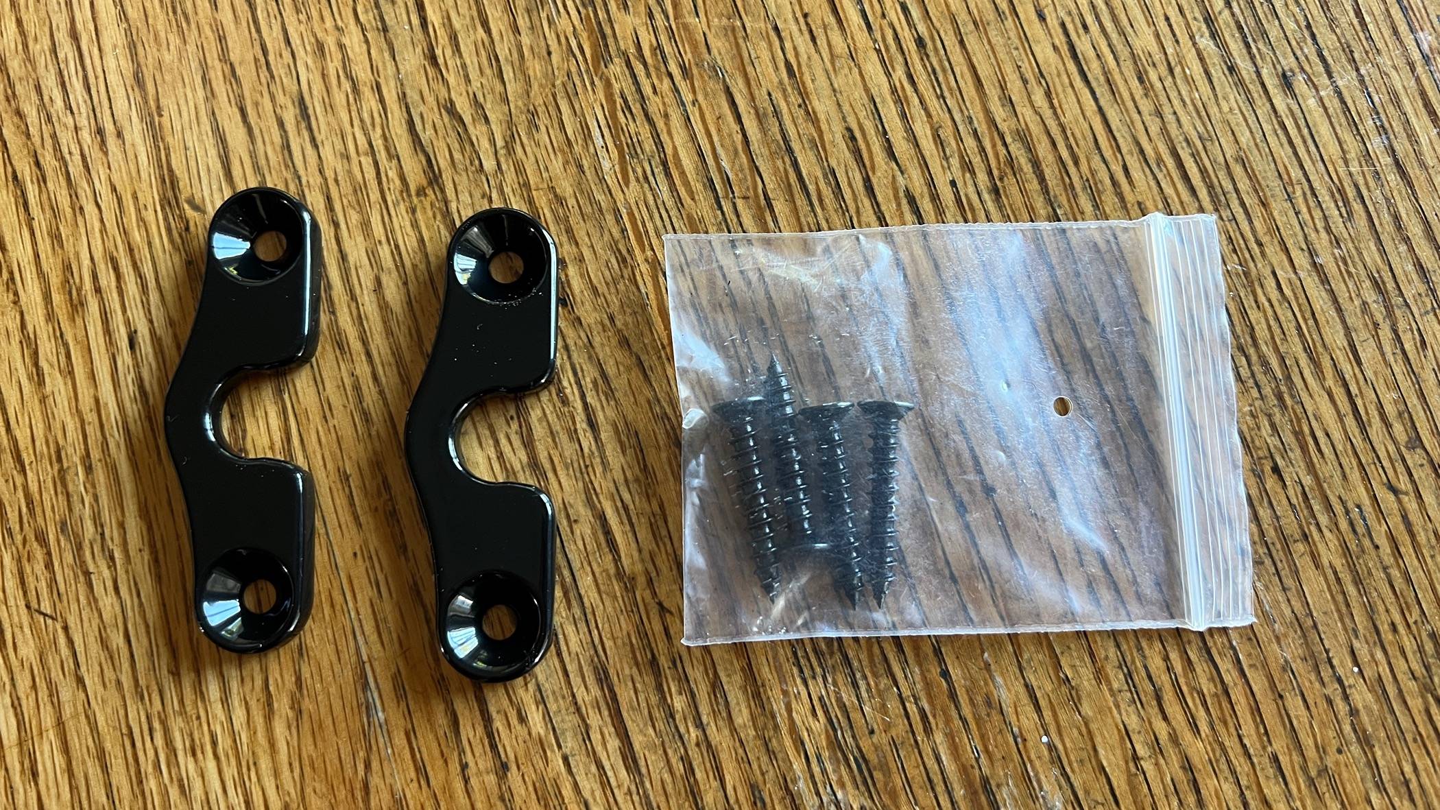

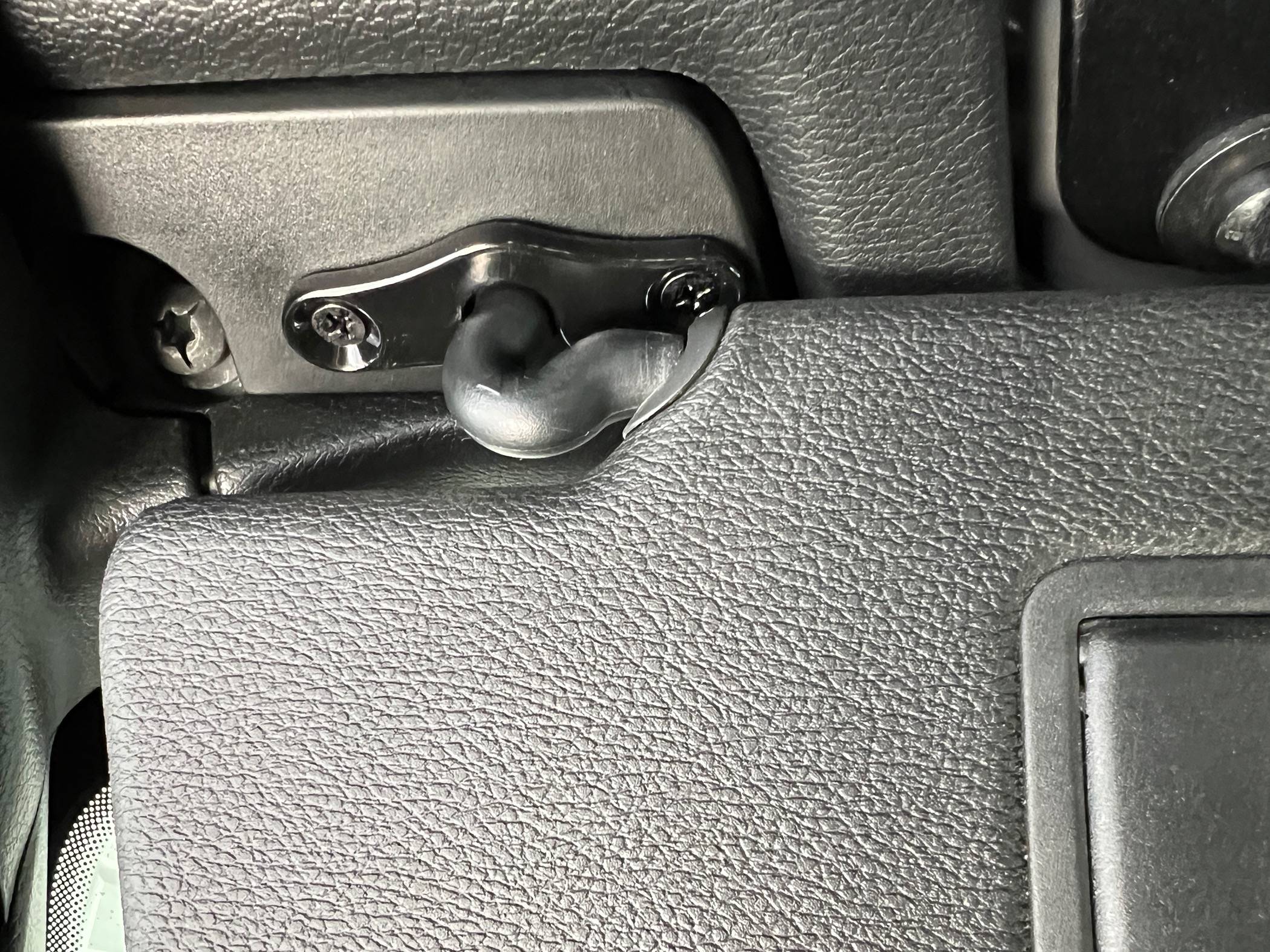

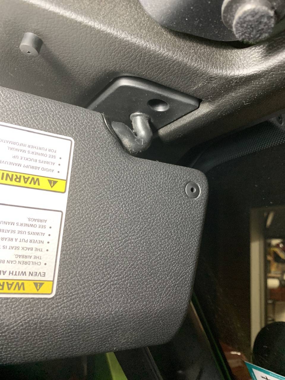

2021 JLUR. 48,000 miles. Many overland/off road miles. Drivers side visor broke exactly as described traversing gravel road in NM. Just broke and dropped down hanging by the electric wires that support the garage door opener etc. I was able to push it back into place where it "usually" remained if I did not use it. Read this thread. Saw that the originator of the fix endorsed the TACCOM solution, I ordered it for $10. Free shipping. Received it in two days. So simple to install there were no instruction. T25 torx to remove original screws and phillips head for longer replacement screws. 15 min to install. Done.
Thanks to @roaniecowpony for taking the time to develop and post his solution then endorse a simpler effective fix.

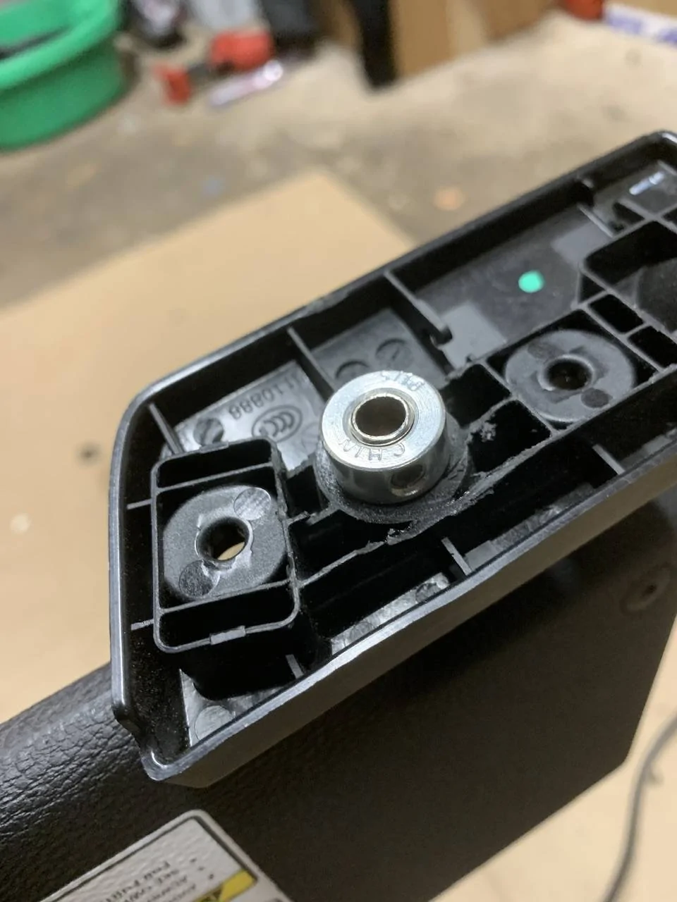

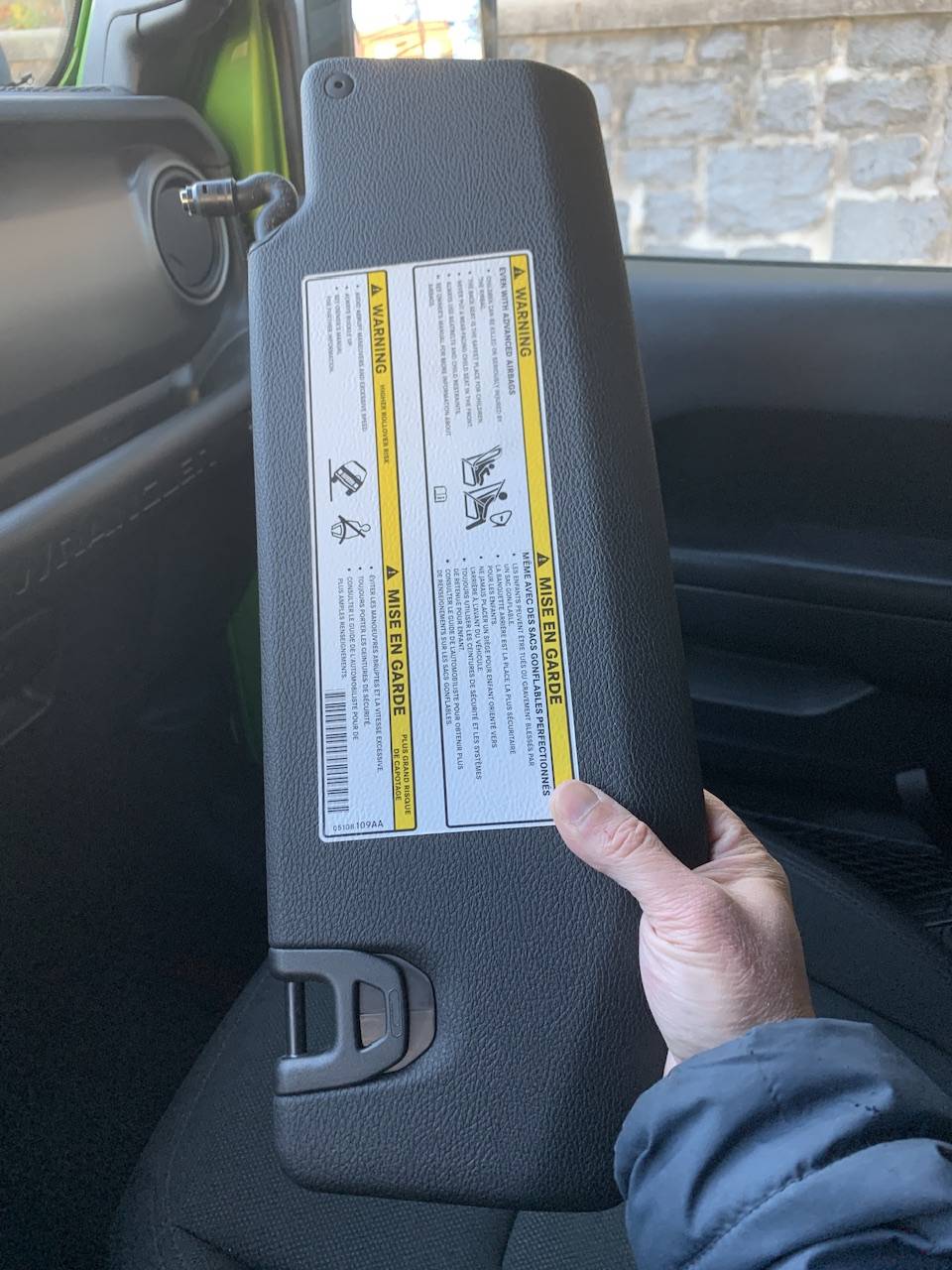

I did my repair just over a year ago, and it's all good. Have another collar waiting in my center console in case another one falls out of mine or my wife's.
I made the above post almost exactly three years ago. I got to use the spare collar today.
Jeep Wrangler JL Sun Visor Fix IMG_7762
Jeep Wrangler JL Sun Visor Fix IMG_7767
Jeep Wrangler JL Sun Visor Fix IMG_7768
The driver side fell on my today on my way to work, so I fixed it after I got home. Only took a few minutes with the Dremel. I’m honestly surprised it made it almost 5 years, considering the passenger side broke after a year. FWIW, that one is still holding up perfectly after 4+ years now.
