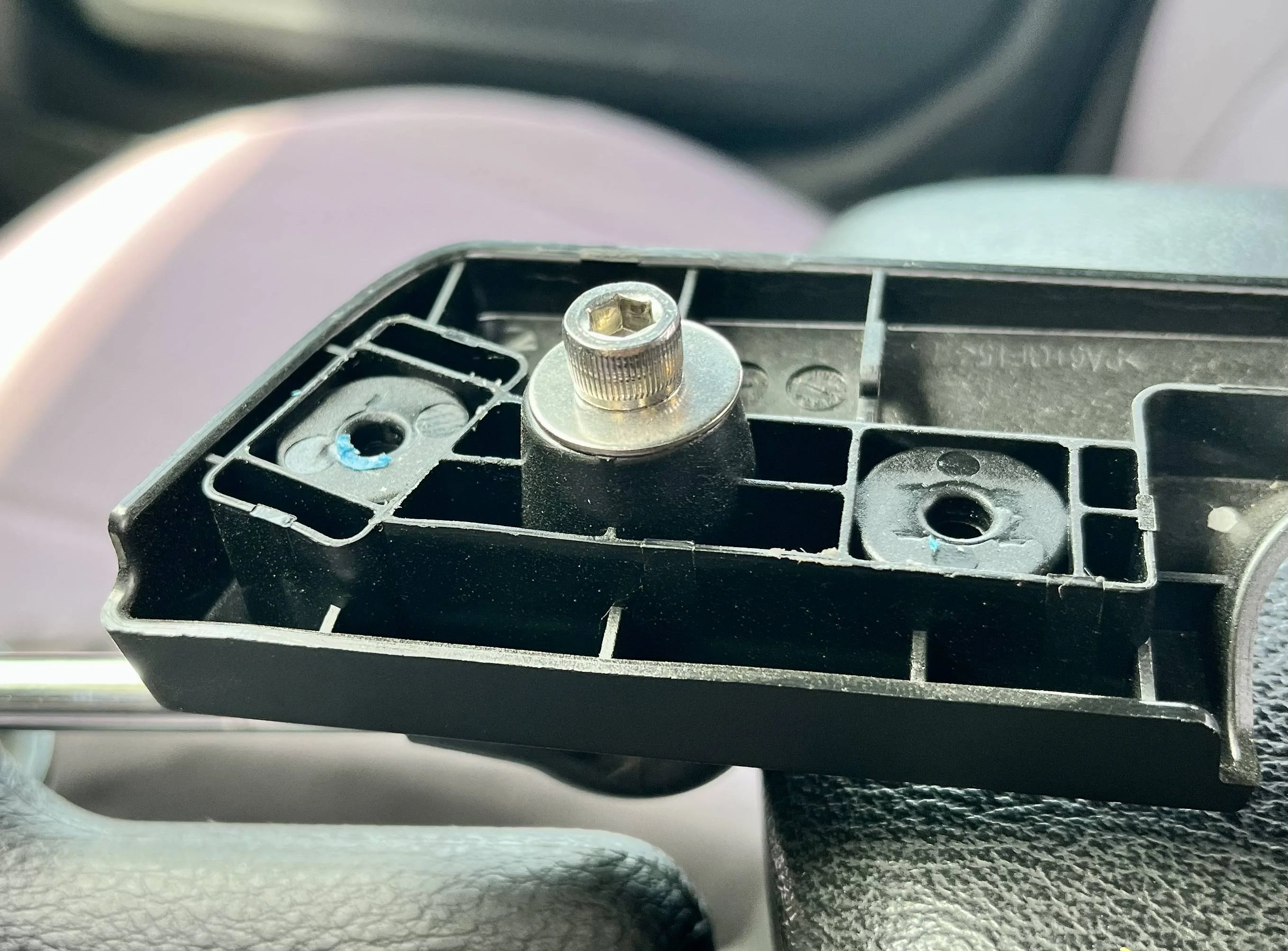

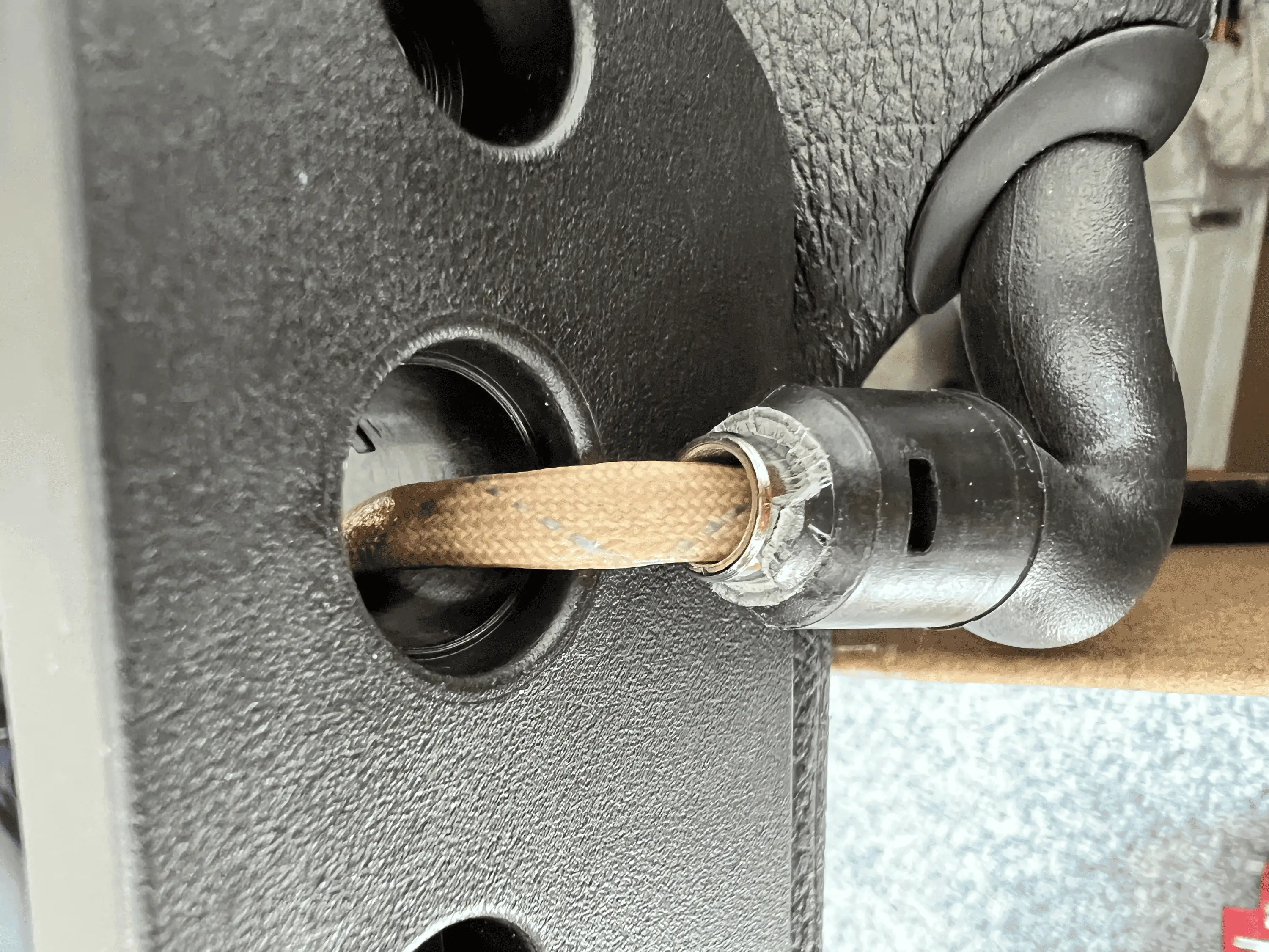

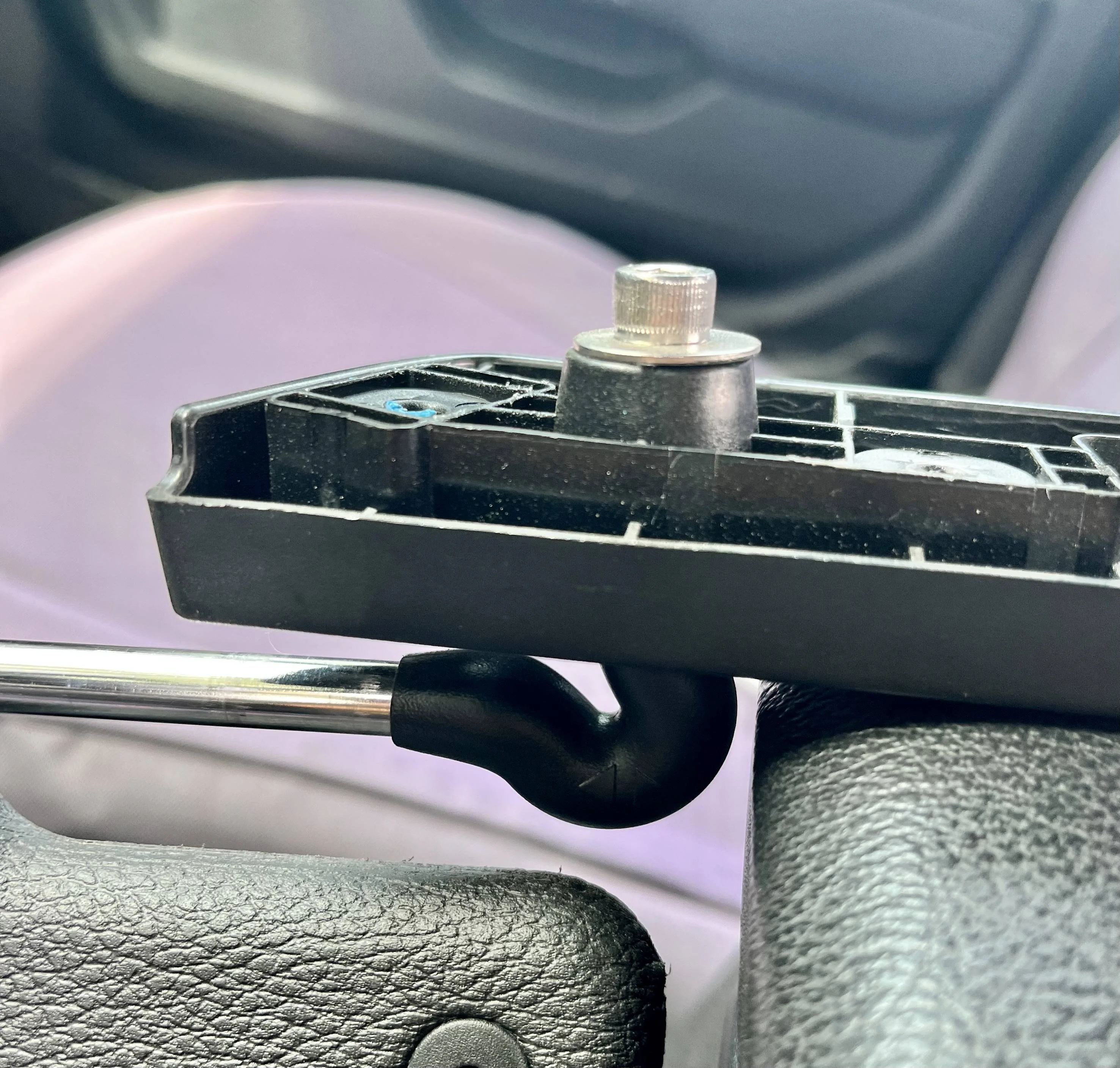

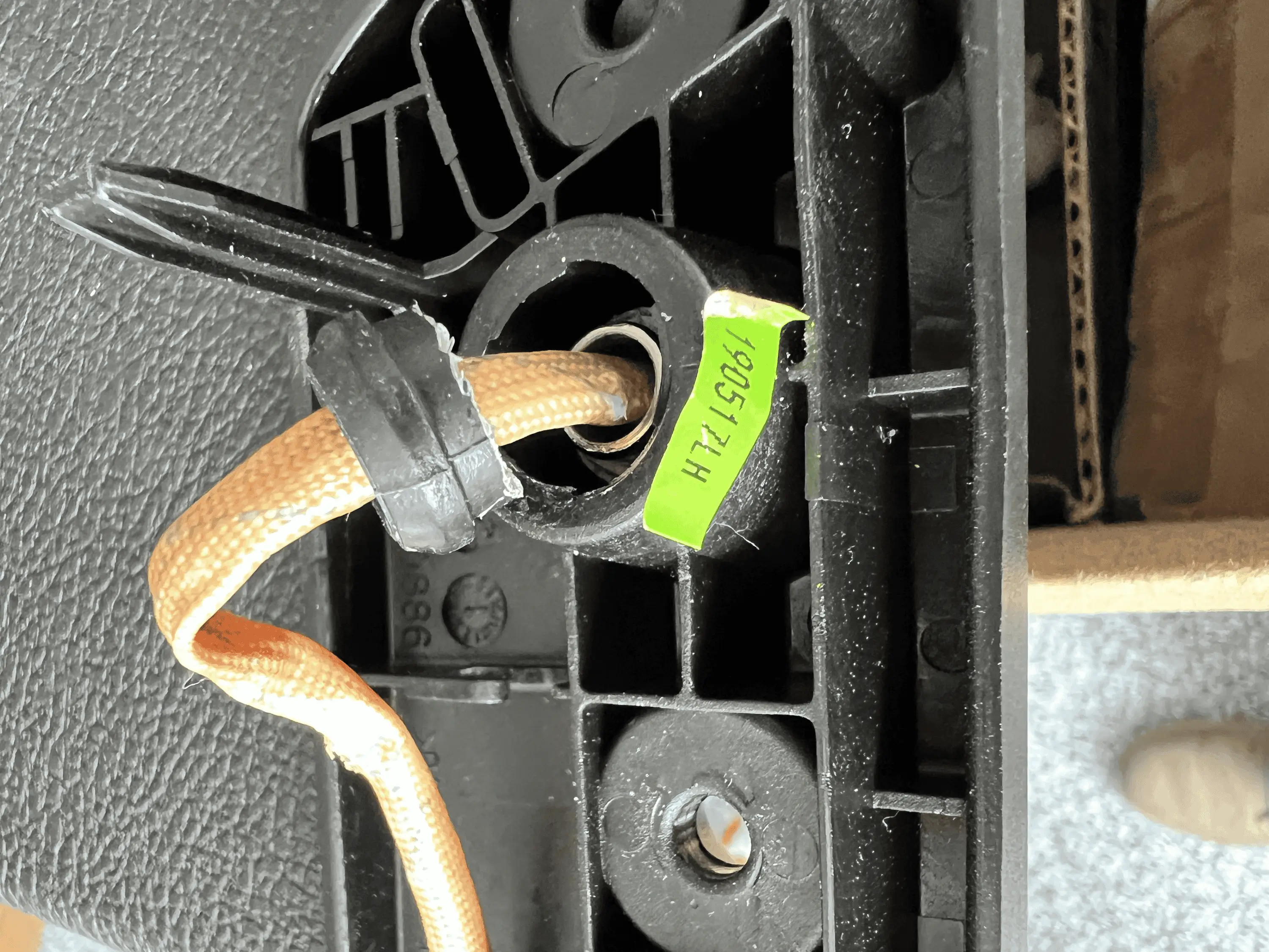

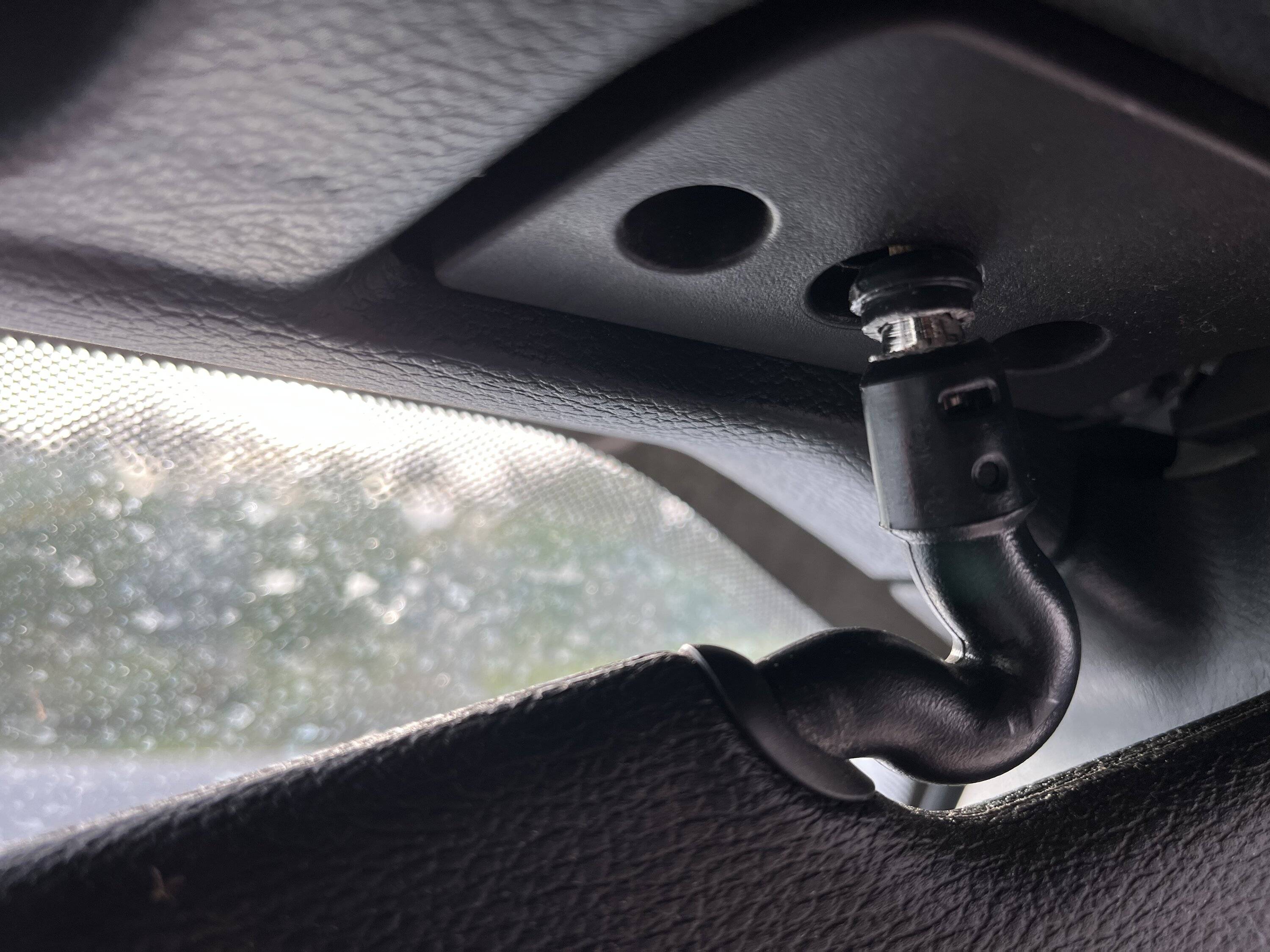

I don’t have very steady hands so the retaining ring wouldn’t work for me. So I threaded it. With the plastic broken off of the end of the bendy piece, a 1/4-28 tap will make enough internal threads to hold a bolt. Then a bolt with a washer to hold it to the plastic piece that the bendy metal piece goes through. The driver side was already broken, so I went ahead and did the passenger side, too.
Sorry for all the technical terms

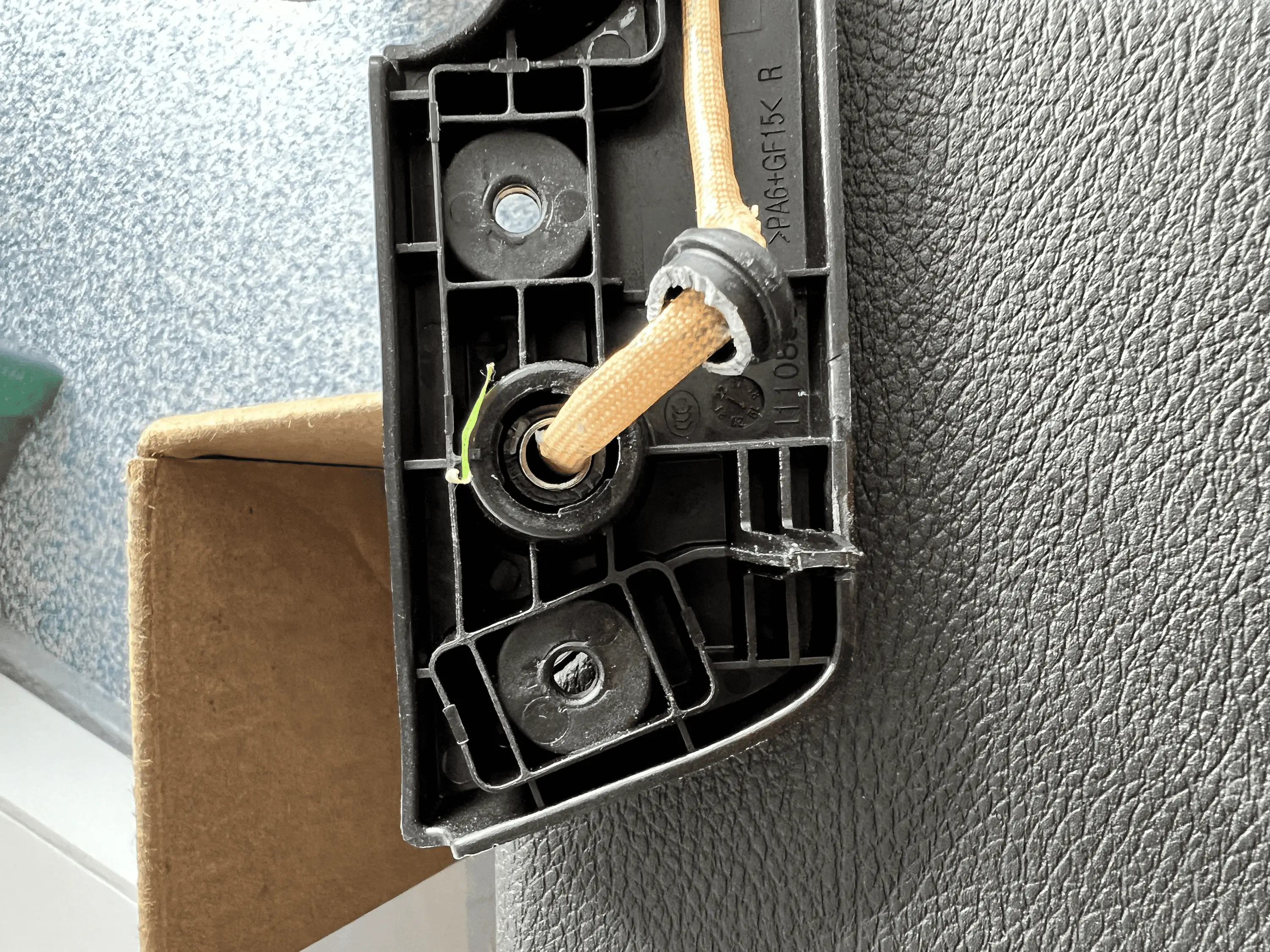

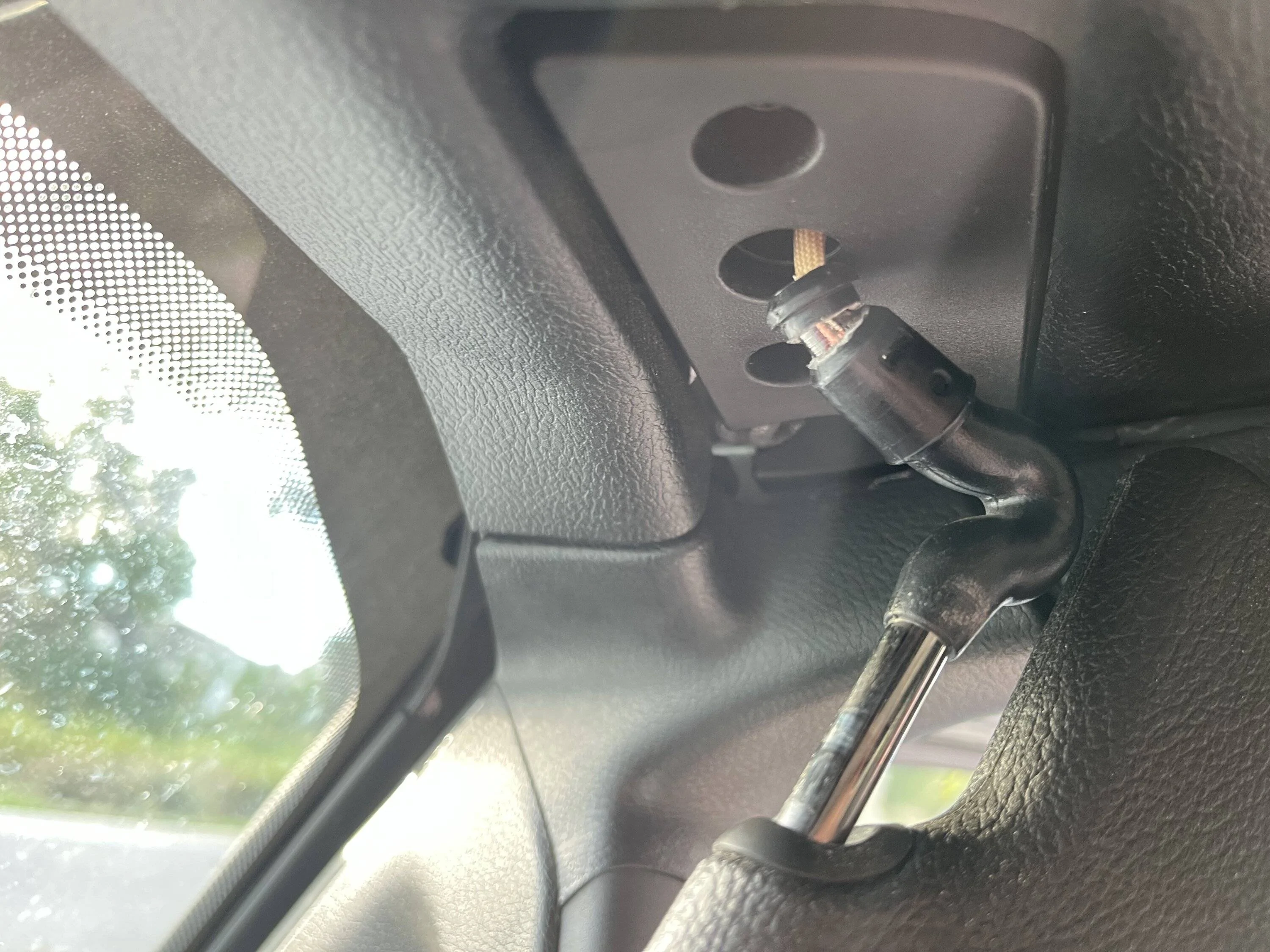

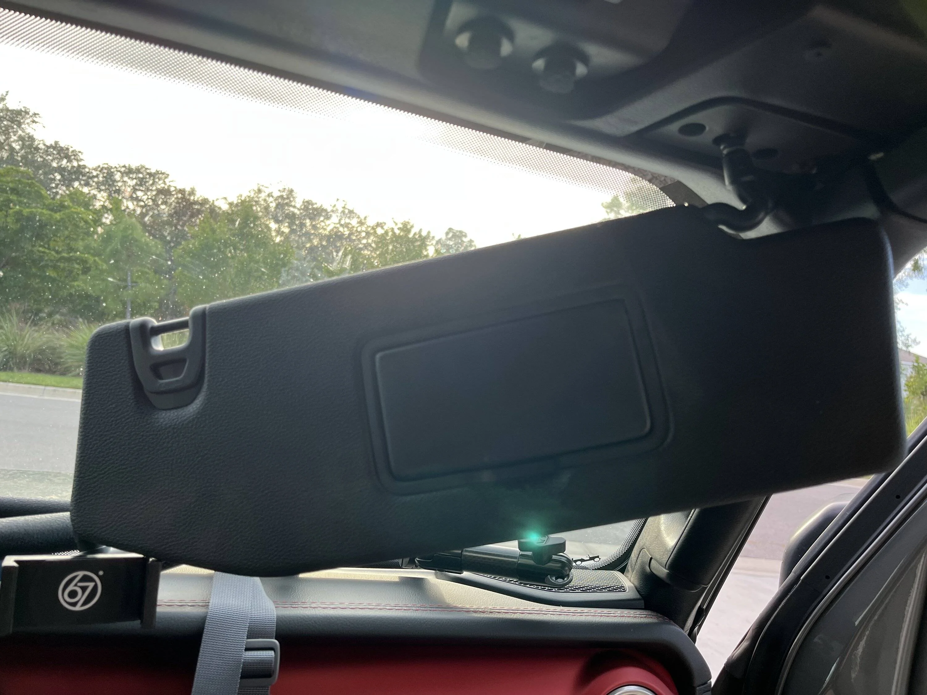

So would this address the issue I am having? —> The plastic arm holding my visor seems to be cracked apart. (Pictured)
Yes, I used the 2pc collar w/ mine, there's several ways to fix this along w/ that bracket support (in the post right above mine) that will fix this pathetic design flaw.

@Greywolf
No need to replace visor / that cracked/broken piece..
Aftermarket clips will repair that. That is all you need and it takes less then 5 min. to do the install of the clips.. Just push up/back in firmly... hold all in place an install the clip with the 2 provided Taccom screws, not the stock screws you removed..
Suggest you go with .... The Original TACCOM double offering.. If your visor was not broken I would say go with the single Taccom offering.
I myself, would not buy the crapola knockoff offerings.. Do go with the Taccom offering like many/most here have gone with.
More often then not the knockoff offerings fit bad, made of poor material, off coloring..
https://www.amazon.com/TACCOM-Compatible-Gladiator-Wrangler-Patent-Pending/dp/B09NF8DKLK/ref=sr_1_2?crid=31ACA20BS7927&keywords=taccom&qid=1699221879&sprefix=tacc,aps,89&sr=8-2
