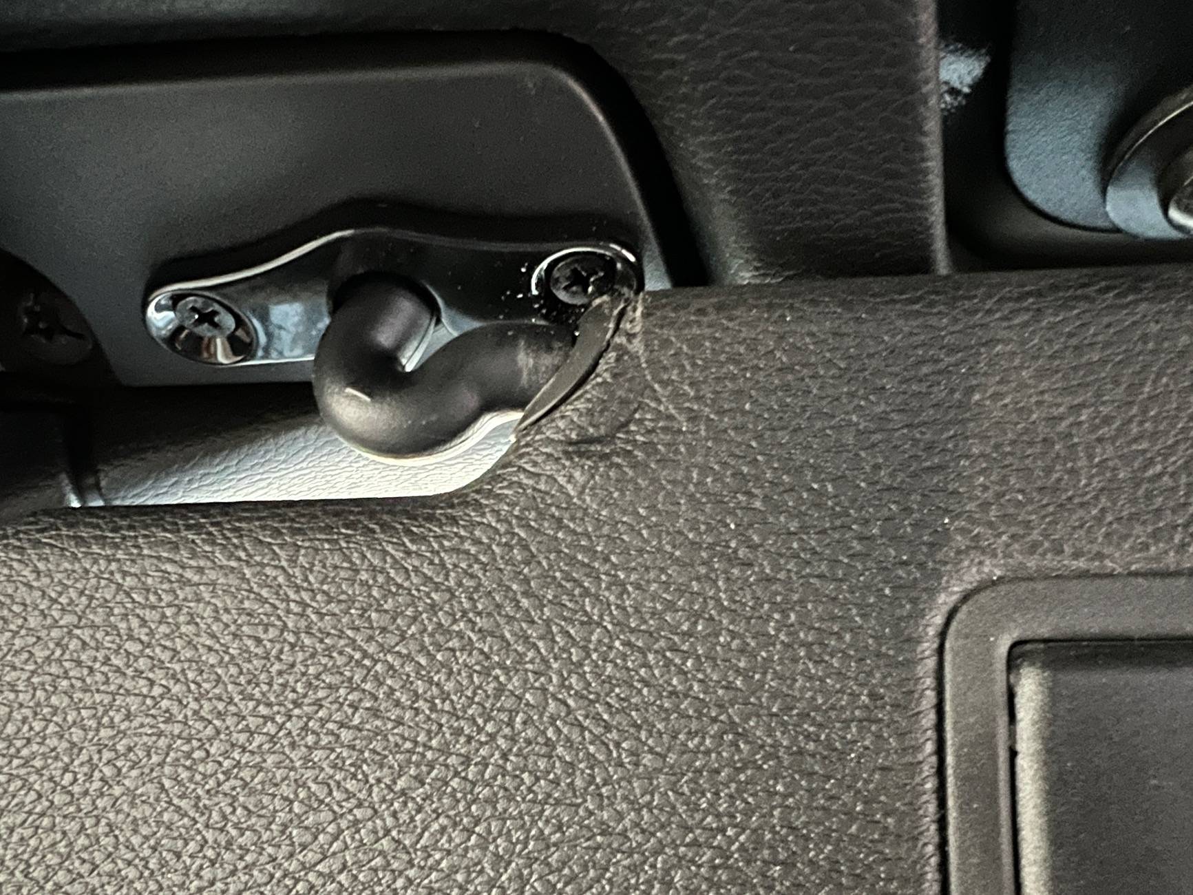

2021 JLUR. 48,000 miles. Many overland/off road miles. Drivers side visor broke exactly as described traversing gravel road in NM. Just broke and dropped down hanging by the electric wires that support the garage door opener etc. I was able to push it back into place where it "usually" remained if I did not use it. Read this thread. Saw that the originator of the fix endorsed the TACCOM solution, I ordered it for $10. Free shipping. Received it in two days. So simple to install there were no instruction. T25 torx to remove original screws and phillips head for longer replacement screws. 15 min to install. Done.

I have seen this tacoma version and the hook version. does yours have trouble rubbing and wearing the visor? ( I bought both options , and the parts to do @roaniecowpony 's version - both my visors are broken, driver side dangles in my face at all times and Is currently tied up with trick line)
just wondering if I should go 2 hole version as you did, or hook version? considering the wear and tear mentioned on page 30?

I've had zero rubbing with the TACCOM 2 screw version after more then a year of use
Zero wear.

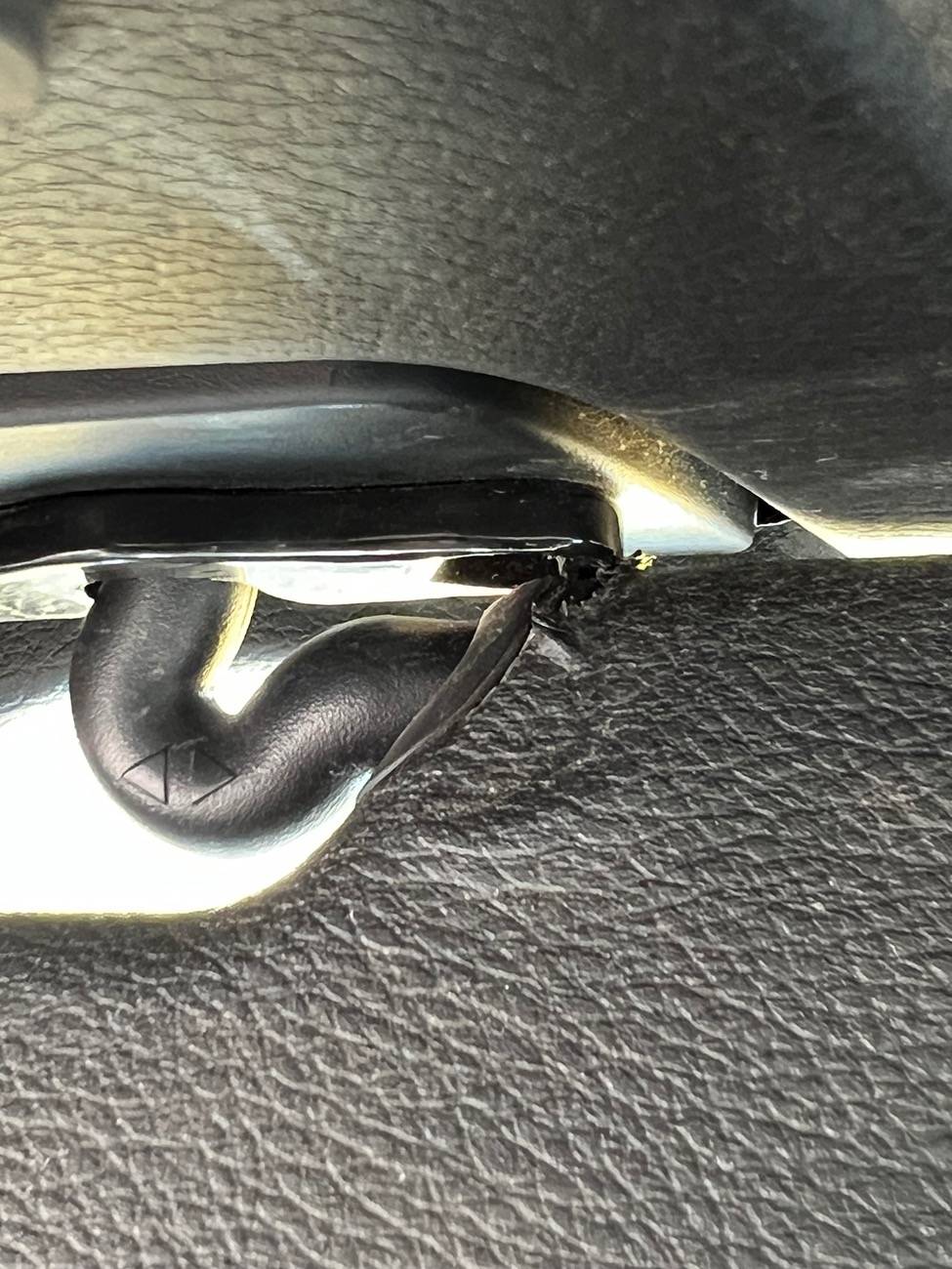

I replied too soon. I went out and checked. There is some wear. 😳

k but terrible. I ordered both versions so I'll see how they fit. the 2 screw does appear more sturdy, even if it rubs a bit
