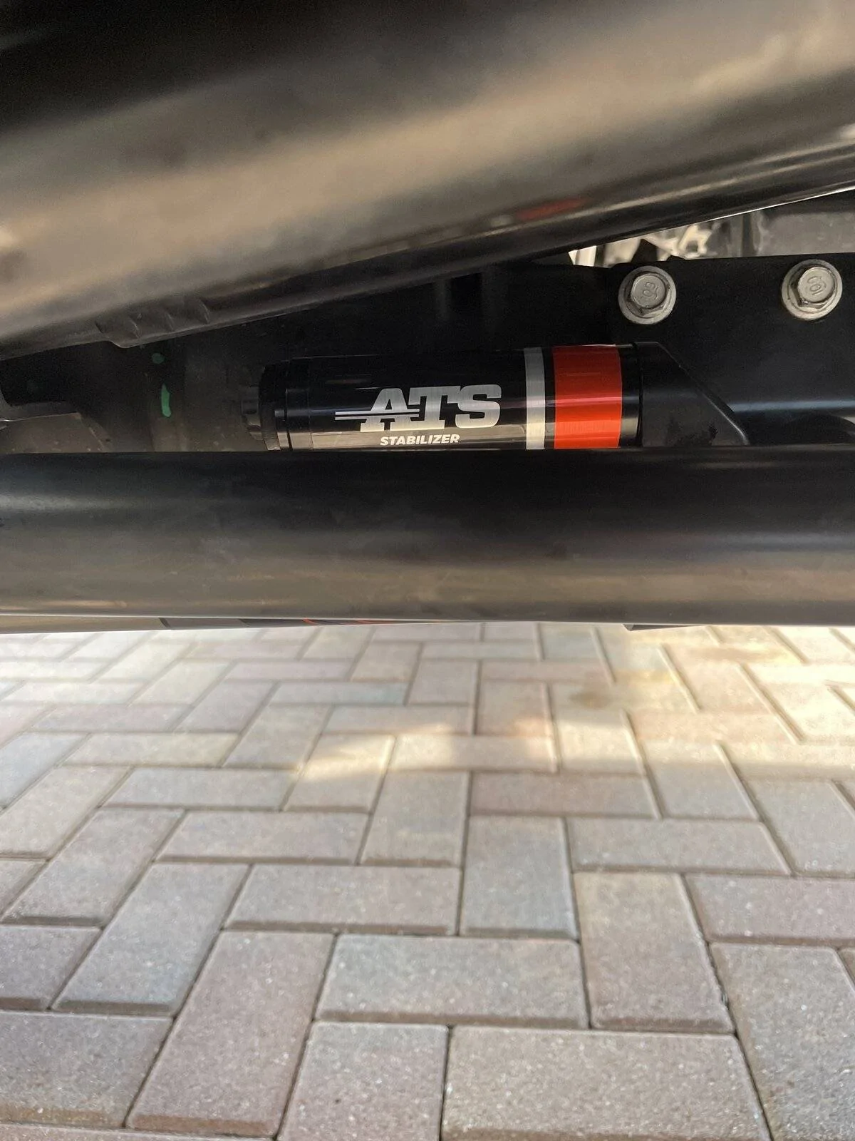

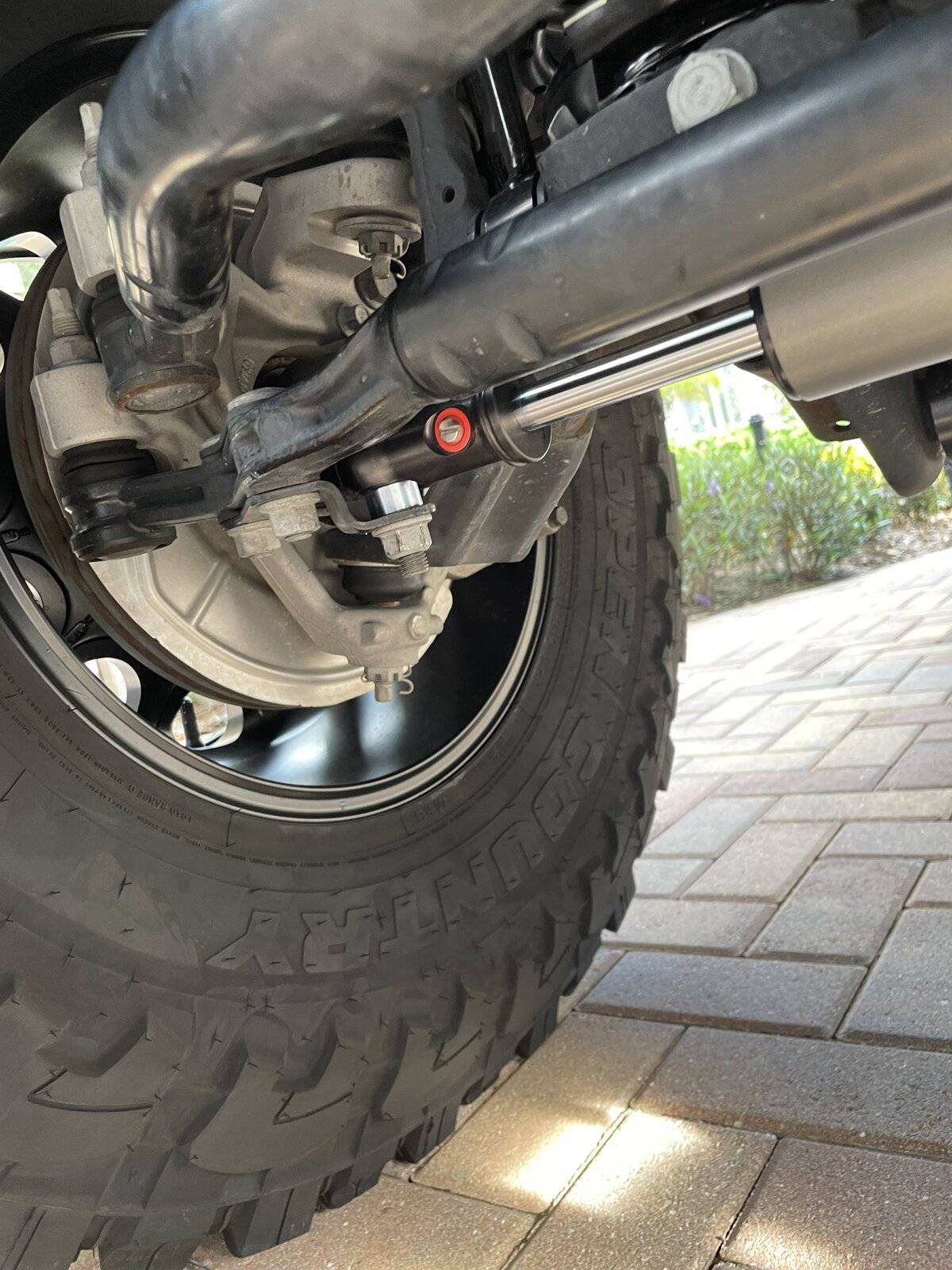

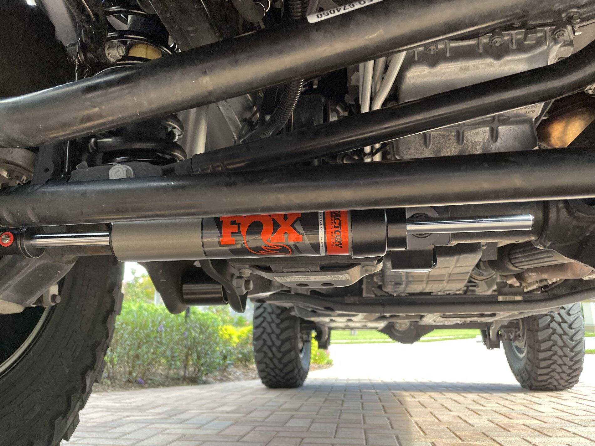

I've had the same problem as everyone with the hard pull to the right after Mopar 2" lift on 2020 JLUR and Fox 2.0 IFP steering stabilizer, running 37 x 12.50. Took it in several times for alignment, nothing would fix the issue and it was so frustrating. After a lot of research, ended up ordering the Fox 2.0 ATS steering stabilizer and installed it today. Problem solved, no pull, and the steering is actually even tighter. I can even drive it with one finger at high speeds. Big investment, $450 for the ATS, but worth it.
