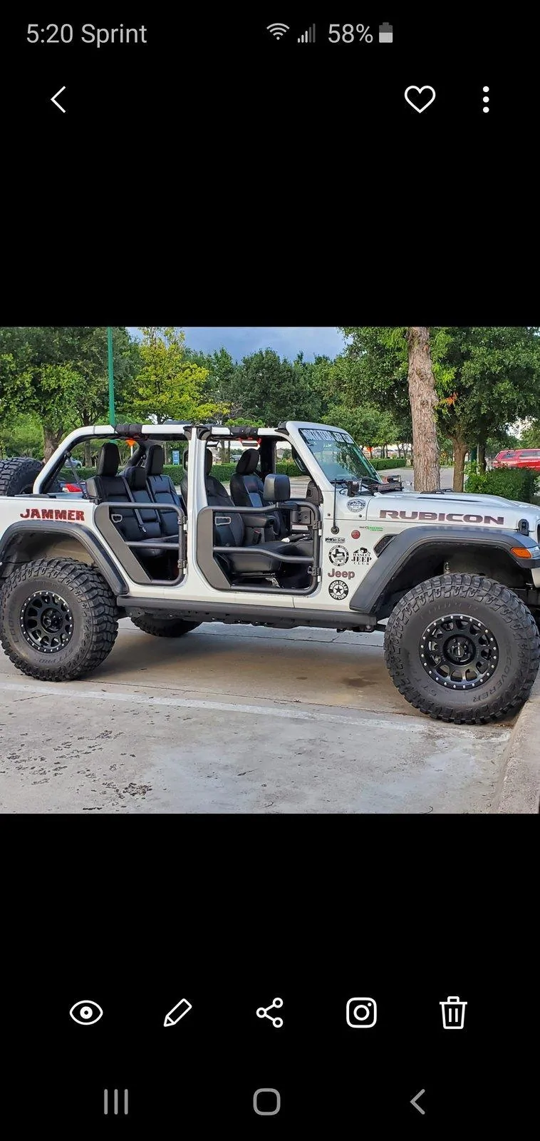

I like the stock ram they look great but I wanted black wheels. With my Jeep being wide I just thought the black wheels really look good everything's black and white on my Jeep
