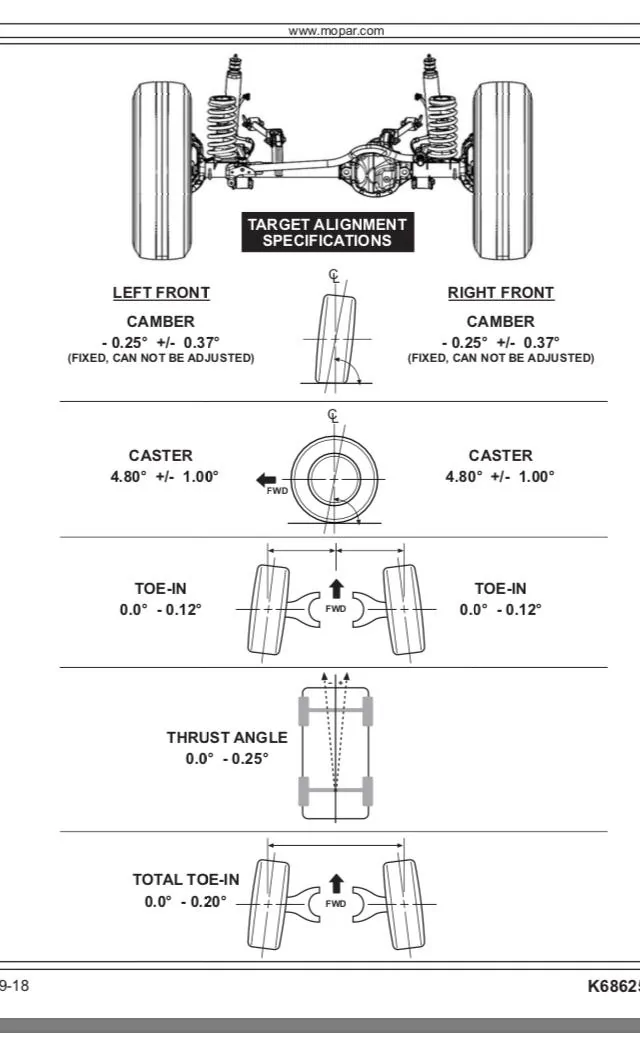

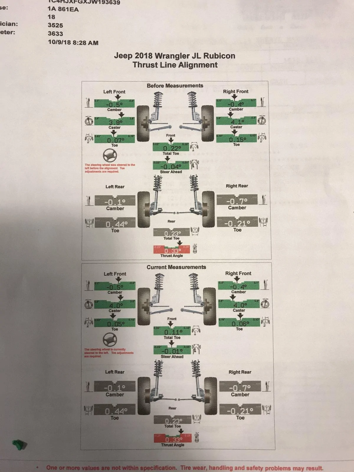

Adjustable track bars will most certainly affect the thrust angle. I had the same problem as originally stated after a lift and with front and rear adjustable track bars the thrust angles have been on the money....more importantly that pull to the right is gone
the dealer next week is going to put on the new track bar that came out for me. People are saying that it's a lot thicker and beefier and better than the one that came on the 2018 Rubicon Jeeps. If that doesn't help my pull to the right then we might try adjustable track bars but my problem is going with the 1350 Tire in the Cooper stt Pro is riding on that outside crown and is making it pull to the right. I've also got a set of teraflex control arms that a friend of mine gave me free and we might put those on first they're half an inch longer and it will give me more caster.but the lawnmower guy said I can't make the caster different will be the same on both sides and it might not make any difference so I'm not sure which way I'm going to go if I put those on 1st since they were free and try them after the dealer puts on the new updated track bar. Just don't want to be spending money on Parts if I don't need them. When I had to 37 12.50 it drove straight with the Nitto Ridge Grapplers. Several people told me I'm going to have problems when I go to the 1350 and I do. I should have listened but the 37 12.50 it's just too narrow the 37 13.50 looks better to me. I mean think about it I 35 1250 looks just right you go to inches taller it's going to be more narrow it's like a brick is standing up on the end now in my opinion. Here's a good example of a 37 12.50 vs the 13.50 on the right. Some people like the narrow Tire some people like a wider Tire. I like the wider Tire just wish I could get it to drive straight lol

I’ve had alignments and even did my own red neck alignment with the straight edge and tape measure. I’m still getting a pretty good pull to the right. I’m also on 13.50s. Did you ever get yours lined out?

You guys should check your thrust angles if you are pulling to the right. When you lift the jeep with a stock rear track bar, the axle gets pulled to the right and throws off the thrust angle (makes it point to the left). This causes the Jeep to pull to the right. If you get a rear trackbar bracket or adjustable trackbar in the rear, you can fix that. Also, if you get a "wagging" rear end, I highly recommend the rear track bar bracket.
