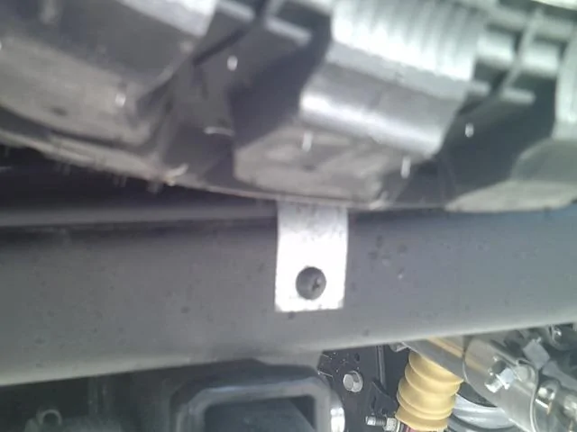

Resting the spare on the BUMPER takes all the major WEIGHT OFF THE TAILGATE and is usually very (outta sight/cheap)-
Jeep Wrangler JL Price aside - Mopar tailgate reinforcement SUNP0238_zpsccrjbuit
Jeep Wrangler JL Price aside - Mopar tailgate reinforcement SUNP0237_zps4krkvqzy
JIMBO
My not so bulky, compact, nearly invisible solution. Works perfect. Oh, and it was free!
