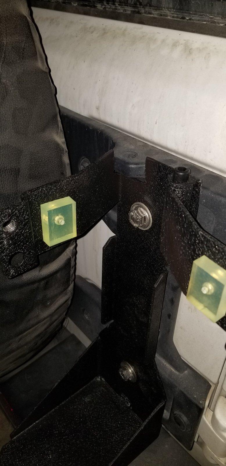

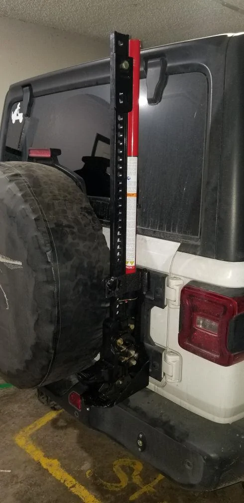

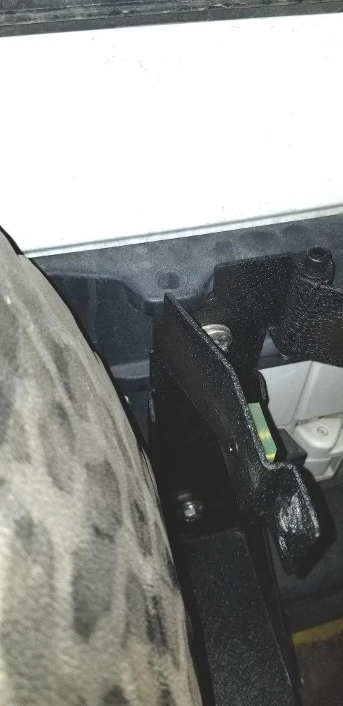

I had to notch my high-lift jack mount to fit around the antennae point. I also had to spec custom bolts because the ones that came with the tailgate reinforcement were not long enough to also hold the bracket. I haven't found a use for those other threaded holes.

Does your Jack and or mount rattle? I liked the teraflex because both supports went through the jack. I find when I support the base and the jack with only one bolt they tend to wiggle a lot more. I've had to put a peice of wood to put pressure on the jack mechanism.
Mine hasn't rattled. I keep the upper and lower clamps pretty tight. Occasionally some rattle from the handle but it's just held together with some velcro.

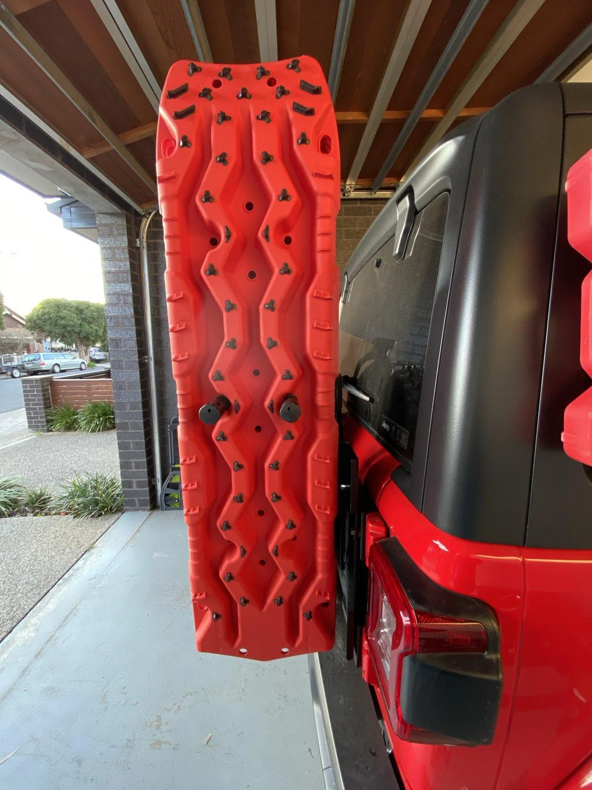

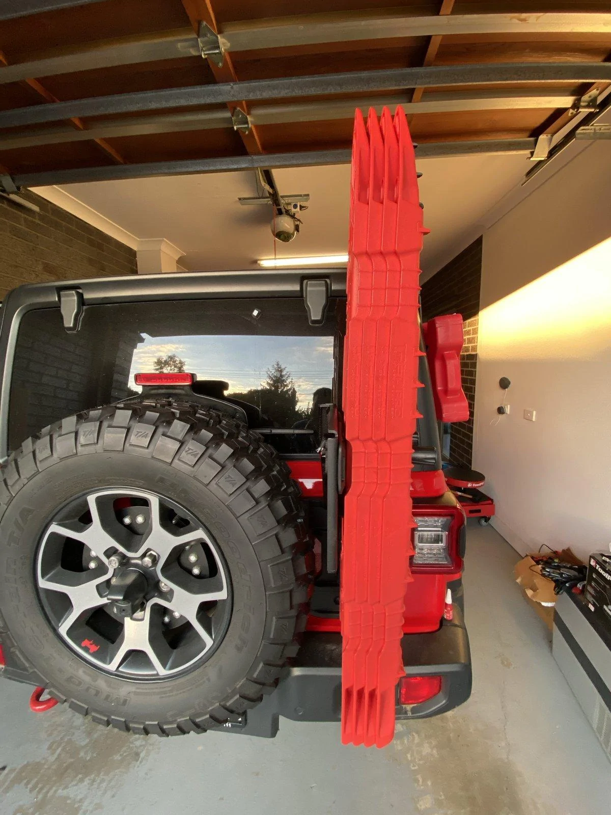

I got a similar plan. Got the GP factor hinge mount. Just waiting for the Mopar tailgate reinforce to be delivered.
I am planning to mount my recovery board/maxtrax on the hinge mount.
would appreciate any feedback or photos from your install.

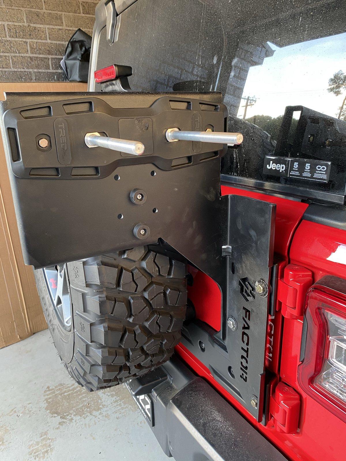

After about 5 round of modification/cutting/trimming got the GP factor mount on the JL mopar tailgate hinge.
Mounted 2 set of TredPro as I already got a Trailrax for the Rotopax mount.
That is SLICK! Thank you for sharing.
