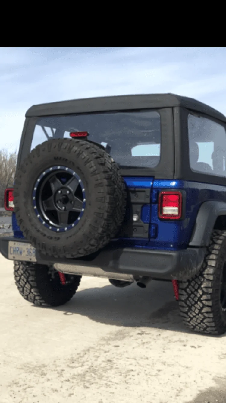

I installed my reinforcement bracket and relocation today. I like the looks of it and got it for a good deal.
Moved the rear brake light up one notch,
Then just bolt it all on, make sure you have large size Torx bits. I had to go get them
It moves the tire up and it moves it further out, with the large tire bumps installed it works well. As said before, not sure how much help this provides the tailgate, but im sure its some.
Im running 315/70r17 duratracs on procomp wheels, so my set up is light at 89lbs a piece
