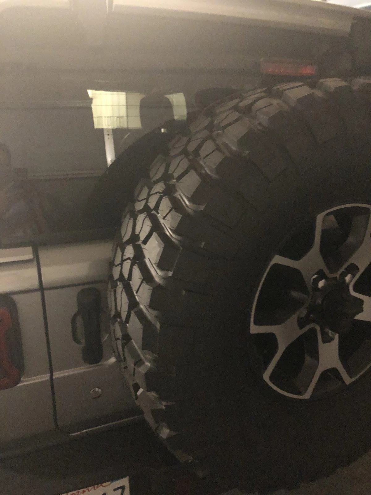

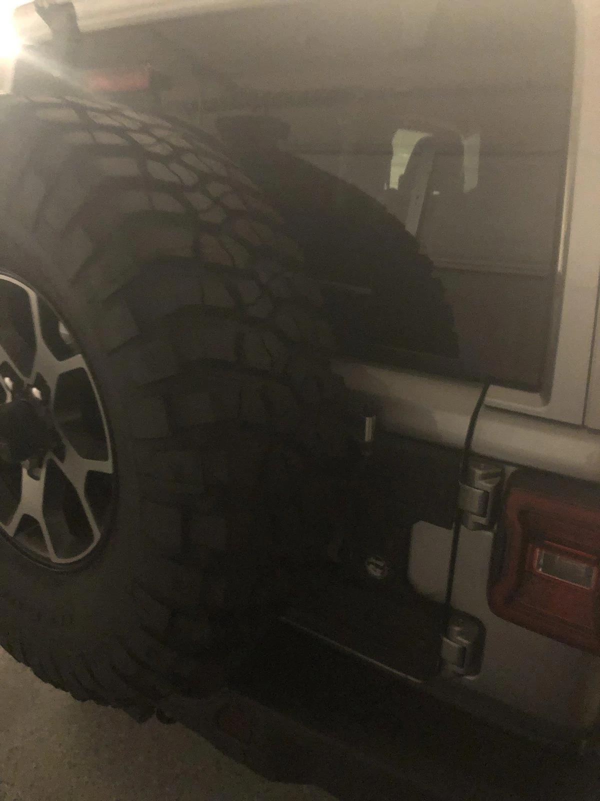

I got both the Mopar reinforcement bracket (82215356AB $450) and the oversize tire carrier (82215355 $220) and it does not fit my BF Goodrich KM3 37" tires even though it's advertised to hold up to 37" tires. This system does not lift the carrier up and so my spare is sitting on the bumper and i cannot close my tailgate door.
Had to order in addition to already paying $670, the RC Relocation bracket ($80) to raise the tire carrier up by 2 inches. I also had to purchase the brake light relocation bracket as well (82215349 $80).
In total it costs $830 just to carry a spare.
I bought those 2 mopar parts as well. Now I'm thinking if 35x12.5x18 will fit. Your running 37s, is with 18 or 17 wheels??

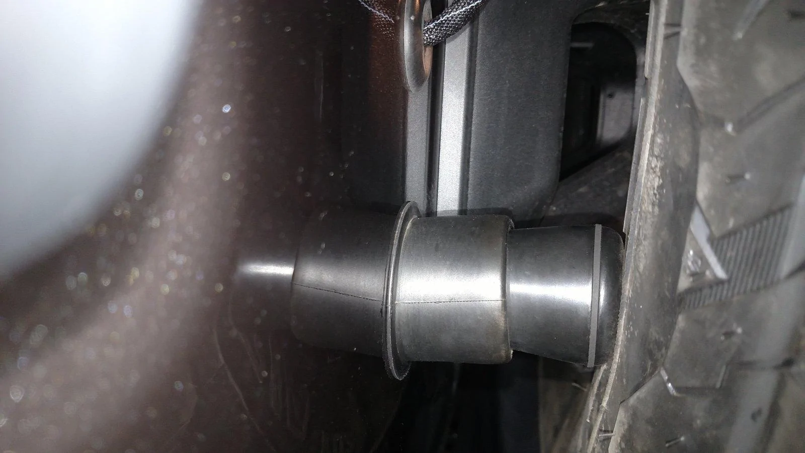

Its a 35in tire. Plenty of room for a bigger tire though. Using it with the reinforcement kit, you get an additional half inch of distance out, on top of the 1in you get from the bracket alone.
I am however having to find aftermarket bump stops, because the stock ones no longer reach the tire. A 37 may not have the same issue. That being said I haven't had any issues with vibrations, even without the bump stops.
Insert a length of PVC pipe into the rubber bumper with a 1/14 chair leg rubber on the tire side works great! You are taking a big risk and its only a matter of time before damage occurs.

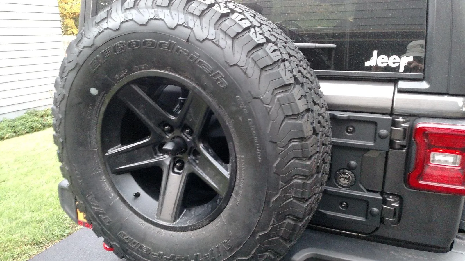

I went wit the Quadratec Rubicon Extreme's and did the PVC and chair leg thing.
Jeep Wrangler JL Mopar Tailgate Hinge Reinforcement & Relocation Kits IMG_20181004_070100798
Jeep Wrangler JL Mopar Tailgate Hinge Reinforcement & Relocation Kits IMG_20181004_065418214

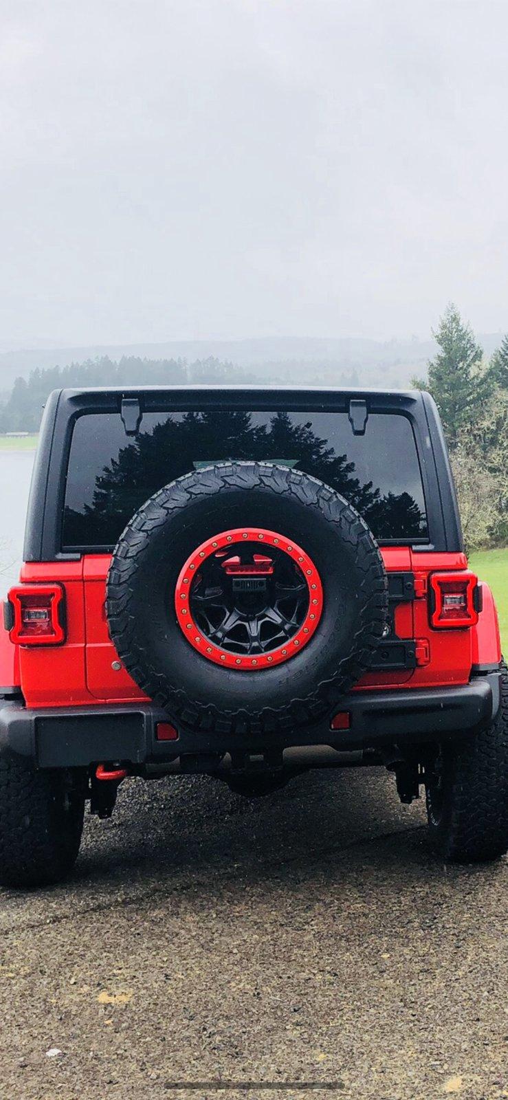

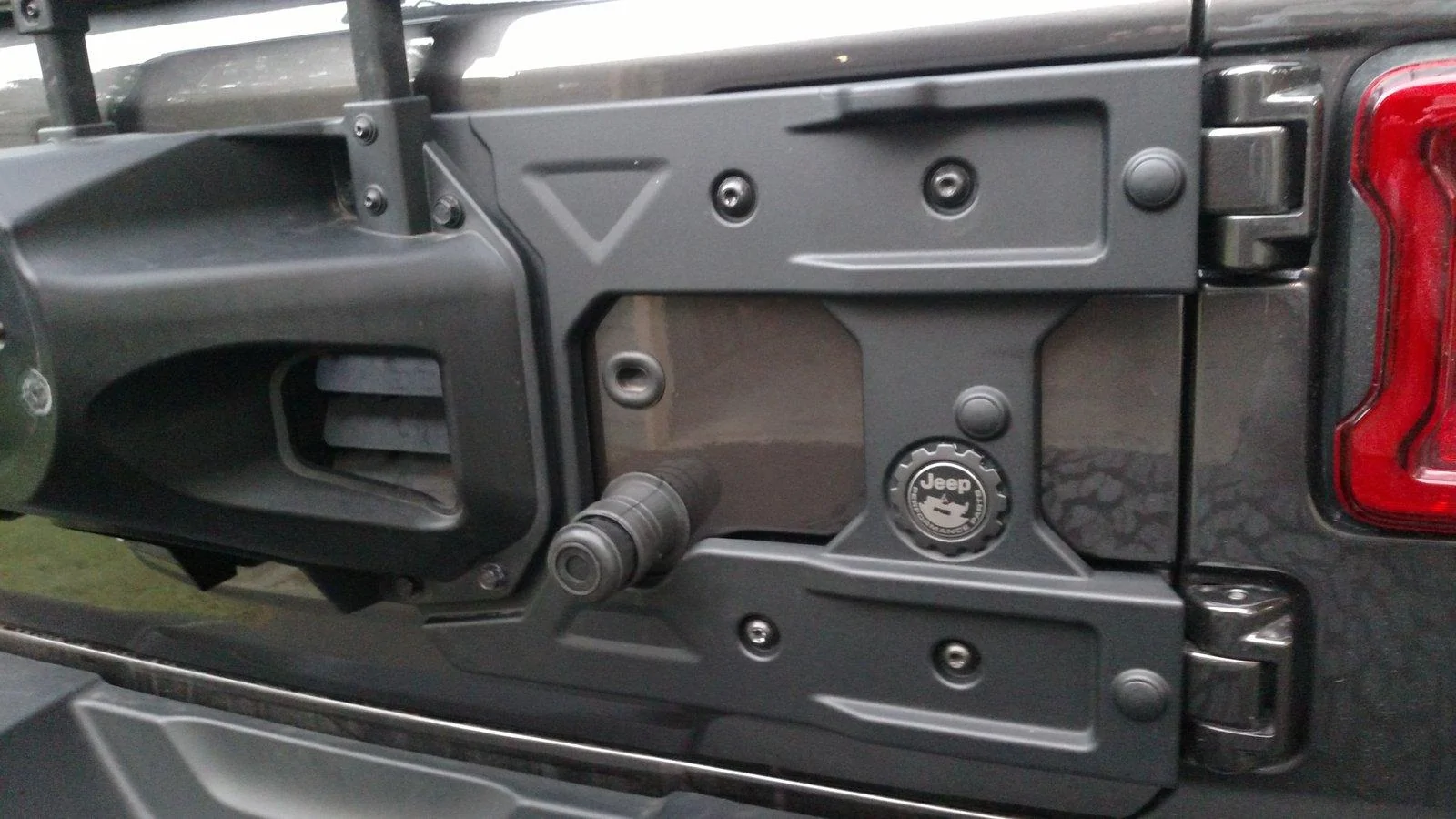

37 KO2’s With Mopar reinforcement and relocation bracket. 6500 miles and perfect. Zero deflection
Jeep Wrangler JL Mopar Tailgate Hinge Reinforcement & Relocation Kits 605BC540-5309-4C54-95E6-D8822830113A
Jeep Wrangler JL Mopar Tailgate Hinge Reinforcement & Relocation Kits F7C7998D-E1D6-4ADA-8639-73FF01FDC741

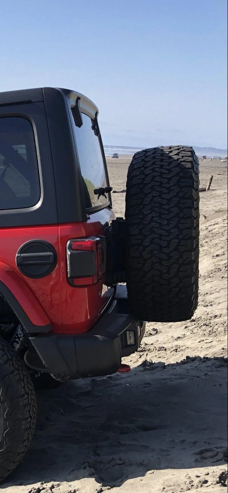

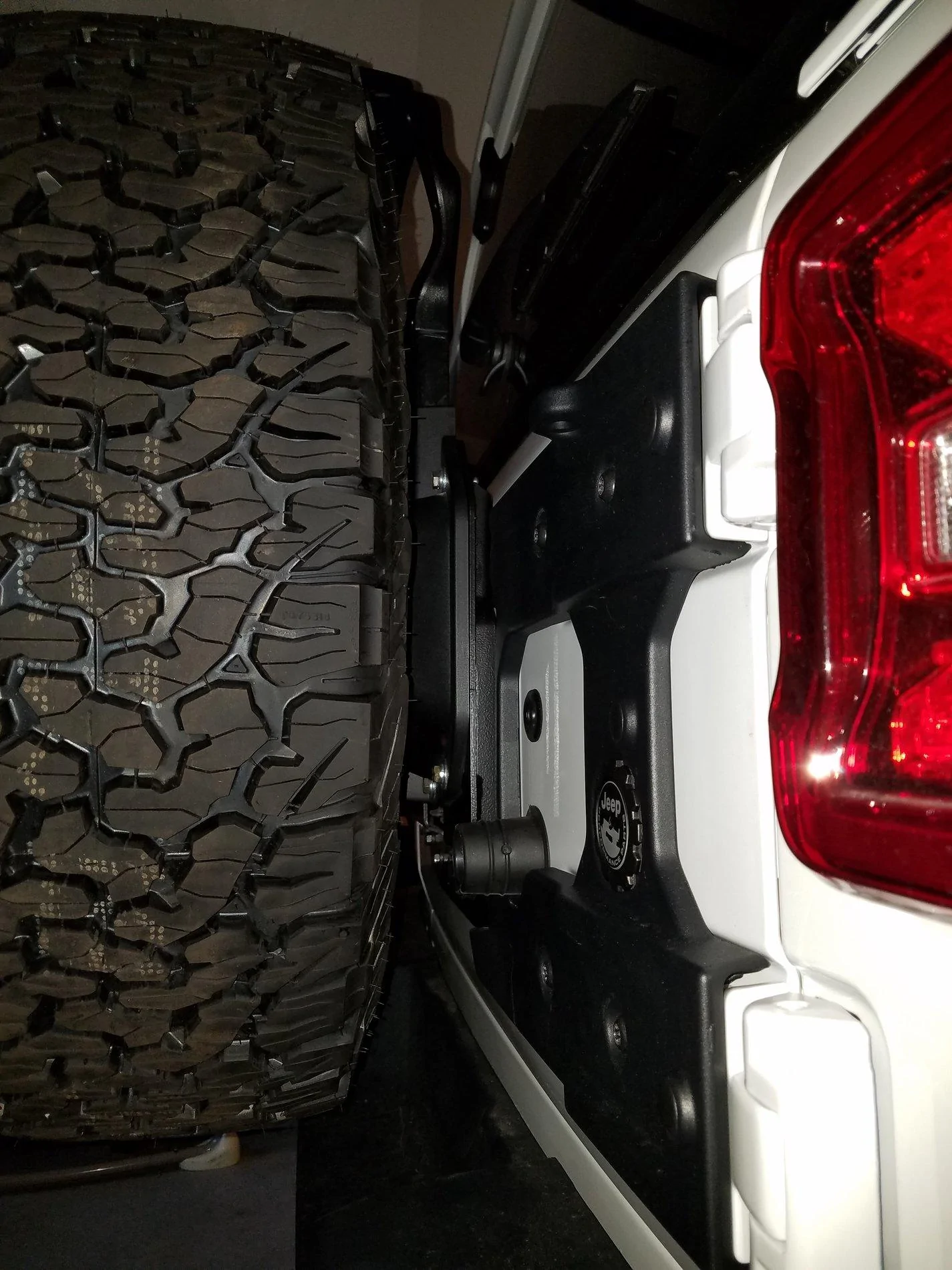

I have had the Mopar tailgate reinforcement bracket (& RC relocation bracket)on since Feb with a 37” BFG . Was on the Rubicon trail this year and have been to Pismo Beach Dunes multiple times. No issues for me so far. Also, no rattles or pops.

Bumping this to see if anyone has figure out exactly what can be accommodated - I have a 35" tire going on a wheel with 4.75" BS, I got the Mopar reinforcement kit but do I need the oversize carrier/relocater as well?
You will be fine without the relocation kit. Here is a pic of 35's on the Quadratech Rubicon Extremes with 4.5" backspacing. If you have the steel bumper a 35 will be touching it but with the plastic bumper nearly 1/2" space between tire and bumper.
