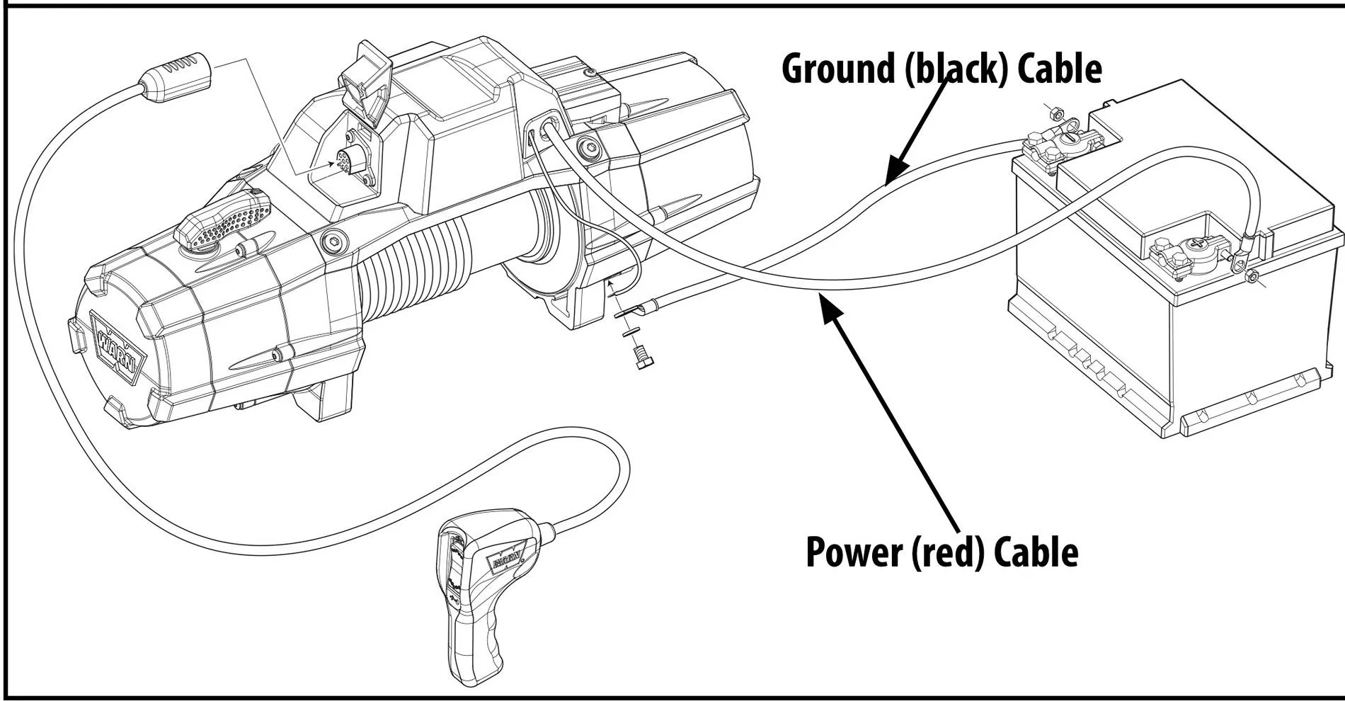

Warn Zeon 10s instructions make no mention of a power interrupt that I recall. I have the power interrupt wired to aux 4, not because it’s mandatory, but because I chose to. This same debate goes round and round with the same folks repeating the same opinions…that’s why forums exist. Here are the wiring instructions that I received.

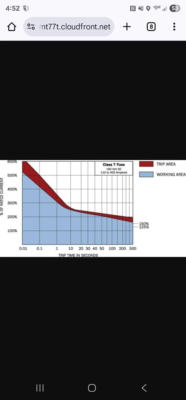

Are there any other unfused always-on circuits?
The circuit isn't on until the winch solenoids are activated. Are there any other 400A+ circuits on the vehicle period? In a vehicle where the battery is remote mounted the battery leads are far longer than winch leads... and still unfused. Your typical DC class T fuse will run at 200% for a full minute. If it's sized for max winch draw it will never trip at max CCA.

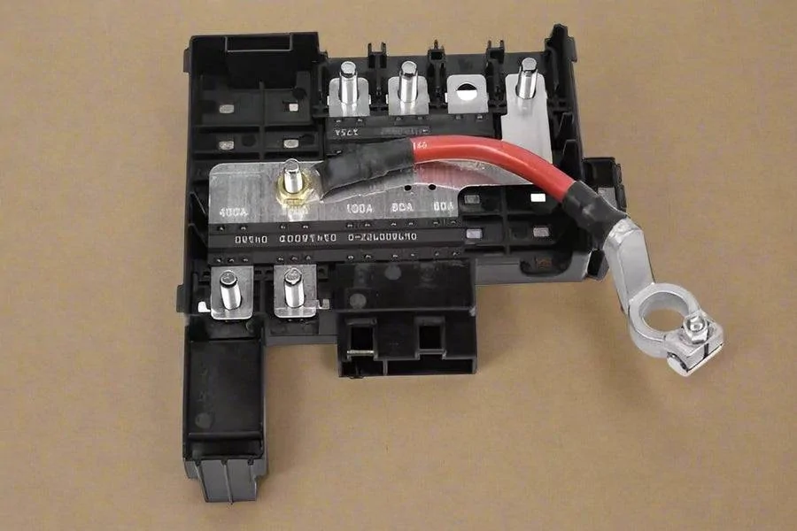

I just checked because my CTS has a trunk mounted battery. It does have fuses. There are five fuses in the distribution block that sits right on top of the battery. My Silverado also has fuses even though the battery is up front. I believe the JL also has one of these fused distribution blocks right under the main fuse box doesn't it?

Where's the single 400A fuse though?
Far left in this pic:
Jeep Wrangler JL Power cutoff for Winch -distribution-engine-fuse-block-oem-56668872966431
Where's the factory installed winch with a cutoff switch or a fuse? Why don't they just run 1 big fuse on the battery positive terminal for increased safety? Because any fuse big enough for the full load would never trip. Sure you could try getting creative with a class T and run it undersized on the hope that you never pull the full 400A rating of your winch long enough to blow it. I wonder why nobody aside from the paranoid on the internet does it? Why don't winch manufacturers recommend them? If it was nearly the safety concern or as easy as the uninformed on the internet make it out to be they'd have some liability waiver if you installed their winch without a fuse in the install manual. Instead of 1 big winch you could run 4x 2k pound winches with 100A fuses I guess?
Lots of guys run 250A fuses on their winches and never have a problem. You would most likely overheat the winch before you pulled enough amps for a long enough period of time to blow a 400A fuse...what's the contactor in the Zeon rated for? It's not 400A continuous I know that.
Actually, I'M the one who should be able to get that answer. I'll ask and report back.
That's a 400a rated distribution block, not a fuse. Even if it's a fuseible link they often cause major damage when they melt when they are that large. I'm willing to bet there are far more unfused winches than under fused running 250A fuses on 400+A rated winches.
