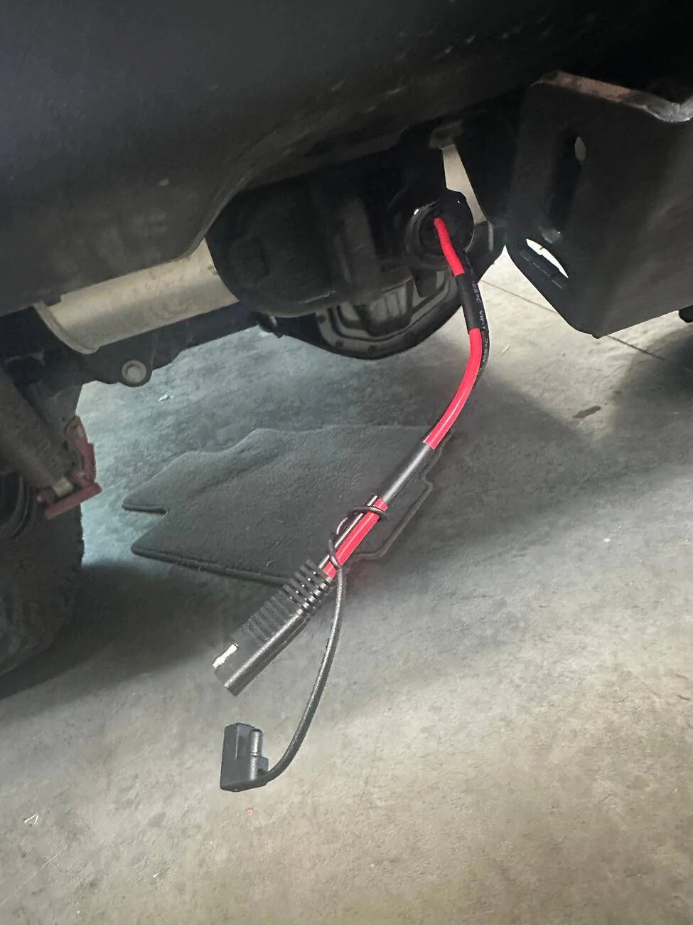

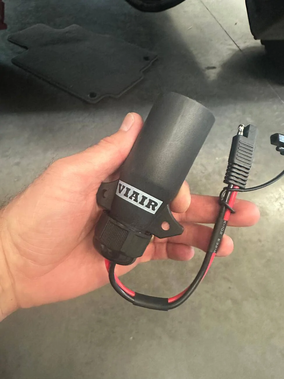

jadmt
jeff
May 19, 2020
78
5,131
9,766
montana
I didn't do it, but I did think it would be a good way to have a quick connection for a portable air compressor.
I went the cheap way on that...:) easier than open the hood and using alligator clips.
