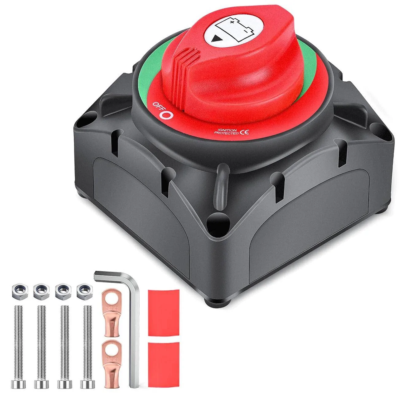

I put one of these style, in line from the winch to the battery. Hood is locked so the winch cannot be powered up. Works for me.
Jeep Wrangler JL Power cutoff for Winch 1746561112280-sg
