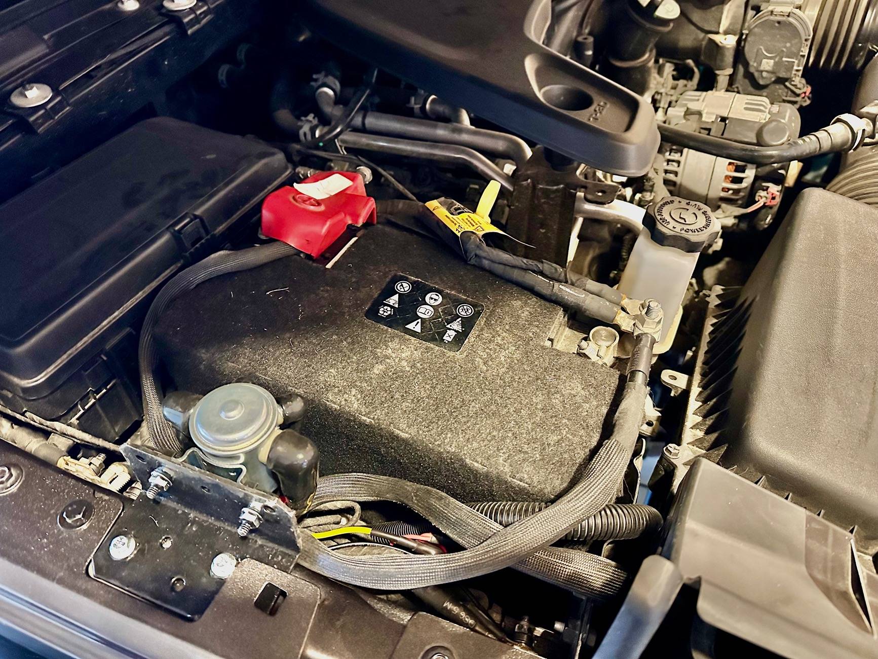

That said - the creator of the Zeon XD/XP is a relation of mine. He helped me get my winch, and instructed me on how to properly wire and use it. He told me to use a disconnect solenoid. So I have one on my current winch, and will have one for every winch I own.
I see no downside to it... the cost is negligible and it provides additional safety. I had to unmount mine to change out the main battery over the weekend - it took all of 2 minutes ( 2 minutes every 3-4 years... I can live with that). I was a little surprised to see how haphazardly the factory wiring was in that video. Tyler re-routed the cables exactly as I did; but I pulled the passenger fender liner and went up through the wheel well, also wrapping each cable in its own loom. I've heard too many stories of vehicles spontaneously combusting due to some unknown short.

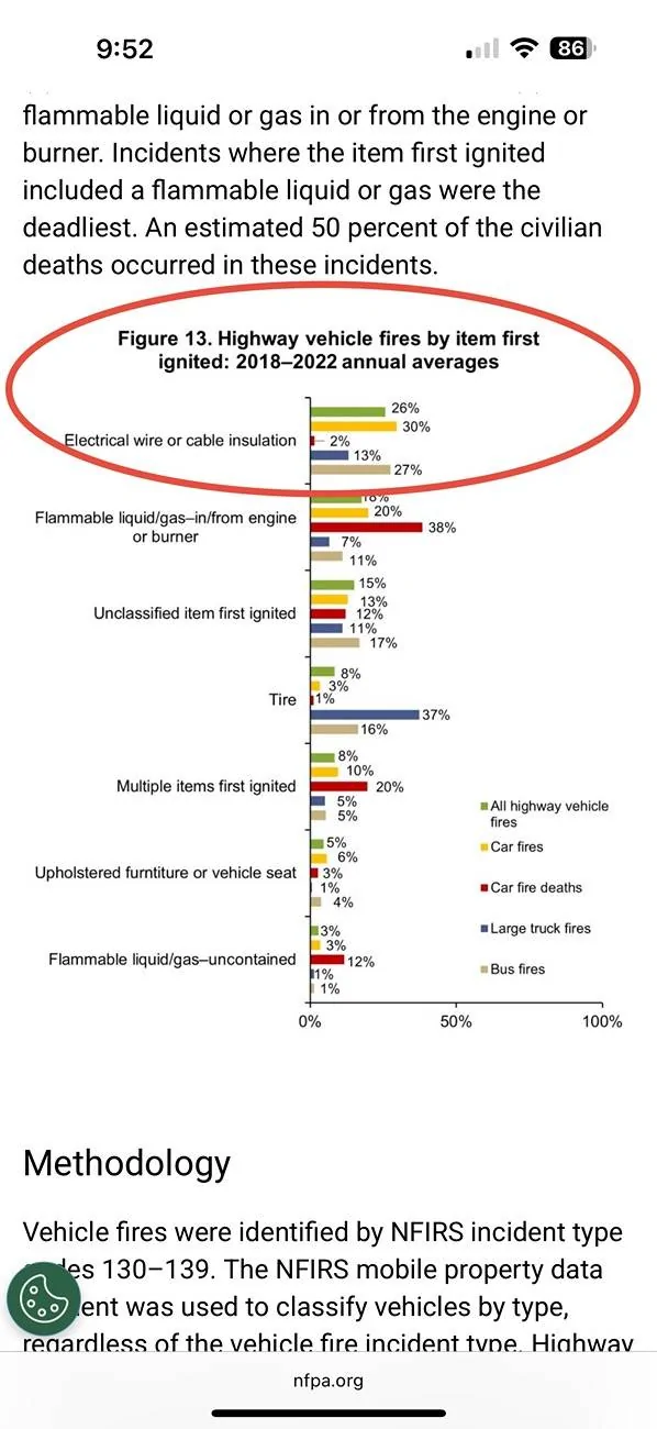

I love the, “my jeep doesn’t have a cut off switch and has never caught on fire, so nobody else’s Jeep will burn either.” I wish good fortune was contagious, but it isn’t.
Jeep Wrangler JL Power cutoff for Winch IMG_0614
https://www.nfpa.org/education-and-...search/fire-statistical-reports/vehicle-fires
I have 500 amp shut off solenoids on all three jeeps. They kill power to my winches and air compressors. I also have one in my Toyota Tacoma where I added 2ga cables for power points in the rear bed to run my diesel fuel transfer tank. It isn’t 100% necessary or unnecessary it’s all about how you feel about precautions. To each their own
To each their own is correct put posting general stats that don’t specify what the cause was does nothing to try to prove your point. Electrical wiring is a very, very vague stat and there is no mention of vehicle model, what the “electrical wiring” issue was and it even notes most of them were older vehicles from a decade or more ago.

To each their own is correct put posting general stats that don’t specify what the cause was does nothing to try to prove your point. Electrical wiring is a very, very vague stat.
Very vague, what do you think causes an electrical fire?
The discussion is about a shut off solenoid to prevent the risk of fire in case of a short circuit. Did you read the link I provided, it wasn’t a CNN pole it was the National Fire Protection Association and I doubt you read the entire link because it’s long and you jumped the gun on your reply.
Nice edit

Nice edit
You posted a link to some data that has says nothing about a winch, a solenoid, or any other shut off device preventing a fire of any sort. Once again, people make comments without any data to prove their point. Somebody please show me something that says jeeps without a cut off switch for the winch wire create a fire. There isn’t any, and if there is, it’s a negligible amount. Yes everybody knows defective wiring can cause an electrical fire. That’s what the NFPA report says.
