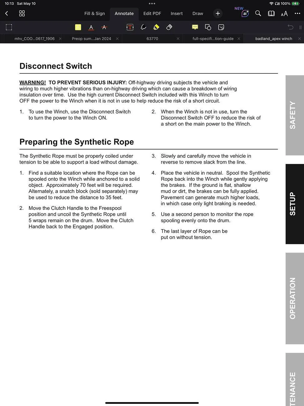

You do realize that large scale battery UPS systems (480V+, 4000A) are also hardwired without fuses right? And only an idiot is adding that quick disconnect on their bumper mounted winch. Extra cost, added failure point, no gain. Again you're misinterpreting the existence of a product with the recommendation of its use. No, they don't recommend a disconnect for hard wired bumper mounted winches period. Not in the literature and not if you call them and ask. But what do I know, only 25+ years of commercial/industrial electrical experience...
Zach, am I an “idiot” for following my Apex winch install instructions? The supplied cut-off switch is listed on THREE warning pages of the manual. This page explains why.
Jeep Wrangler JL Power cutoff for Winch IMG_2980
Zandcwhite
Zach
Sep 4, 2019
8,305
14,199
Patterson, ca
2019 jlur
Again... only slower. I said running a power cutoff switch or solenoid AND the Warn quick disconnect plugs together on a hard mounted winch is something only an idiot would do. As I've started 50 times already running a disconnect switch is no problem if you want to. Most winch manufacturers not only don't include one they don't recommend one either. I'm well aware that harbor freight includes them. I can see why you may want to run a switch. There's no reason to add additional failure points of quick disconnect plugs, especially in conjunction with a switch. You need to unplug your dead wires from your hard mounted winch?
Zach, thanks for the “slow” clarification! I’m only on my second cup of coffee…🤣
