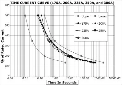

The chart is very clear, I don't know why it's hard to comprehend. Instantaneous trip requires >400% of the rated current period. That works on a circuit breaker in a panel as the available fault current is usually well into the thousands of Amps. It works on a vehicles fuses up to ~150A. Beyond d that and you don't have 400% fault current available. That's how overcurrent protection works. Even to trip in a full second you need 300%. Your available fault current is only ~165% of that 400A fuse. IT WONT TRIP FOR MINUTES.

This is the chart Zach is referencing (this is the one for the Blue Sea Systems MRBF I use):

I know. He's confusing "instantaneous trip" with the current ramp that I was referencing. Two different things. However these curves do illustrate what I was attempting to explain to him - how circuit interrupters are tripped by heat, not current alone. Thus, a slow ramp of current will be tolerated by the protection device for far longer than a fast ramp.
Wow...that's dark.
The amperage generates the heat. You're slightly correct, look at the right side of the graph. Most fuses will hold 150% of there rating almost indefinitely. The part you don't seem to understand or simply won't acknowledge is your source even in a dead short isn't capable of the 300%-500% necessary to pop a 400A fuse in under a second. The left part of the chart basically doesn't exist when discussing winch fusing... which is why nobody who knows what they are talking about recommends fusing the winch in the first place.
