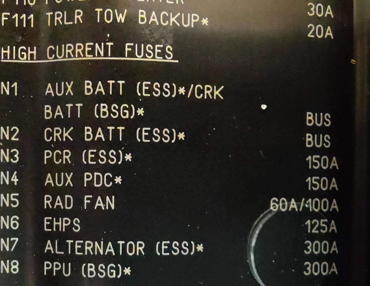

Stupid question: what is the 300A fuse for? Seen on the right side, would be at the rear of the fuse box.
Edit: nevermind.
Kinda looks like it's for the starter...

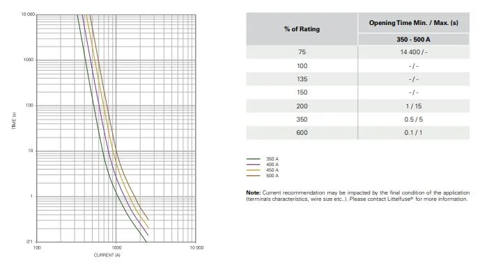

There's a chart that anyone who can read can understand. No fuses don't require power to ramp on slowly to not trip. That isn't how fuses work. Not only do you get the full load current when you turn on an electric motor you get the massive startup spike. If fuses worked like you think they do you would blow a fuse every time you turned on a motor period. Not only do they not trip faster if the spike is instantaneous they are rated to cushion that and then still trip if the high load persists. Look at the curve for Christ's sake. The 750 CCA is nearly 190% of the CCA so yes if the starter remained engaged for long enough it could trip but no it wouldn't be instantaneous. Not enough available current.

Here's Littel's Mega chart for the high amperage options, they've got a table that's kind of nice to the side. The Silverado's appear to use 400 amp Mega's (although the diagram on my L8T 6.6L says 500 amps)
Jeep Wrangler JL Power cutoff for Winch 1747077088556-il
EDIT: Oddly, it looks like the fuse pops at 75% rating after 4 hours, but not at 100% rating.
What a mess. You don't get it and you don't want to get it.
It does, they just don't have those exact numbers. We can safely assume it's somewhere between 1 second and 4 hours. LOL.

Scott, I might be late with this reply, as I haven’t read the plethora of comments after yours yet.
The starter is fused to protect against over-current. I believe it’s F02, sir.
F02 "Starter" is 40A. Probably not the starter power, but would probably prevent the engine from starting.
Found a few things online. Yours could be different:
Jeep Wrangler JL Power cutoff for Winch 2019-jeep-wrangler-jl-tail-light-fuse-specifically-looking-v0-4jppdmzxg7zb1

Bury your head in the sand all you want. The only way a fuse trips faster/ near instantaneously is via a massive current spike period. Unless you hit it with 400% or more of its rating its going to take time to trip. That's what these charts tell you. The closer your over current is to the rated current, the longer it takes. Being that your source in the JLs case isn't capable of 1600A, it won't trip a 400A breaker quickly period. Of course there are picture of the 300A fuse in the JL that says alternator/ belt start generator (which is the alternator on etorque models) and you immediately say it looks like it goes to the starter. You live in your own alternate universe with made up facts unsupported by the evidence clearly presented to you. I decided to go out and look at the Jeep. 300A zcase fuse goes to the alternator, and the starter wire runs unfused straight to the battery... just like my winch line.
