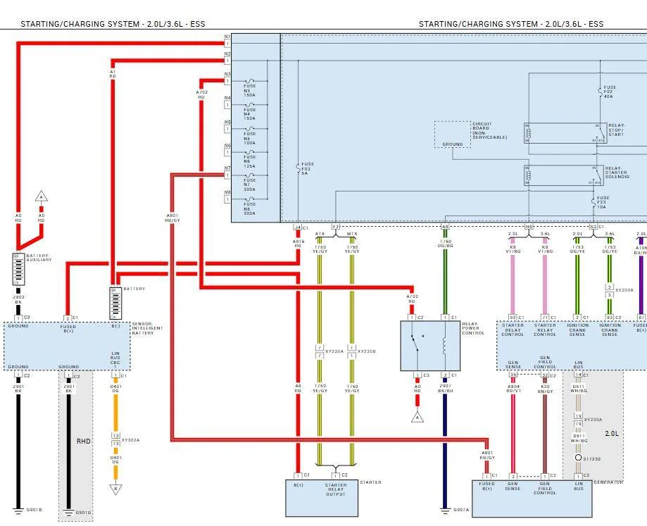

Here's the diagram for the ESS models verifying Zach's statement.
Jeep Wrangler JL Power cutoff for Winch 1747080002720-o

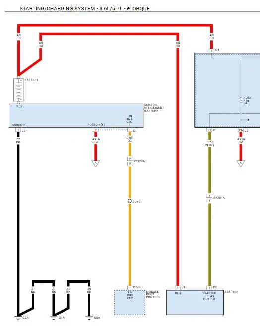

My Wrangler manual doesn't have the BSG version, but here's BSG from the Ram e-torques in 2019. As mentioned direct wired standard starter, fused BSG:
Jeep Wrangler JL Power cutoff for Winch 1747080295978-ng
Jeep Wrangler JL Power cutoff for Winch 1747080391292-qk

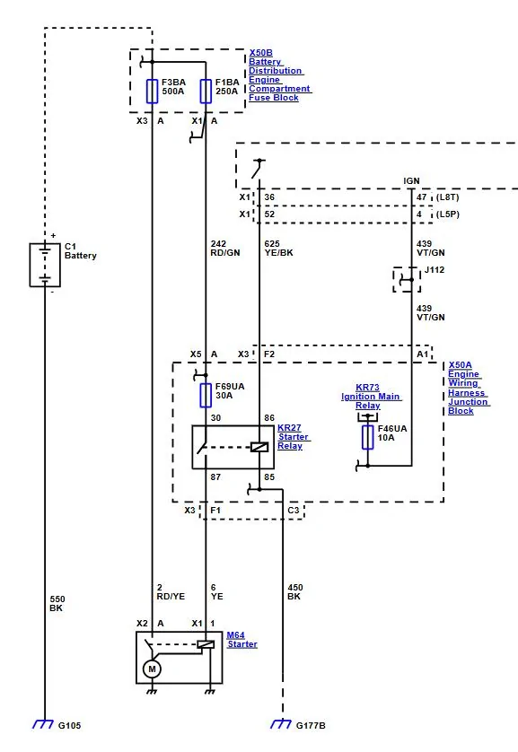

EDIT: And for shits and giggles, the 500 amp (which appears to really be 400 amp) on the Silverado L8T with no environmental nannies:
Jeep Wrangler JL Power cutoff for Winch 1747080482359-xd
