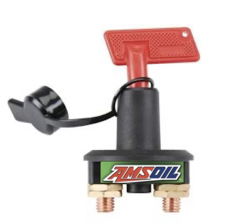

John, this is the cut-off switch I’m using. Guaranteed to never fail!
Jeep Wrangler JL Power cutoff for Winch IMG_2988
