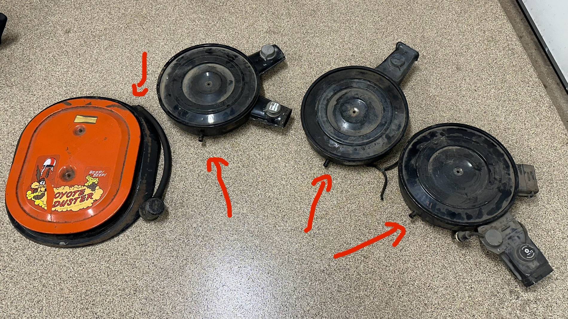

Oh, really? I’m making it up? Ok, since you are an expert that works on all makes and models, then look at this photo.
Jeep Wrangler JL New Version of PCV IMG_7955
The arrows point to where the PVC line connected to the intake system. It is outside of the air filter element. Every American manufacturer had the hose located in the same place. Why was it moved to an entry point behind the throttle body on the newer engines?
(Hint: I can show you pictures of the insides of these air cleaners and they are bone dry. Not a drop of oil in them.)
Let's get specific on make and model and I'll give you the diagram. PCV should route to the carb on your old shit. The port on the air cleaner housing is not the PCV. Hell, your 3.6 has the same connection for the fresh air makeup back to the engine. PCV consumption is not the primary cause of oil consumption on most engines anyway. This really isn't anything worth arguing, its simply fact that the pentastar engines burn less oil than nearly any other engine on the road. Off the top of my head I can't think of another high production number engine that has such low consumption.

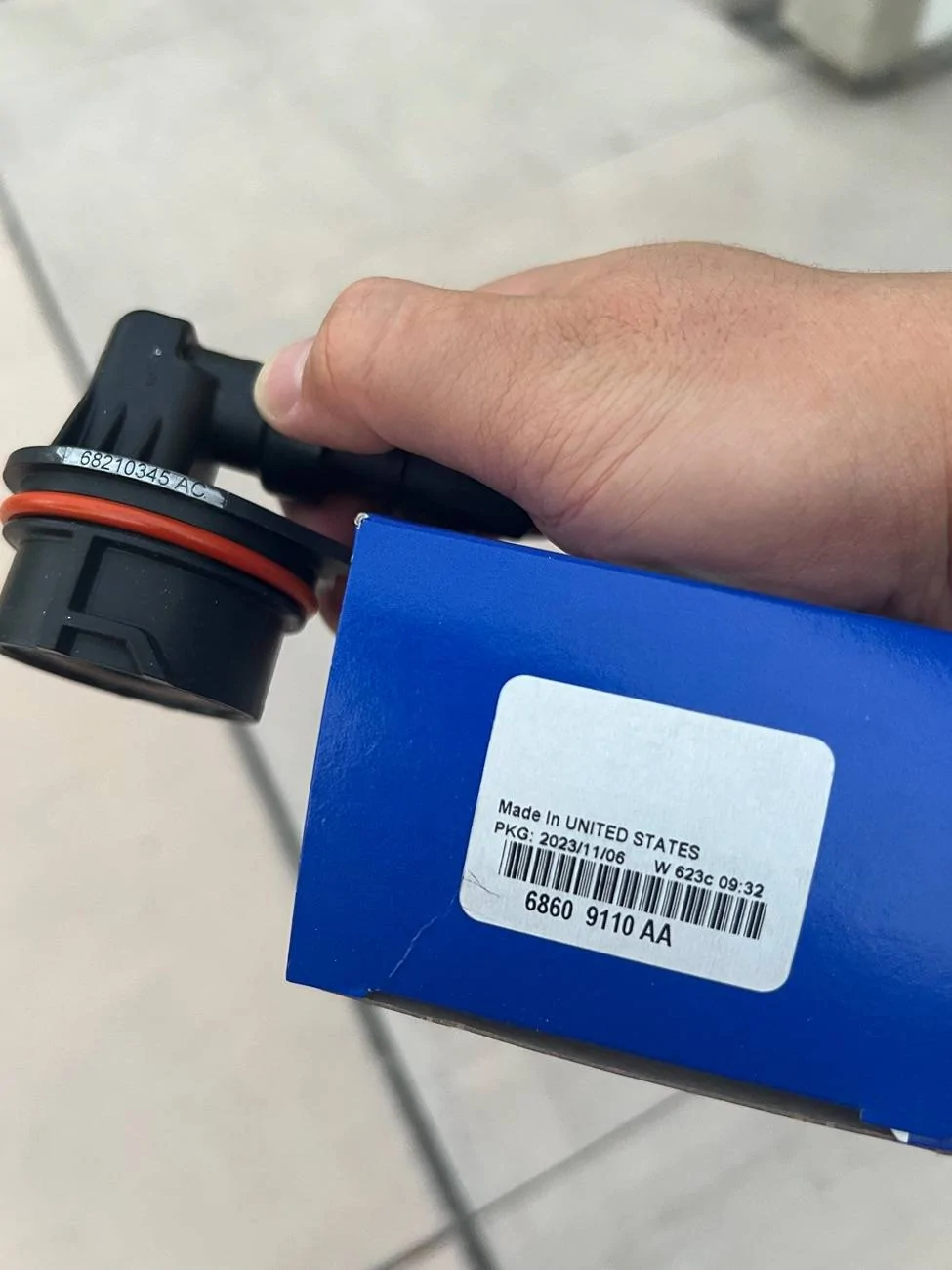

Current and serviceable part number being sold is 68210345AC
Previous # was 68210345AA
Please let me know if you have any other questions.

Looks like the latest part number is 68609110AB - it replaced all other variants (68210345AC, 68609110AA), and the TSB is referencing it.
I installed 68609110AA from two years ago and it still getting lots of oil in the catch can. Not sure if this would help.

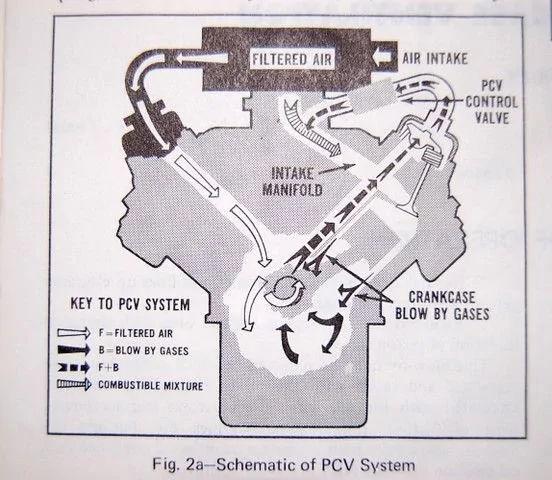

I think a "catch can" is a wonderful thing....for a car or truck that never see's the angles I take my jeep to, and has an owner that is enough of an "enthusiast" that he'll drain the thing before it's a problem . It's simply an additional air-oil separator. Mann-Hummel makes some that are more sophisticated than the simple type of V8 juice can that is popular. But if you want to further define the difference between a simple catch-can and a more sophisticated OEM type of air-oil separator, I'd say catch-cans are simple, small, expansion oil vapor condensers, where an air-oil separator is often larger and has more baffling and some have membranes to catch droplets of oil, and the single thing that makes them practical for the general public, is they all have return lines to self-drain to the crankcase.
"Back in the day" we had carburetors that flushed the oil vapor down the hatch with fuel. They mixed right togther under the carburetor. That kept our intake manifolds pretty clean. Some engines had a plate that went under the carburetor, some attached to the carburetor itself, some to the intake manifold. There should not have been crankcase vapor going into the air filter housing.
