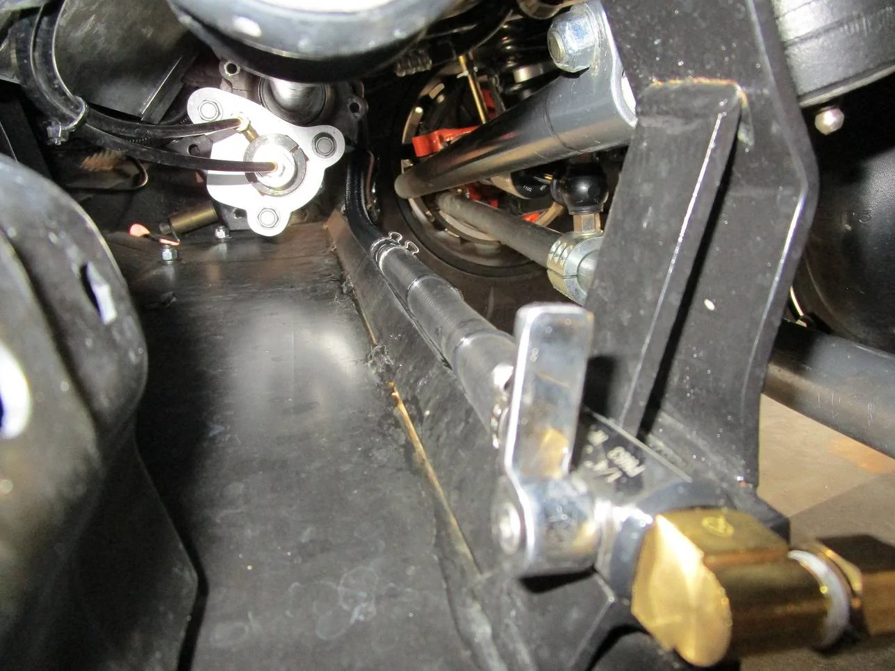

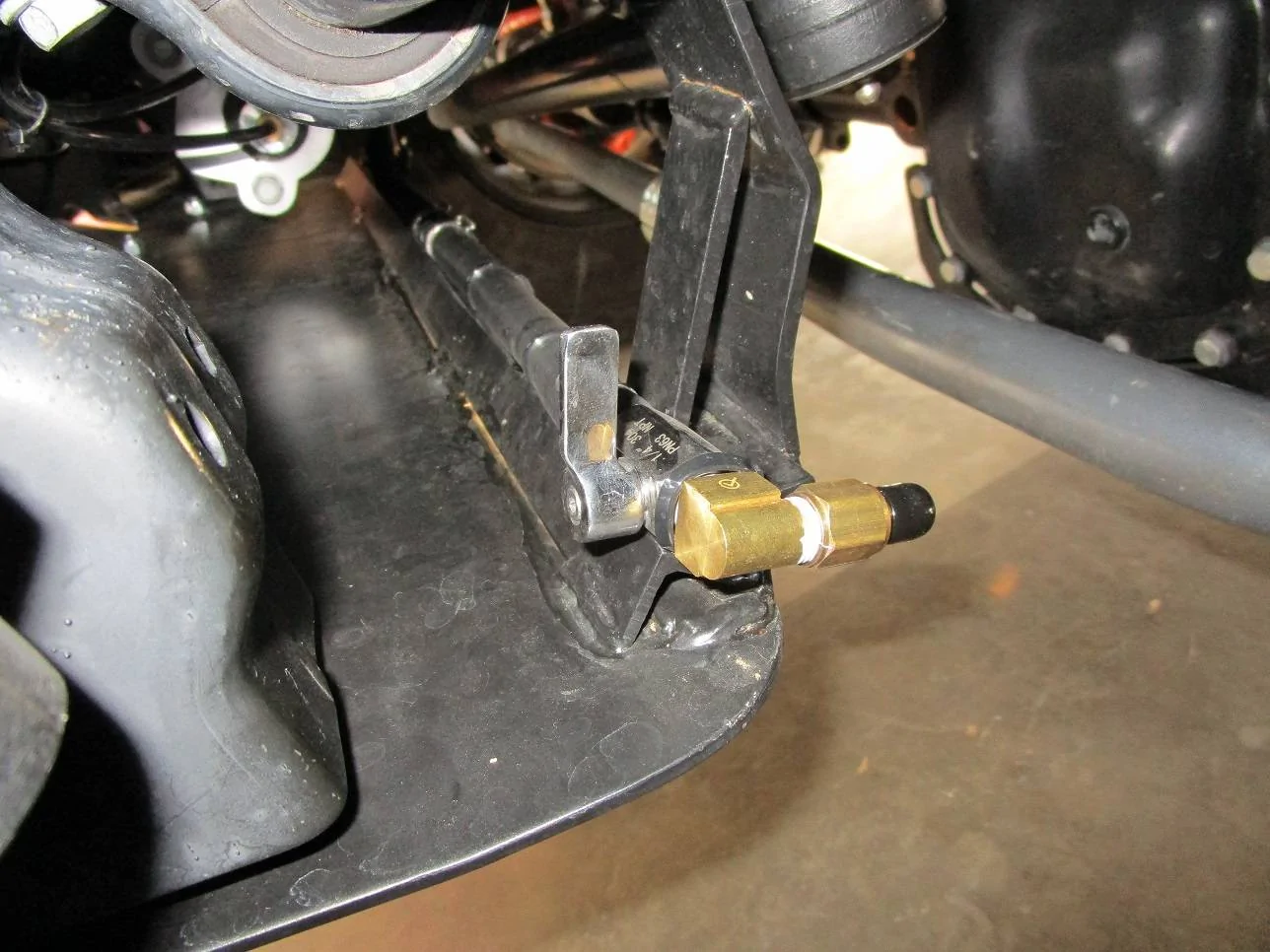

Here is what I did
Because of the Baxter adapter I had to make a bracket to remount the UPR up and away from the oil filter
The bracket is a piece flat stock bent at a 45 degrees at each end and held in place with the bolt that holds on the plastic motor cover
That gave me the room under the UPR to put a 90 degree fitting for the hose
The hose runs down the front of the motor and lays across my front bumper skid plate with a ball valve
The only time I have to move the UPR is to get better access to the oil filter
I used the UPR oil drain kit
https://www.uprproducts.com/upr-oil-catch-can-drain-line-kit/

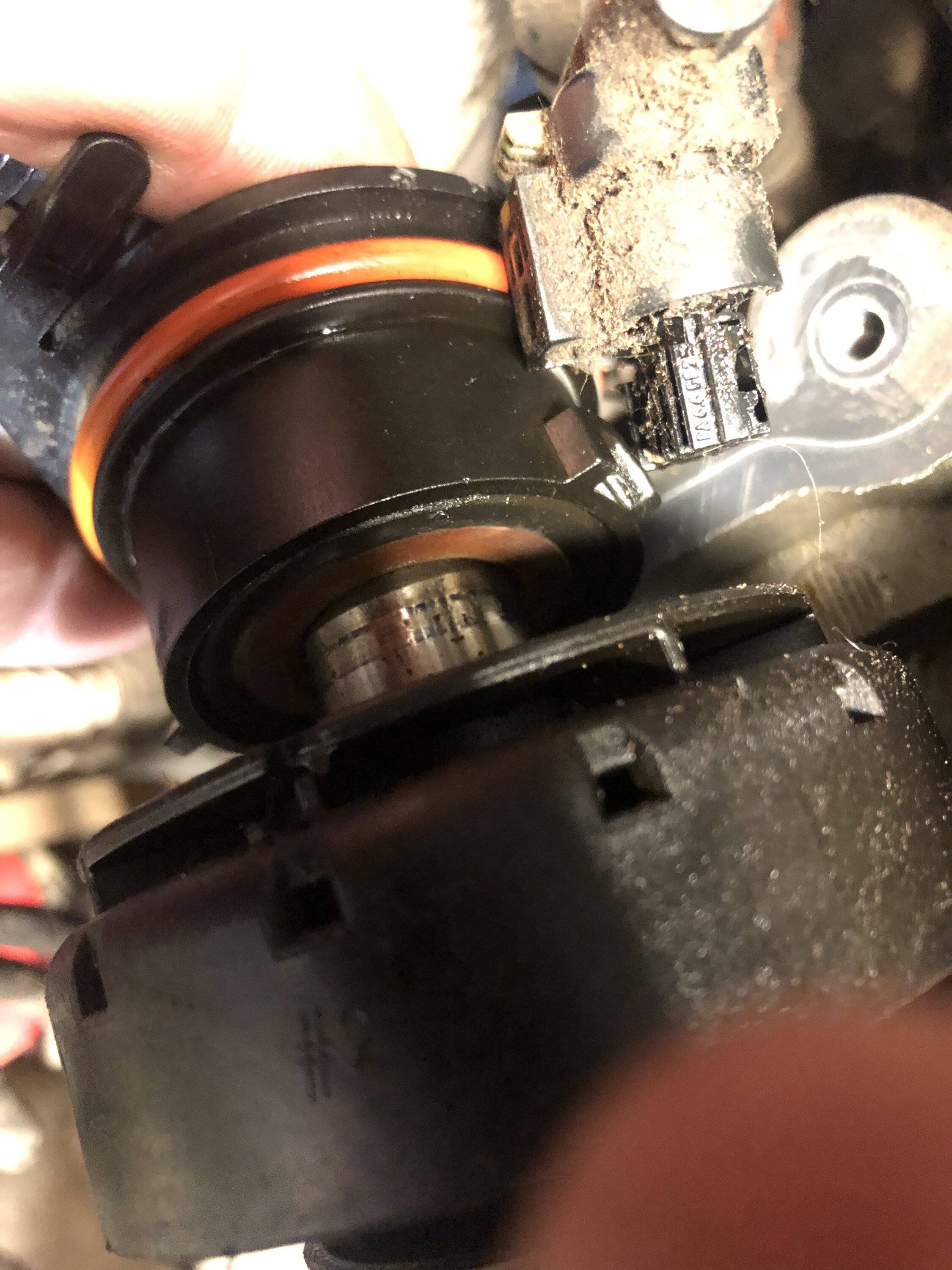

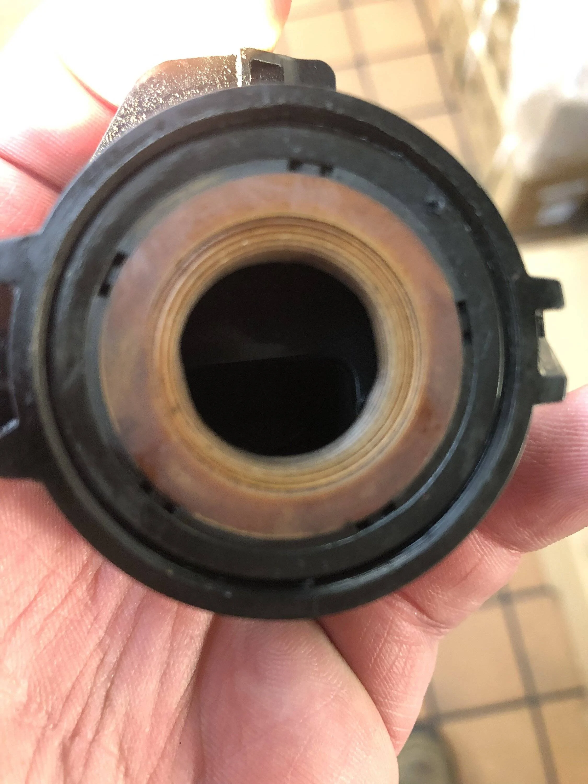

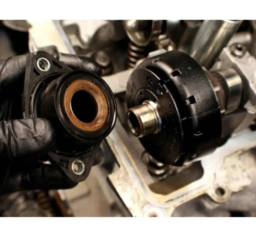

For those who care, I did some poking around while my brother had a 2018 JLU Sahara apart today, to see what changed about the PCV valve. The hole size difference we were all commenting on doesn’t actually exist.
The end stem on the camshaft that the pcv valve fits onto fits tightly into the pcv. The small hole on the new one actually stretches out around the camshaft when installed.
Jeep Wrangler JL New Version of PCV FFBDD4EB-50E7-4D9F-A2C6-532D51CCF1F0
Jeep Wrangler JL New Version of PCV 3BC657A0-F38D-48E4-B539-DF3FCBE6D501

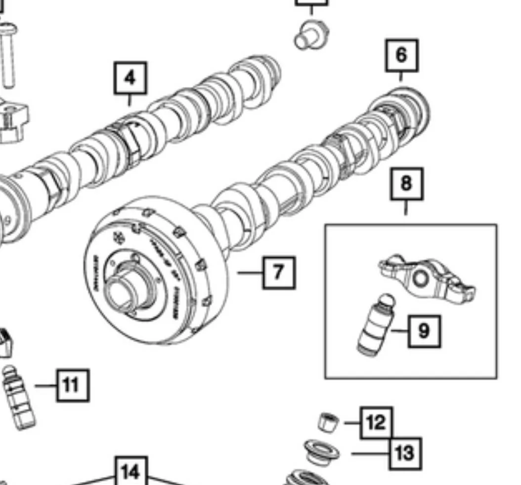

I haven't had an issue with mine yet but I was looking at the pcv system and it seams that every body is focused on the hole that actually is a seal that goes over the camshaft. Maybe is has more sealing area for the shaft end and thats where the oil was getting sucked in from, I'm not sure.
I haven't seen anybody open up the old pcv valve and the new one to compare the actual insides as well.

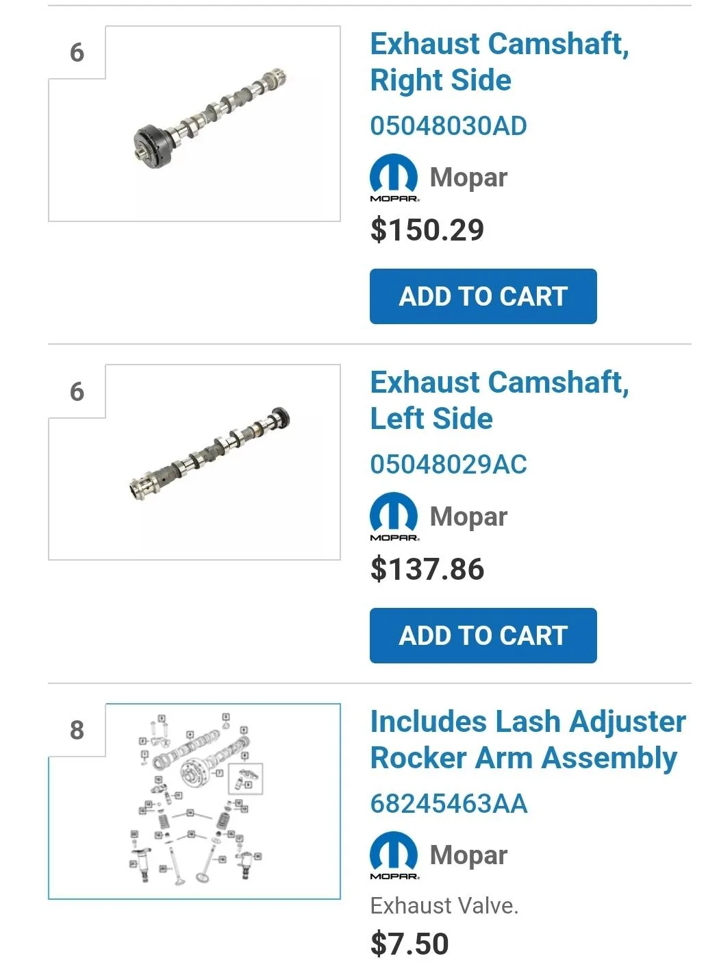

I found the pcv bolts to the cover and the hole goes to the end of the camshaft. I am trying to find out what the piece is on the end of camshaft but I cannot find any info at the moment. #7 is not listed on parts.

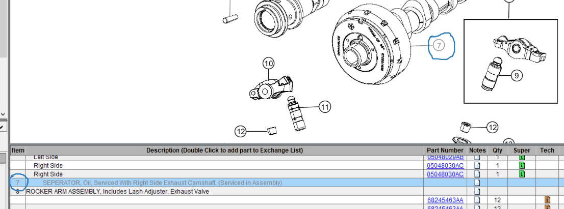

It's apparent the change in PCV's must be internal so unless someone starts cutting em up we wont know.
@mwilk012 is correct the separator is not serviced

Thanks for identifying what the part is and what it does guys.
I know the pcv valves are not readily available and I don't think someone will go ahead and cut one open to find out.

OK, so the million $ question is the smaller hole correct and perhaps the hole gets bigger when it's worn by the nub on the end of the camshaft?
