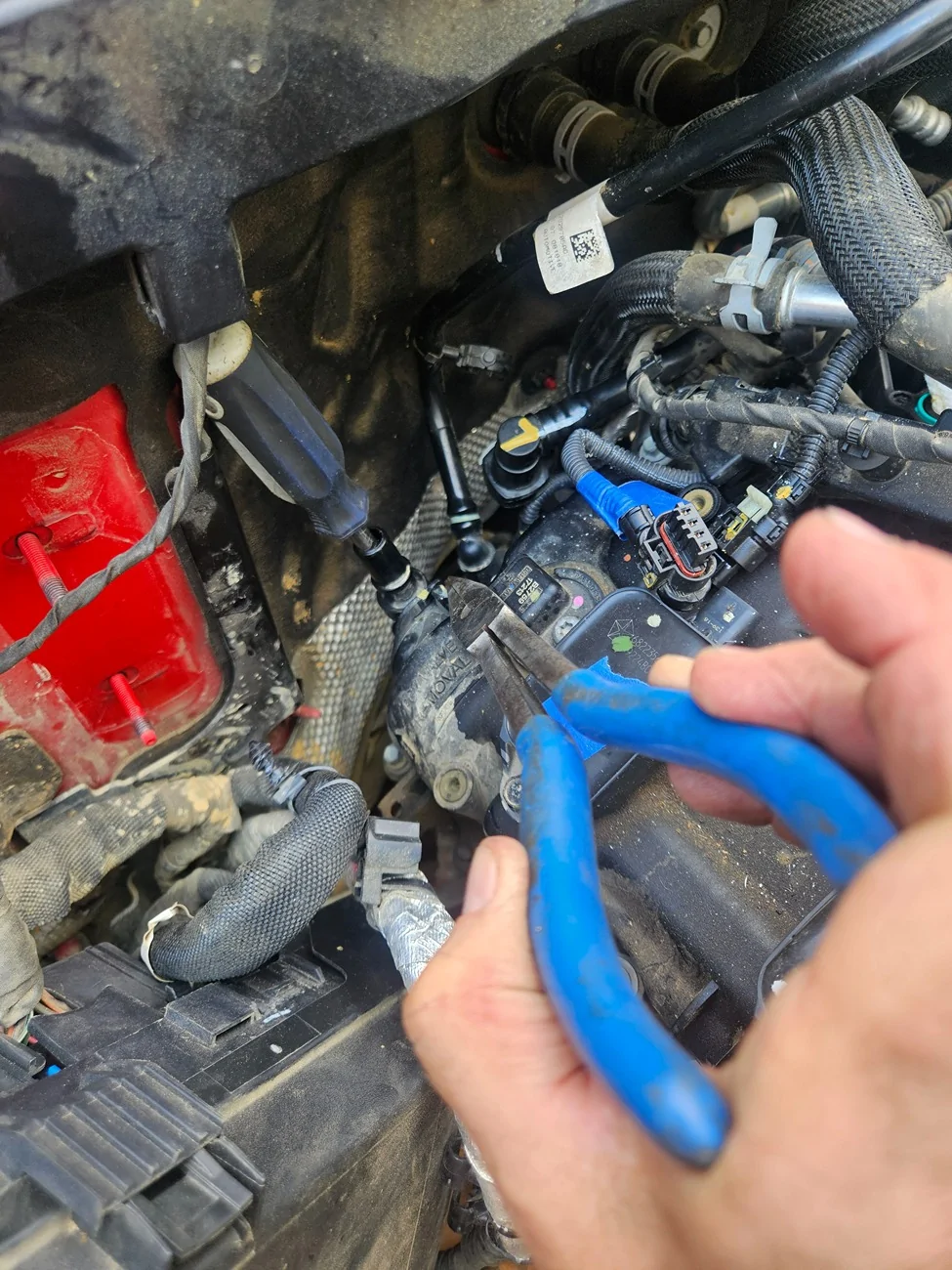

Thanks this helped me. Here's a pic.
I used a 1/4" nut driver to rotate it with a set of long nosed pliers to push the release tab

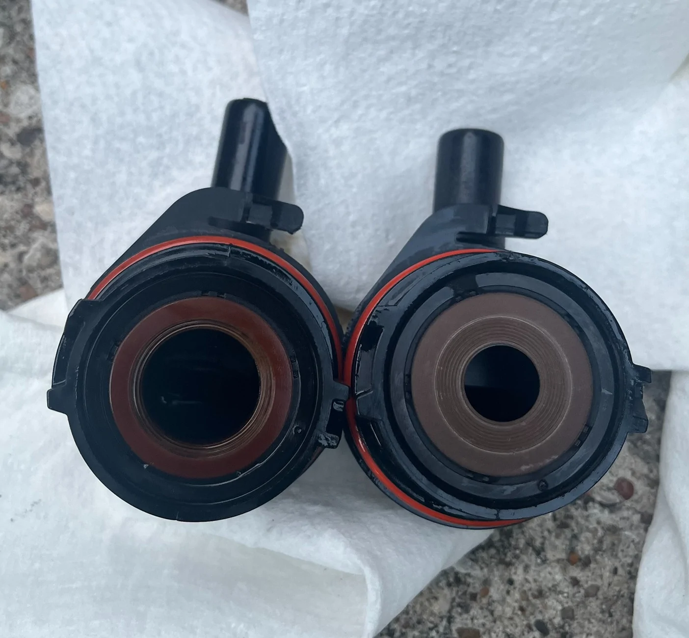

I just replaced my valve on a 2021 Rubicon JLU. The info here is spot on. To remove the old one, I detached the hose and then put a 16mm socket with a short extension on the nipple. Pushed the lock tab back with a large screwdriver, and rotated the valve with the extension towards the passenger side to remove. For installation of the new valve, rubbing oil on the gasket and the outside of the valve body is essential. If you look at the new part, you can see that one of the guide tabs is angular (see red box in attached image). Once you feel you have pushed the new valve in enough to pass the gasket into the block, rotate the nipple towards the driver side and the part will seat itself and the lock tab will engage. Then just reinstall the hose. Also attached is a comparison of the old, rather blown out valve, compared to the updated part. I never had a rough idle, but when changing the air filter I noticed oil in the feed hose and decided to swap the valve.
