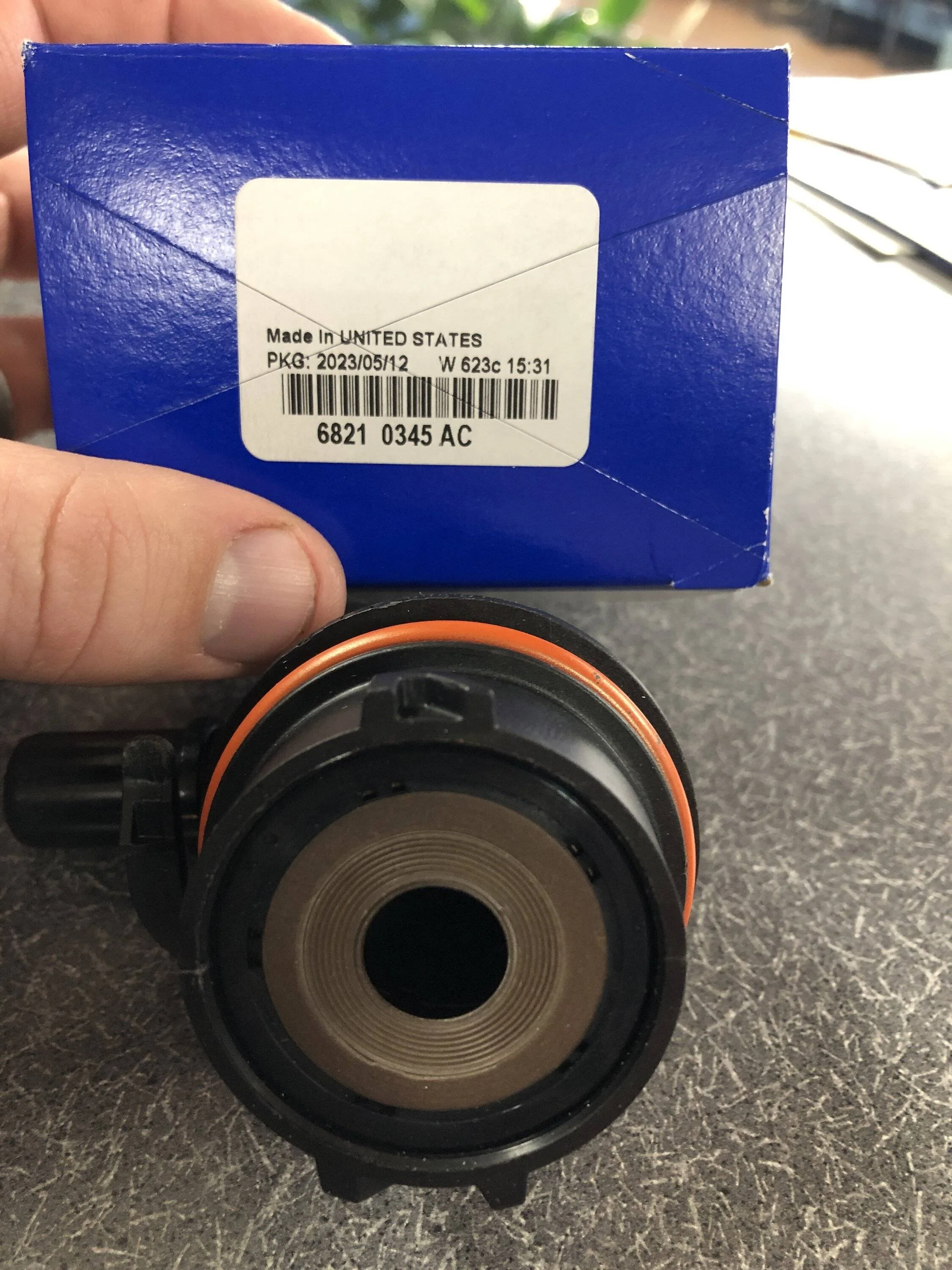

It’s hard to tell from a picture, but to me the big hole version looks broken. The concentric circles aren’t constant and disappear.
That's what I thought and my first post was just "that thing is broken" but I want to go in to the shop tomorrow and check before making a statement I can't back up.

No. its not broke
I just replaced mine today
On the left old one
On the right new updated one
I also emptied my oil catch can
I will check in a 1000 miles and see if it collects less oil

Which part number? There is nothing new about the -AC version, it has been around a while.

The new part no. on the box
68609110AA

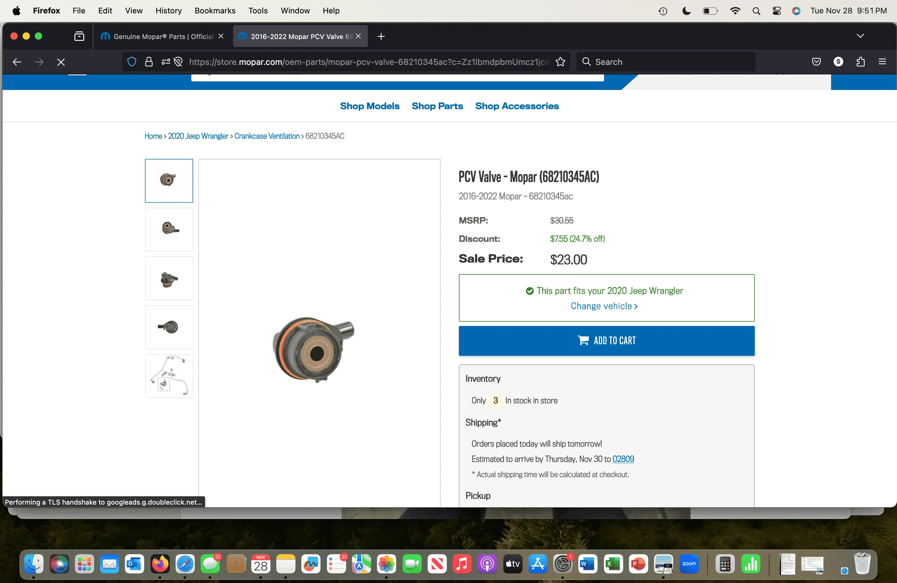

So, this is interesting. The new PCV I installed had the same part number as the original, 68210345AC, with the new having a smaller inlet. The inlet of the old one is not damaged, it's just larger. And, I just looked up the part number on the MOPAR page, and the part number for my vehicle remains at 68210345AC. I am still baffled that MOPAR would continue with the same part number when the part has been changed...
Jeep Wrangler JL New Version of PCV Screenshot 2023-11-28 at 9.51.38 PM
