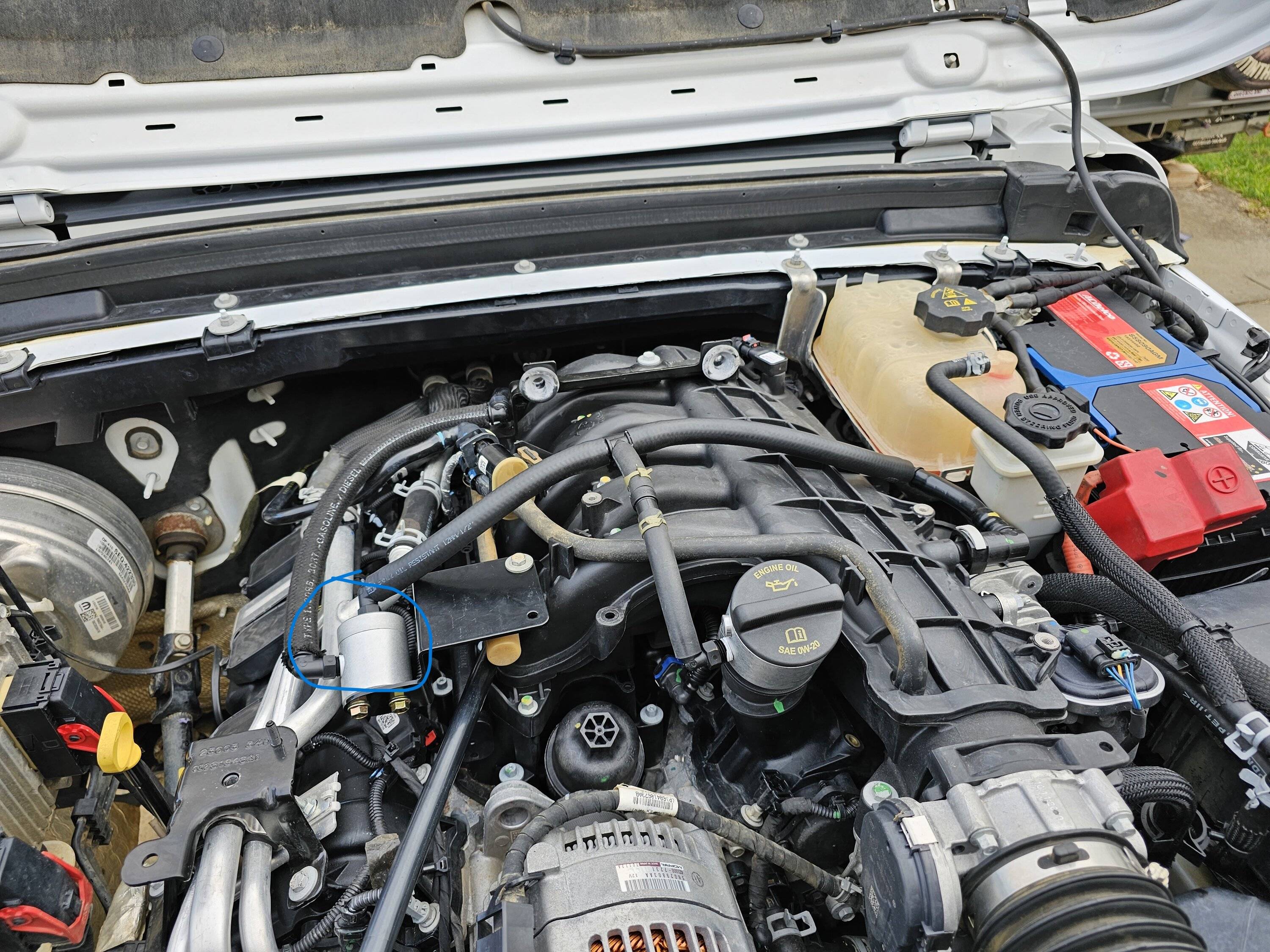

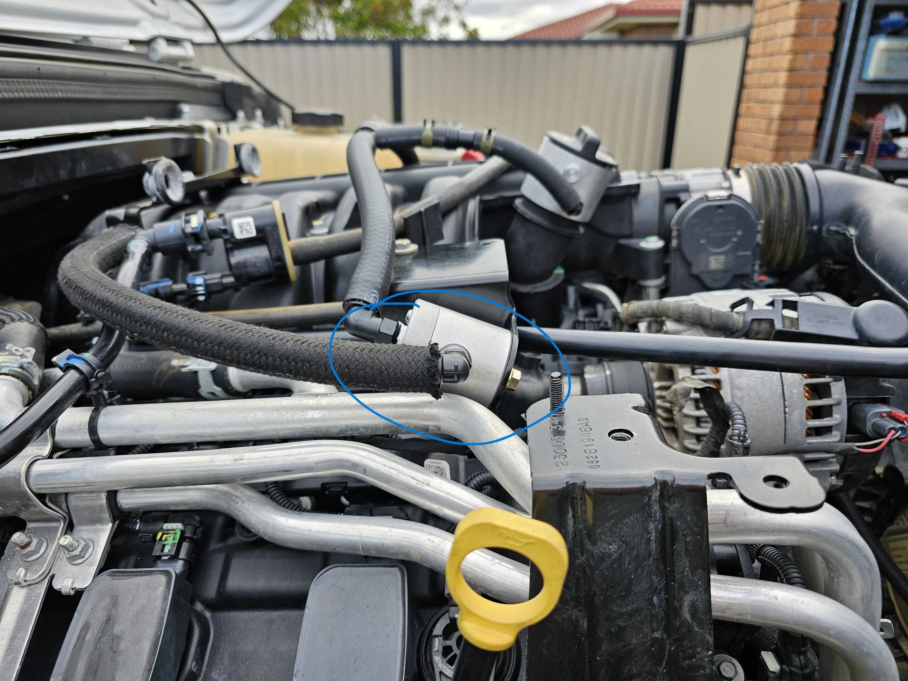

This is my RHD setup with the Teraflex kit. The circled part is the check valve. I do want to put a catch can inline to help with normal driving conditions unless the new PCV helps in those conditions.

I'm no expert on PCV systems here but I would question the size of the canister used here, If this accumulates any substantial amount of oil what is preventing it from getting sucked into the vacuum port rather than the oil fill housing. Also the angle of the canister would seem to make it worse at containing oil and when in an incline it would almost be horizontal.
Its very different in design than the can I linked to.
- Benny

That's not a catch can it's just the check valve. It's a metal ball in a channel, when level ground it's open, when on an angle (noise up) it moves to block this path.
I see therefore there is no reservoir at any point in the system. FCA denied your warranty claim with this system in place or another?
UPD catch can. I wasn't running this setup until my new motor, the Teraflex kit out of the box doesn't mount into RHD. You can read the full report here
