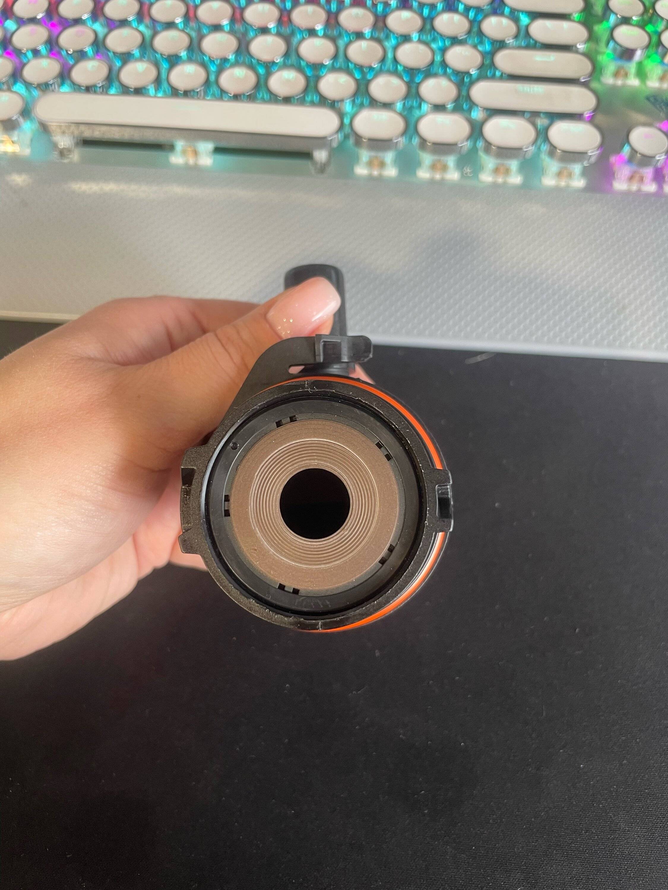

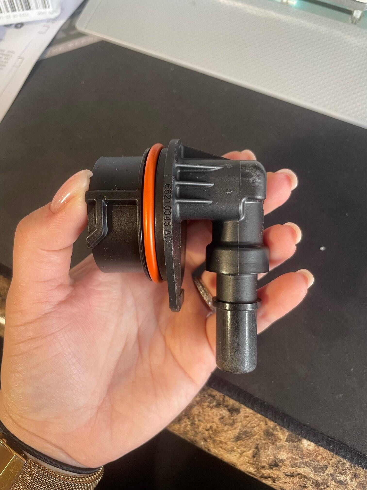

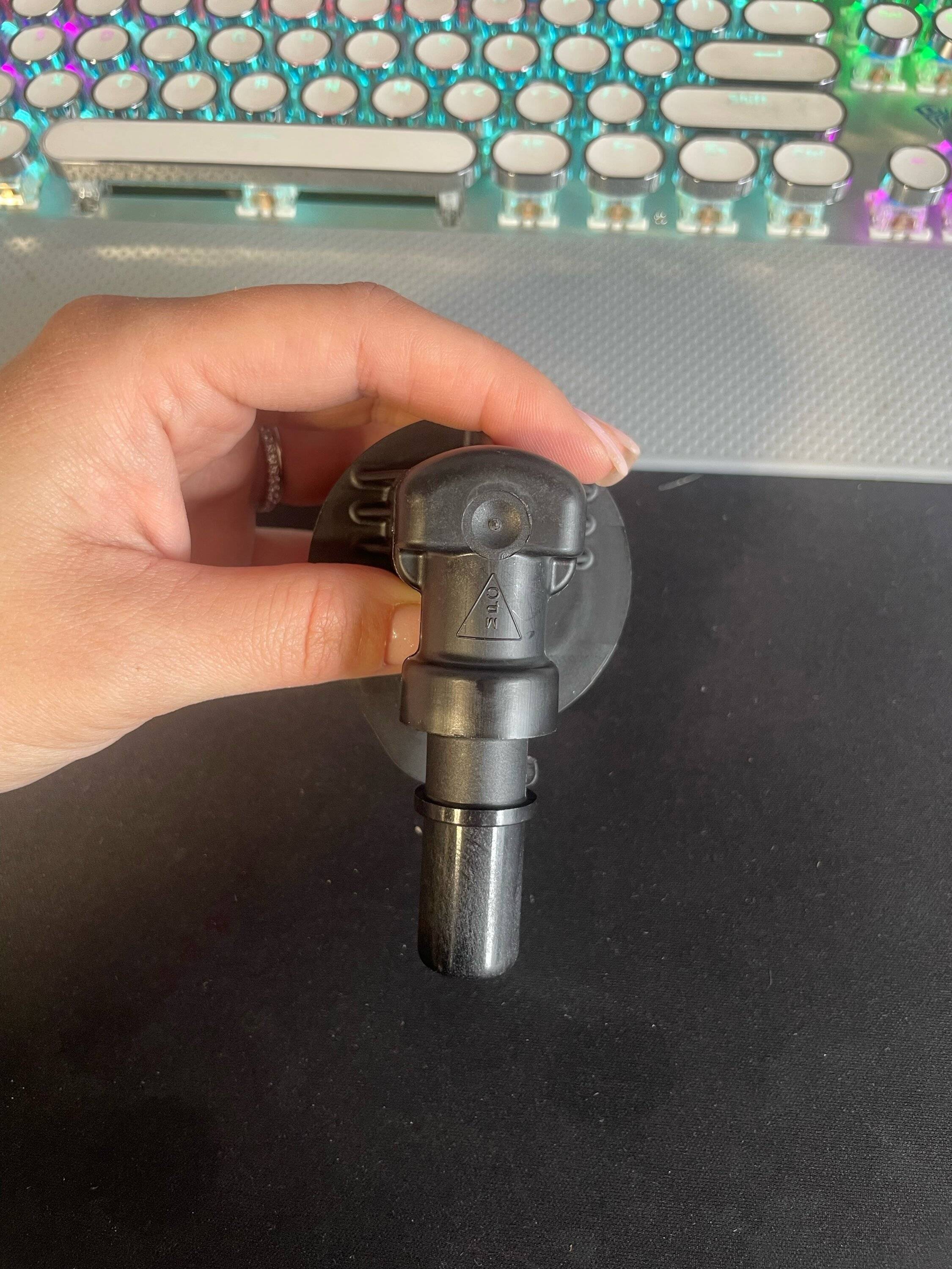

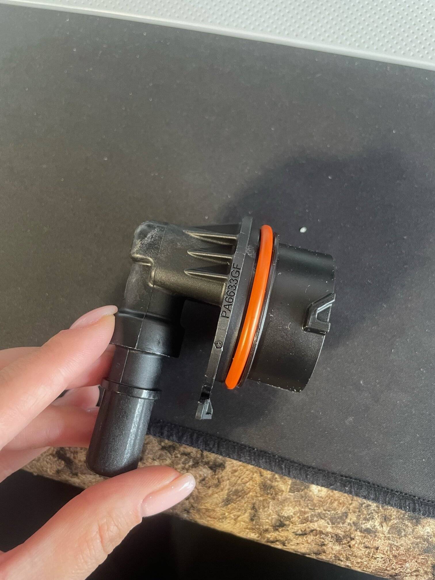

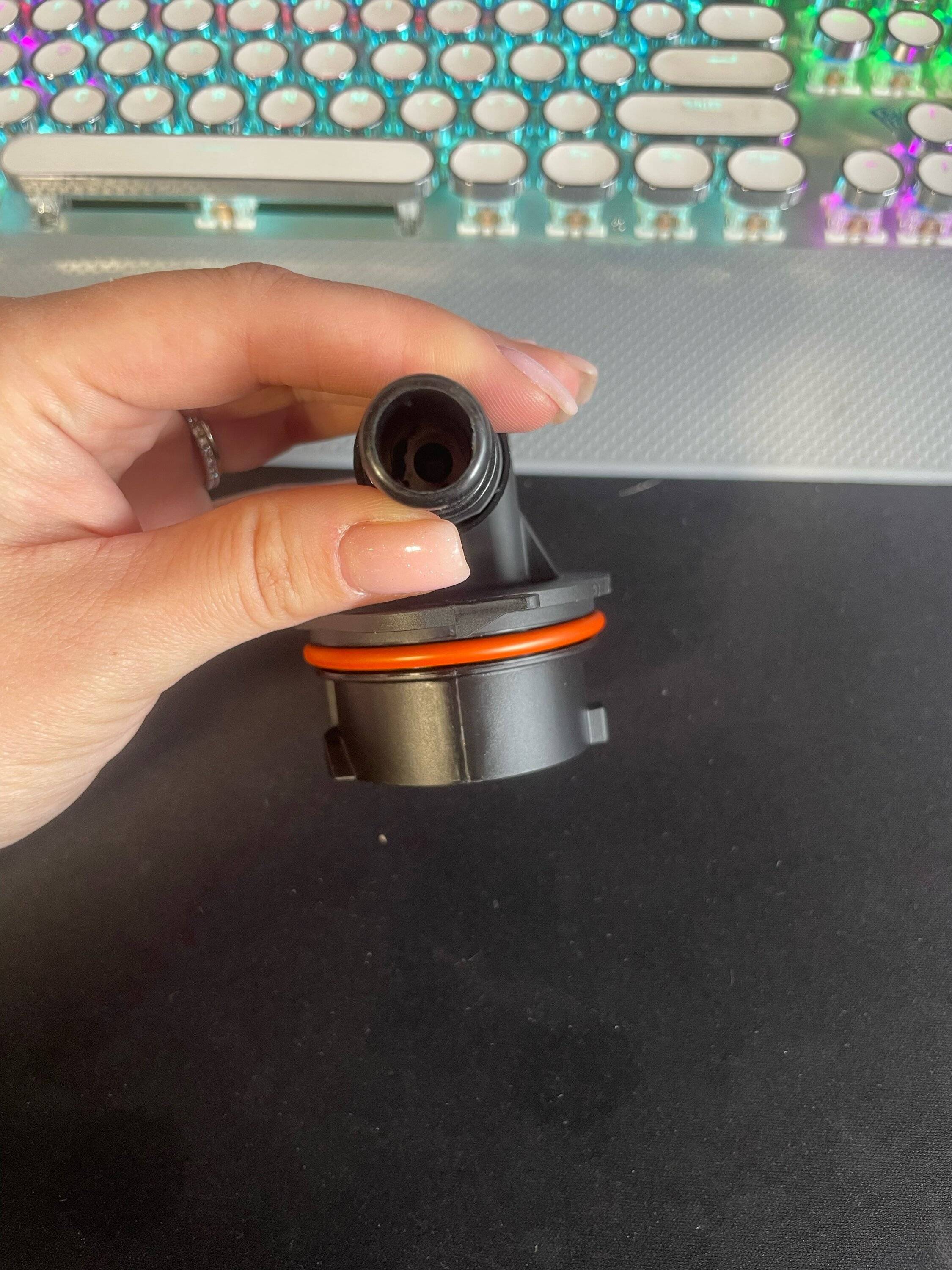

Curious how it goes. I found this thread and looks like the discussion ended 3 weeks ago. Are we able to order 68609110AA?
I was able to get photos of one from our sister store as they are becoming very hard to get, Mopar is limiting the qty's they ship to each dealer per week.
The valve is still stamped with the old number and physically appears to be the same (to me). We do not know what internal changes may have been made. Here are photos

The diameter of the inlet opening of this PCV is the same as the new PCV I recently purchased from Jeep. It, however, does carry the same part number I found on the original in my 2020 Wrangler. Perhaps it will be an improvement given the more restrictive opening, but I am stymied that both old and new have the same P/N.

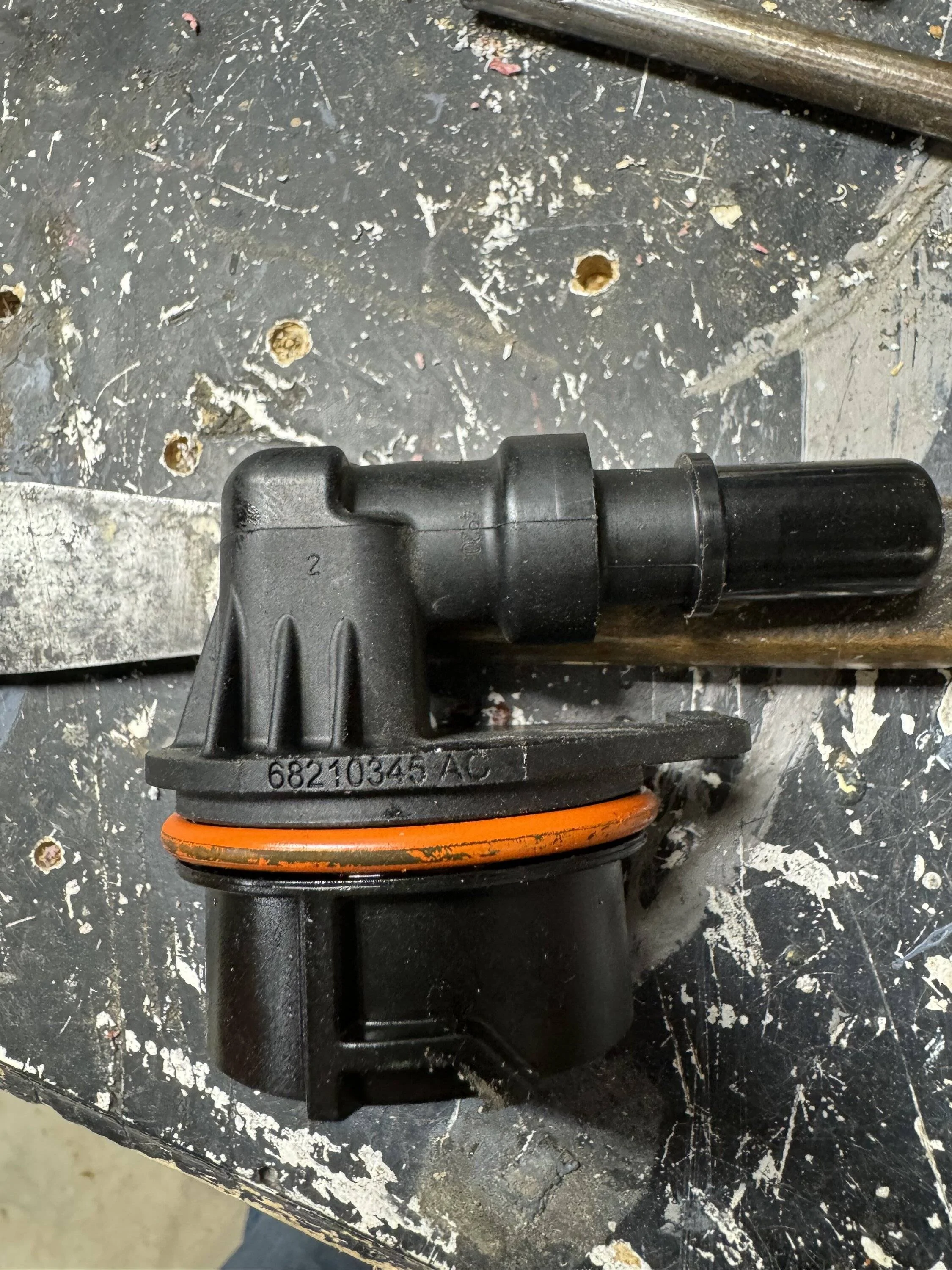

Jeep Wrangler JL New Version of PCV IMG_0495
If it has the same part number, then it isn't different.

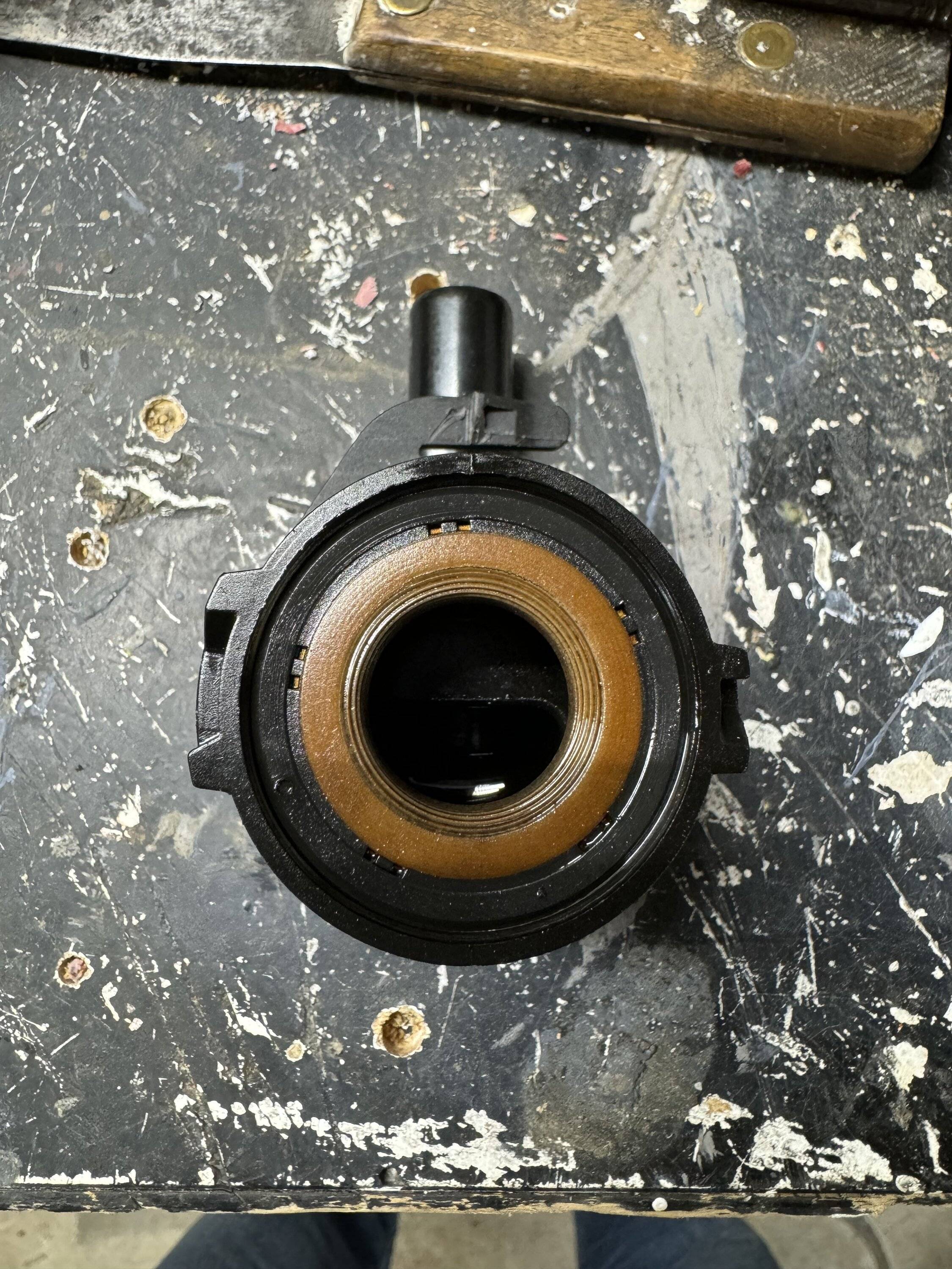

The original PCV has the same P/N as the replacement, but as you can see it is different. The inlet opening in the original is significantly larger
Oh, the stamping is wrong, right?
What I think Stellantis did, out of laziness for not wanting to change their tech manuals and parts catalog, was to keep the same PCV part number but "improve" the PCV to restrict the flow of oil into the combustion chamber. Seems like Srtellantis is always taking shortcuts; witness the "new" clutch system under the recall. They are still using a software program to de-power the 3.6 in the event of excessive heat generated by the clutch. To my knowledge, no other automaker has ever used software to restrict engine power due to an overheated clutch. Their clutch system is, simply put, a dangerously defective design. Sorry for the rant...

No, it has a new part number, that doesn't match the stamping.
How sure are we that the big hole version isn't broken? I haven't stared at one long enough to say for sure. I have one on my desk at work for a GC, I'll check in the morning.
It’s hard to tell from a picture, but to me the big hole version looks broken. The concentric circles aren’t constant and disappear.
