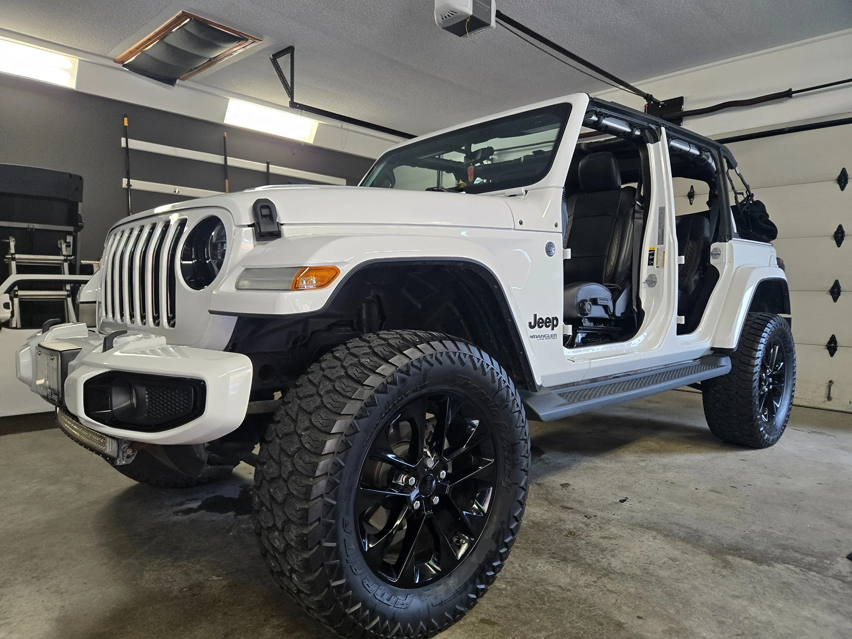

Hey everyone, im looking too maybe upgrade from 35s to 37s on my 21 wrangler high altitude 3.6, i have a 2.5 lift in it currently with the factory 20inch wheels and 1.5 inch spacers. Space wise it appears that the 37s will fit however I've seen some comments regarding the need for a regear to run the 37s and that the 3.6 would struggle. im not sure if thats accurate info or necessary too regear
Jeep Wrangler JL Need some advice on 37's......... 20250621_144226
? Any advice on this from anyone who is running a similar setup or has some experience with it.

It would be highly advised to regear or axle swap to run 37s on a Sahara. It'll literally go, but it wont be pleasant. I personally found axles out of a 392 with 4.56 gears and swapped those in.

If it feels ok with the 35s, moving to 37s will not feel that much different. That said, and as mentioned above, going to a numerically higher ratio will be an improvement. If you do it, I would recommend 4.88. As far as 37s on a Sahara with a 2.5" lift, it will be fine for street driving but will probably rub at full flex on a trail.

Pulled this info form the building sheet if this helps at all
8-SPD AUTO 850RE TRANS (MAKE)
DANA M210 WIDE HD TUBE FRONT AXLE
3.73 REAR AXLE RATIO
DANA M220 WIDE REAR AXLE
3.6L V6 24V VVT ETORQUE ENGINE UPG
? Any advice on this from anyone who os running a similar setup or has some experience with it.
Thanks everyone

I have the factory 4.56 gears with the auto trans and some true to size 37s and the gearing is good enough that I’m not willing to switch it. You’ll have to decide if you are willing to tolerate the 3.73 gearing for your actual use case. You don’t say how the vehicle is actually used, but 4.88s and 17 inch wheels if you do any actual offroading is good advice.

Try the 37s and see how you like it. Worst case, regear it. I would keep your axles since you basically have rubicon axles. Just need a regear maybe.
And if you want lockers, throw those in while youre in there. At least a rear locker, or a truetrac
Its more if a pavement princess , 10mile commuter occasional 150mile round trip vehicle. Is the change in gearing to keep the jeep more in the power and drivable or?
Yes it will be outside of its optimal power band, so the engine works harder, the Jeep feels more sluggish and you get worse gas mileage. Just as a loose example, if a Jeep from the factory is on 33s and has 3.73 gearing, going to 37s would make the effective gearing closer to 3.33.
As @Sportacus said, try it.
