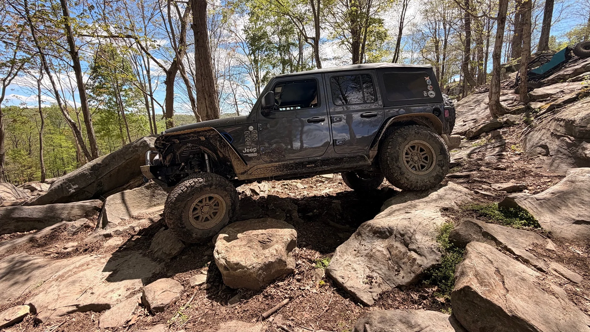

I’m running small and light 37’s (BFG KO2’s) with 3.73 gears and a 3.6. I wheel it and daily drive it. What I notice…I make sure to watch the oil temp because I think it gets warmer than regular. I will regear. But I also do everything I want with it.

So I had falkin wildpeaks in a 315x12.5x17 and they were around 73lbs per tire. I overheated on a cross country trip to Moab with those (oil temps got to around 250+ and I pulled over). No issues after that however, I became paranoid after that experience.
I went with the KO2’s because they are c rated and weigh roughly 64lbs per tire. So 9 lbs drop in weight per corner (even though rolling mass/bigger tire is more).
Since overheating that one time with my 315’s I’ve always watched my oil temps. The temps I’m getting are both on road and off roading. My oil temps will creep up to 217/219 and I’ll hit my AC for my fan to turn on and bring the temps down. I know the 3.6 fan kicks on by itself at 226 but I don’t want to get into a spot where my motor is just a constant 226 (I don’t have data to back it up but I’m guessing one of the reasons these 3.6’s fail is because they run hot and people just assume the factory settings are fine which in turn wears out motor components faster).
The reason I say runs warmer is I’ve run with a buddy who has a 2020 rubicon gladiator on 35’s MT’s (don’t remember brand). While driving down the highway, backroads, and wheeling, I’ve asked him his oil temps and they were pretty consistently 10 degrees Fahrenheit lower than mine in all conditions. My Dad has a 2 door rubicon (2.0 motor, 33” tires) and I had the same experience (10 degrees). So that is why I say it runs warmer. I negate this by being hawkish about monitoring my oil temps and prematurely kicking on the fan instead of letting the computer do it.
I know that was long winded but hopefully it helped.

I agree with this right here…spot on. Even when I went from 315’s e rated to 37’s c rated (ko2) the difference was night and day. Such a better ride quality and I’m still getting between 17.5-18.5 mpg….but I do drive like an old man when I’m not off roading lol
