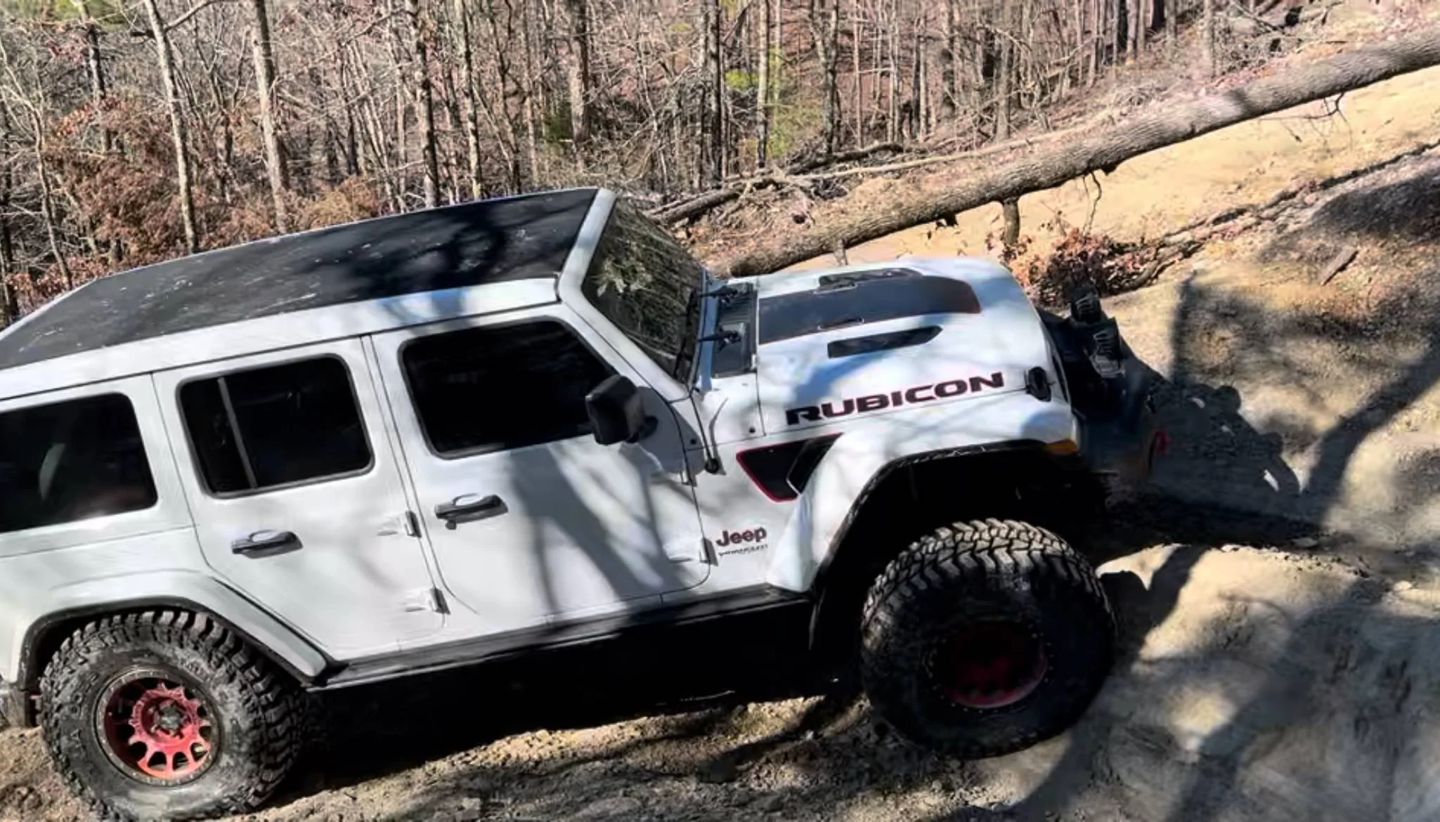

Why are we not posting pics with our comments? Everyone want to see a diesel on 37s!
I went 35s because I wasn’t ready for a lift and rims. I agree 37s seem to be the sweet spot. I lost a couple mpg just moving to 35s but don’t feel it in the pedal at all.

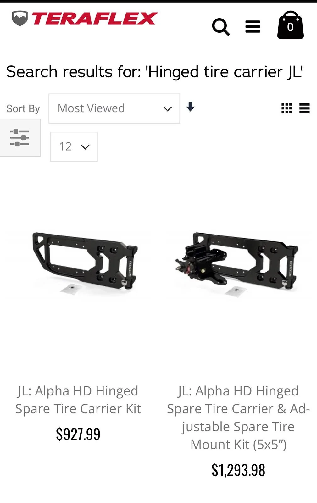

2.5” lift, went to 37”s and they rub the fender liners when off-road. This is after adding 1/2” of front bump (diesels start with 1-3/8” more front bump to begin with). Rear also rubs with 2” of added bump.
Live in TX (low altitude,hot), see 8th gear often enough, can get ~22mpg on freeway with cruise set a few miles under the 75 limit. Have not regeared, don’t plan to.
You’ll need to an aftermarket spare tire carrier to clear the bumper unless you’re one for doing a spare delete.
Jeep Wrangler JL 35" vs 37" - Need some advice! IMG_2061
Video of tire rub:
Edit: things I’d do differently plan to add another 1/2” of bump front and rear. Should have gotten Teraflex hinge gate AND carrier (on right) instead of just the carrier. Plan to add the hinges (on left) soon.

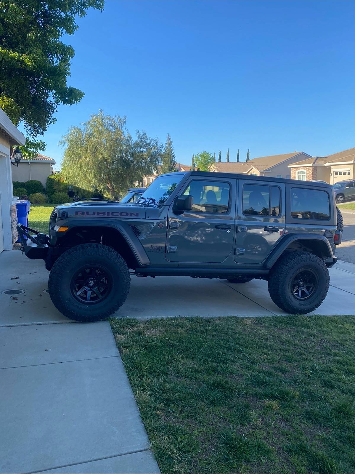

You are absolutely correct. How dare I err in such a blasphemous way!
Jeep Wrangler JL 35" vs 37" - Need some advice! IMG_2816
I lost more than a few going to 37s. Regearing would help, but as I want to go 4.56s, that might cost more than I gain. Either way, I won’t be regearing for quite a while.. unless I feel I *need* it.

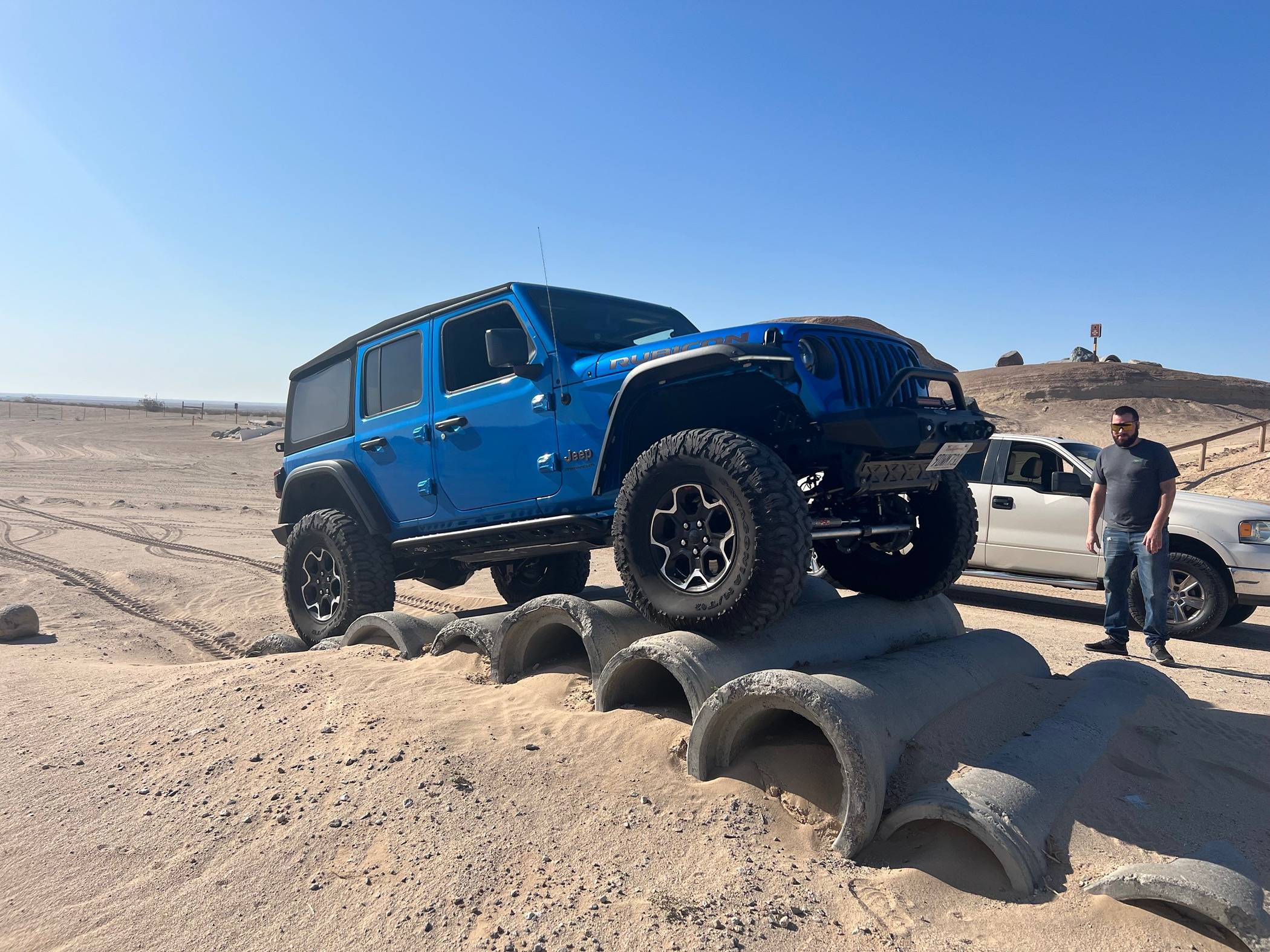

On my recent wheeling trip, the guy I went with and I both had 37s. There was a noticeable difference with the ease of his steering with hydro assist, opposed to my stock steering. Still, reasons I didn't upgrade anything to go to 37s... I got the XR package. That means a Dana HD 44 up front, which has a thicker axle tubing and steel knuckles from the factory. Stock 4:56 gears. The bumpstops it came with were practicality made for 37s. Also the mopar tailgate reinforcement. These are all things I would have considered upgrading if it didn't come upgraded from a standard Rubi already.
That being said, people throw 37s on JLs without those upgrades and wheel them all day long.

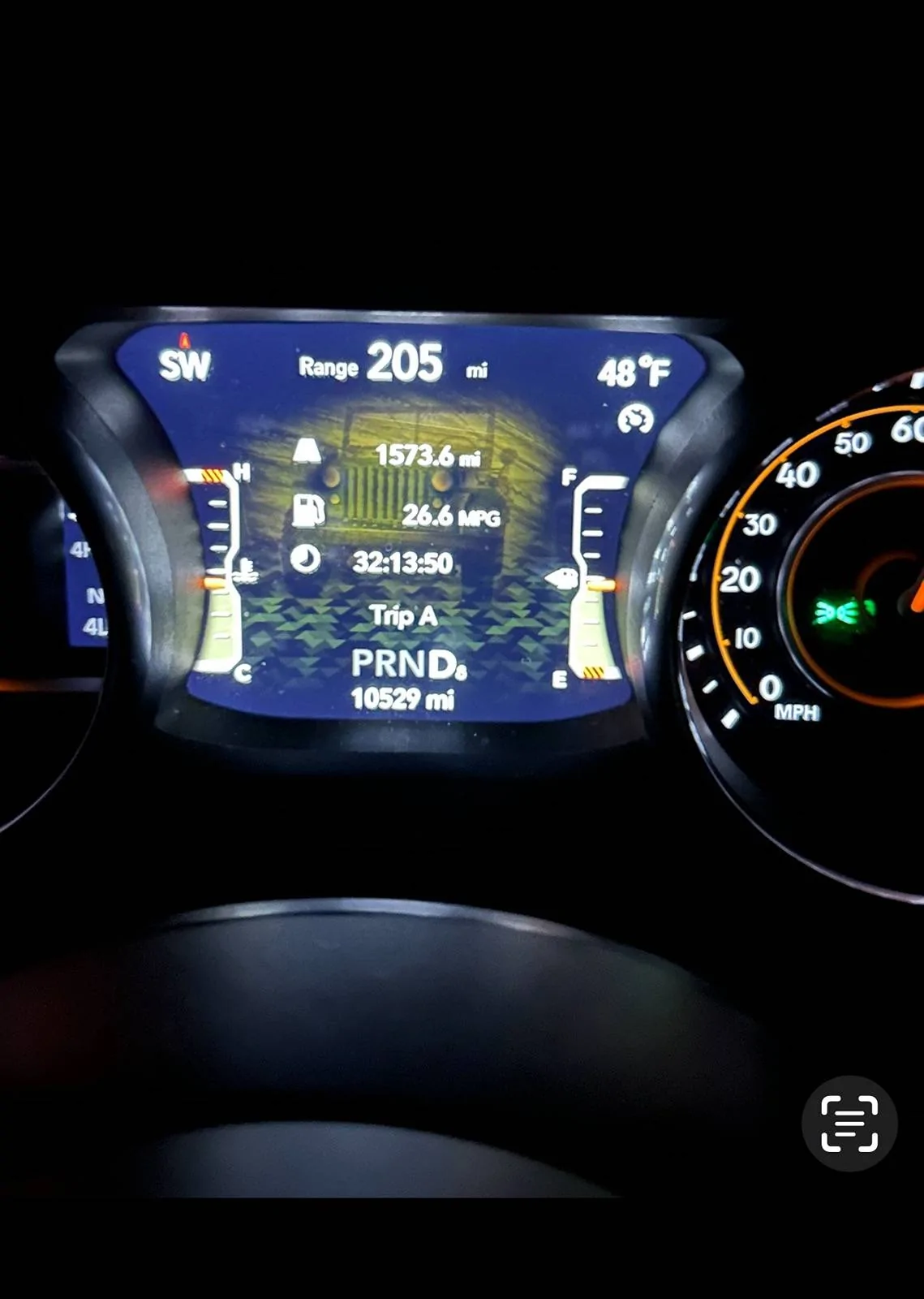

How!? Are you tuned? Going downhill all the time? How are you getting this kind of mileage?
I don’t know. It doesn’t use much def either. I drive fast everywhere I go. 85 mph through Nevada and I was getting 22 mpg
Ryan long
Ryan
Dec 27, 2023
23 wrangler rubicon eco diesel. 65 cj5 5.3 ls
I bought it new. It’s not tuned. I recalibrated the Speedo and muffler delete that’s it
