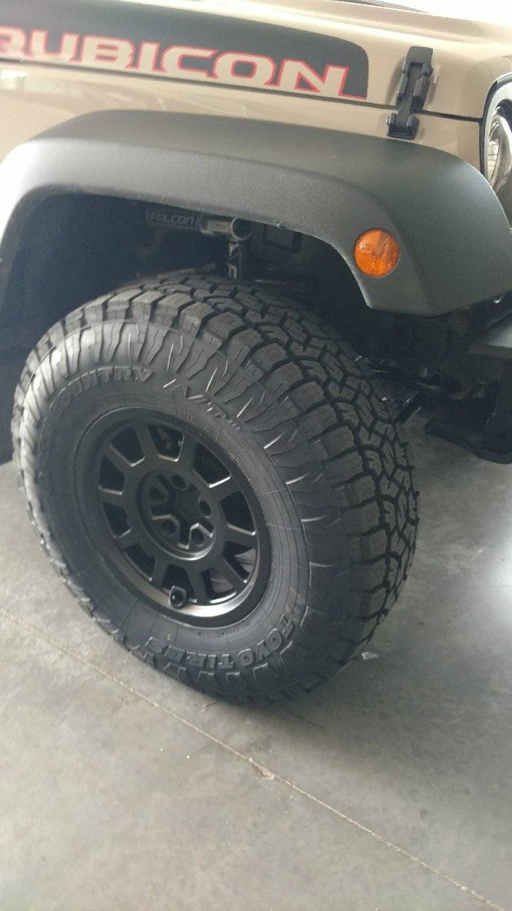

my only issues with the Toyo at3 in 35x11.5-17 is they were a bit short and did have a stupid howl at highway speed. great tires otherwise. I ran the Toyo RT in 35/12.5-17 at the same time and they were actually quieter and a bit taller..also great tires....fuggg I have spent a lot of money on tires over the years lol
Jeep Wrangler JL 35 vs 37 jeep willys IMG_20200728_163240913_TOP
