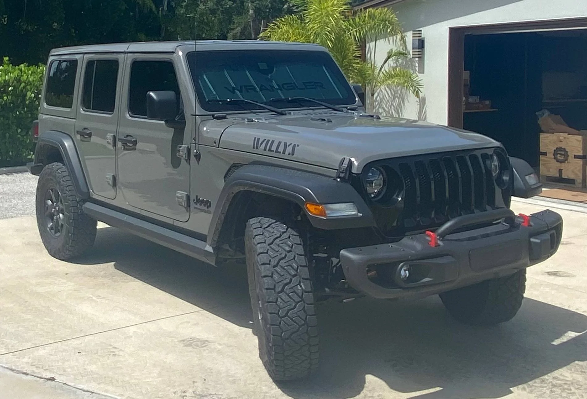

Yep- but 5 lbs heavier for 11.50’s. I ran the Toyo’s on stock 7.5” wheels without issue (DT did mount) waiting for back ordered 8.5’s for 7 months 🤨. Rotational mass is not his friend trying to run 35’s. I have seen 285/75/C at 34” with 3.45’s, they look much bigger than 33’s from the pics posted…. (OP hint 😁)
But the Nittos look so good

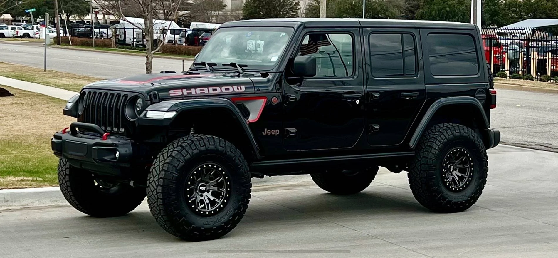

Are these 35's? or 33s? ngl if these are 35's its tempting me more to go to 37's
You may have rubbing with only a 2.5” spacer lift on Willys. My Sport S had a mopar lift that gave me about 3.5” of lift and I still swapped out flares to Rubicon flares to have best fit for 37s. Rubi flares are about 1.5” taller.

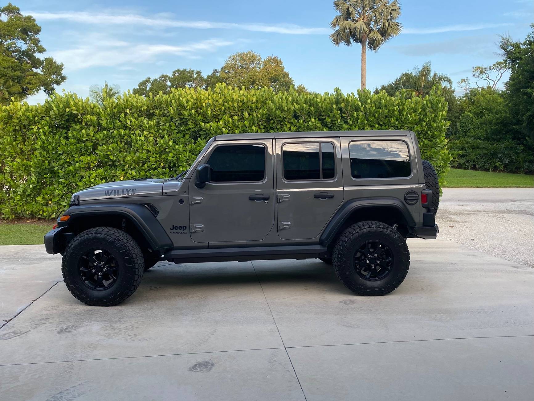

35” w/ the Mopar 2” lift that actually give 3”+ lift
Sorry one more thing Are those 35x12.50? or 35x11.50, I dont know why maybe im tripping but the tires look so small for a 35, maybe its just the angle of photos.
It’s the lift. LOL. The pics don’t do it Justice.
35 x 11.5. Here is before & after

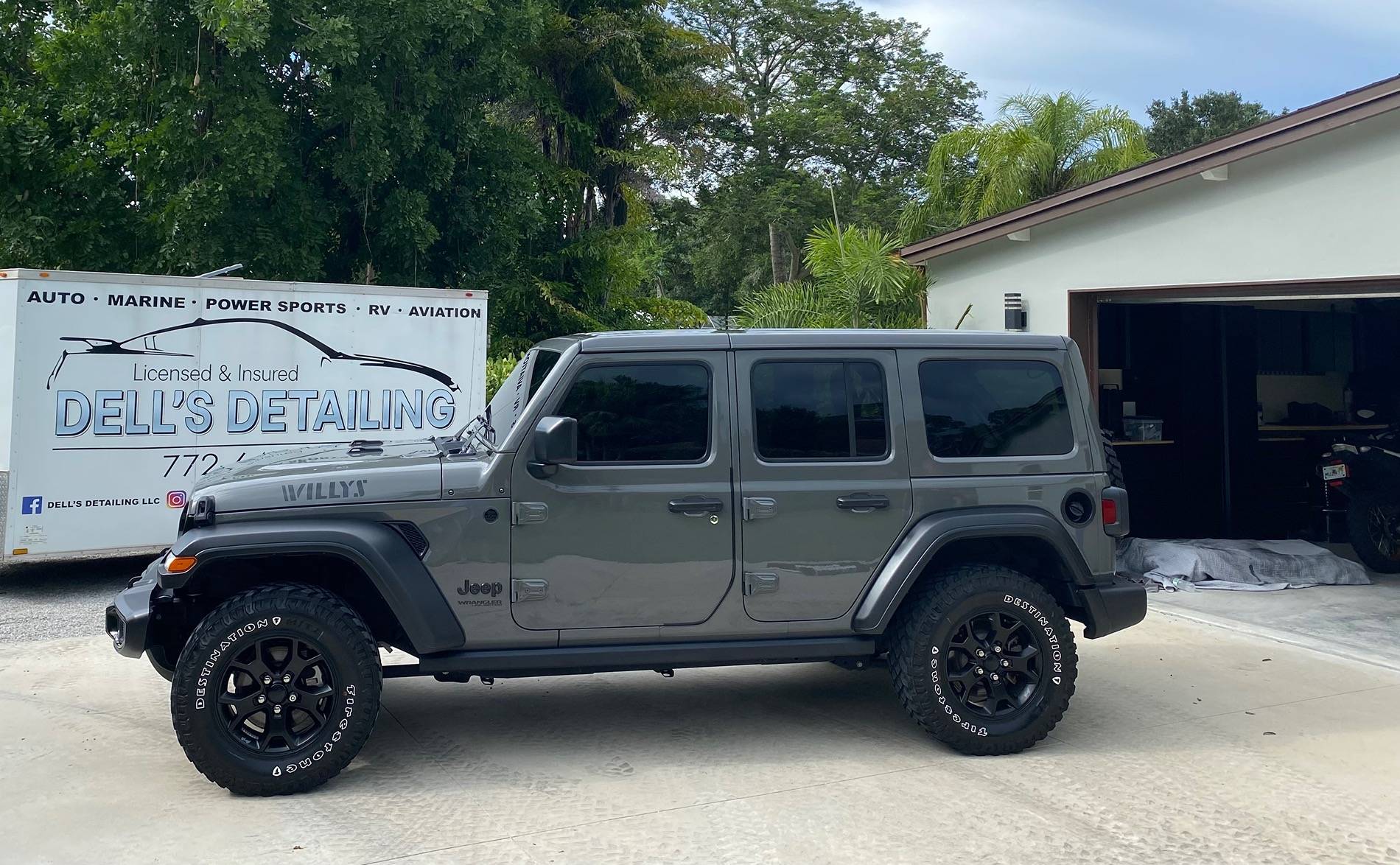

Willys 32”
Jeep Wrangler JL 35 vs 37 jeep willys IMG_1306

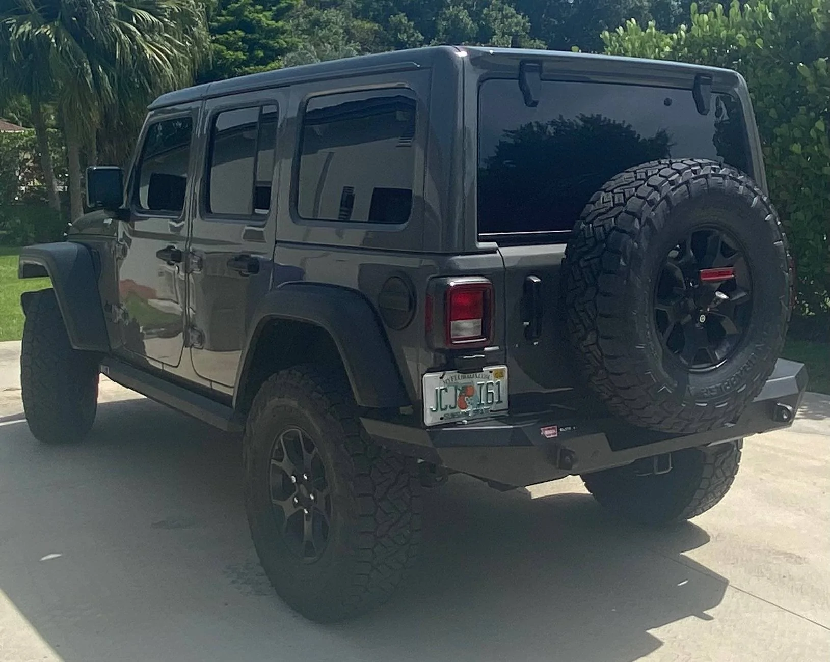

And with the Mopar lift and 35”
Jeep Wrangler JL 35 vs 37 jeep willys IMG_1761
