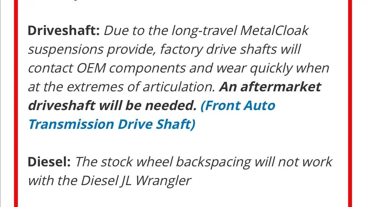

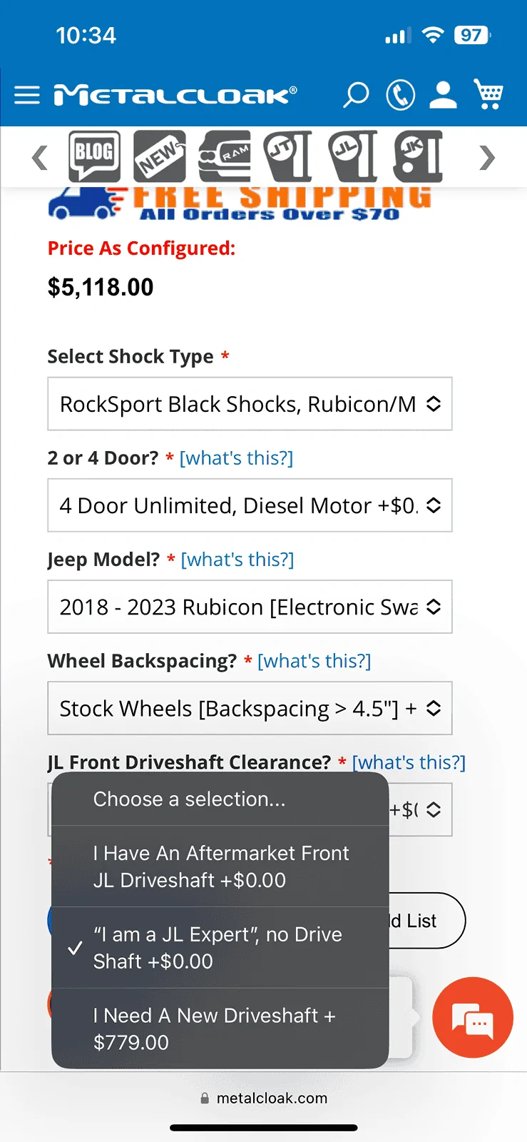

Yeah, MetalCloak will sell you a kit without the driveshaft, but that option is labeled “I’m a JL expert; no driveshaft”. Which I believe was written in a fairly sarcastic tone.
This is what you get when ordering a 2.5” gamechanger (mid-arm) kit.
Jeep Wrangler JL 35" vs 37" - Need some advice! IMG_7896
Their rationale: Stock driveshaft will contact other components when flexed out and wear quickly. They also point out that the stock backspacing on the JLURD wheels won’t work, and a different wheel is advised.

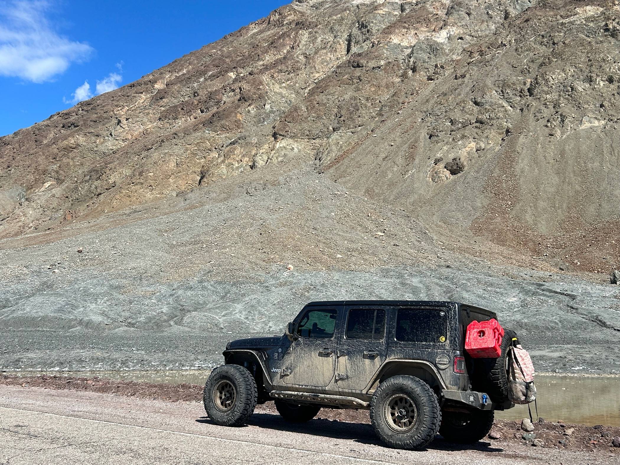

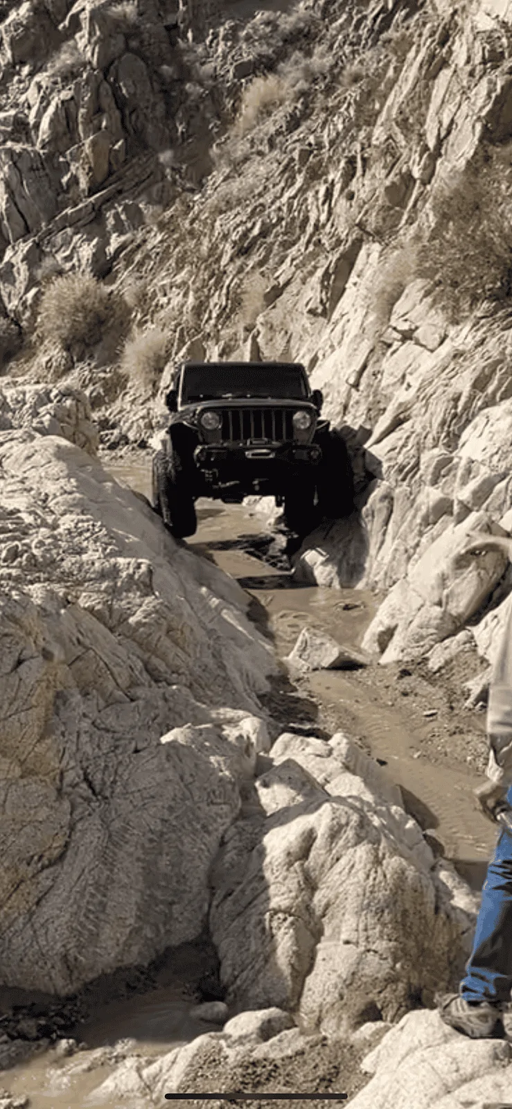

No issues in the Dana 44 axles so far. I have not trussed the axle or upgraded the C’s. Year into 37’s on the Jeep and wouldn’t go back to 35’s or smaller. 37 is a sweet spot for on and off road manners. I do run moderate to hard trails. I also run overland gear for multi day trips which has me running on the heavy side. But I keep the trails to easy to moderate when loaded down. It all comes down to driver pedal control.
Jeep Wrangler JL 35" vs 37" - Need some advice! IMG_0512
Jeep Wrangler JL 35" vs 37" - Need some advice! IMG_0216
