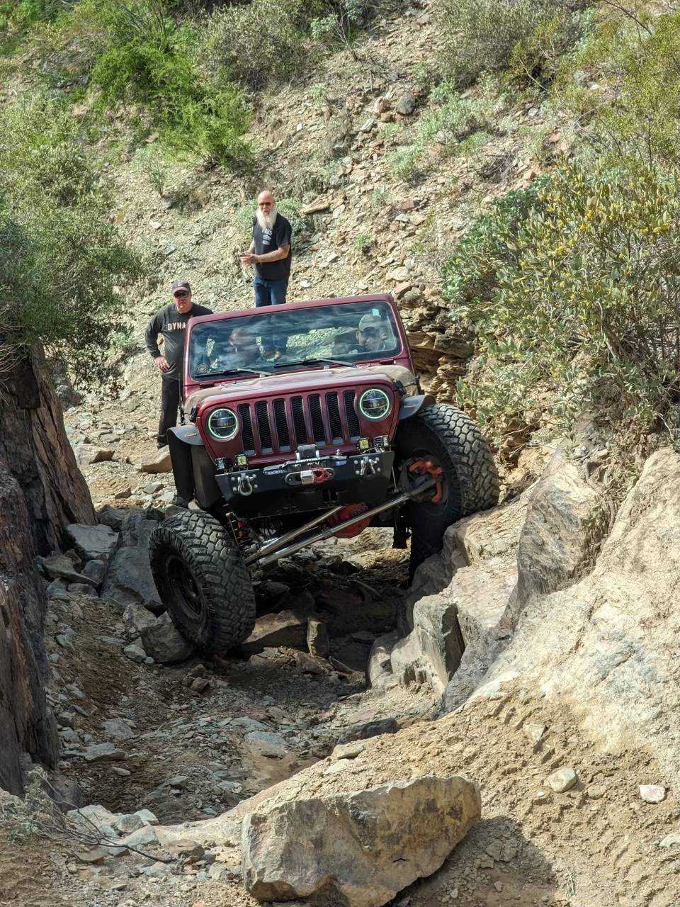

I think it really depends what you want to do. The first pic is on 38's with 3 1/2 MC lift, trussed, gusset, 2 ton steering, apex hd ball joints , Reid knuckles, PSC Hydro assist ( which is the best upgrade you will ever do)
Jeep Wrangler JL 35" vs 37" - Need some advice! IMG_0017
This picture is on Anaconda trail in Table Mesa AZ. We did collateral Damage after which was over my head. This is on 37's with same set up but no Hydro. I think the key for you is figure out your end game and start there. You live in UTAH so one trip to Trail Hero in Sand Hollow, Ut and it's over and if you aren't on at least 37's you won't be happy. I would also start with a 3 1/2 ' lift. 2 1/2 won't cut it unless it will be a pavement princess.
My suggestion is hook up with a group and go on a trail and talk to he group. see how your jeep does and what you don't like. Get some real life advice and go from there. But I can tell you from experience that you will not be happy with a 2.5 lift and 35's because I did the same thing first. Good luck

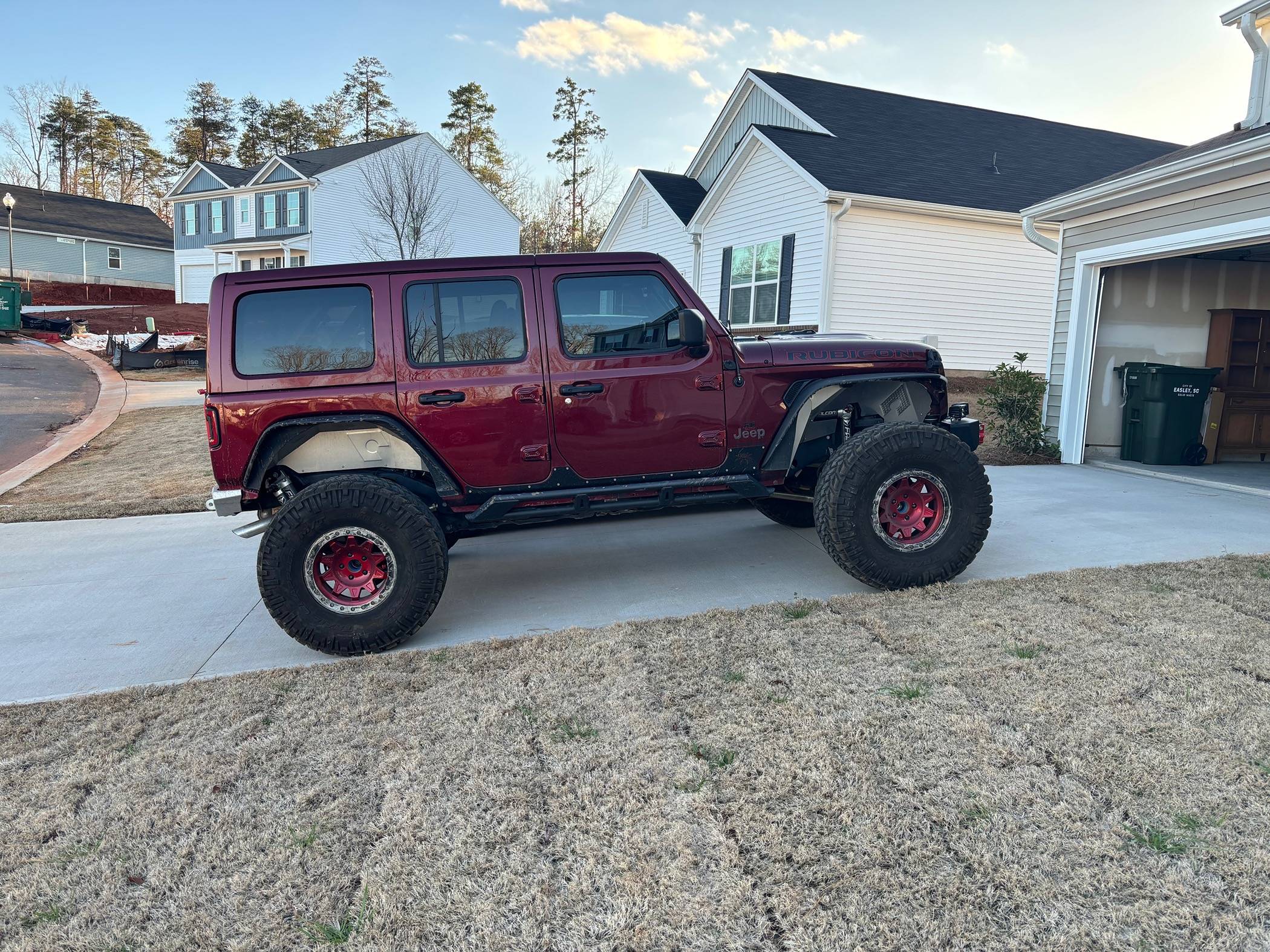

So, I will present a very slightly different perspective.
I also have a JLURD with Clayton 2.5. I have Reid knuckles, Dynatrac ball joints, and an Adams front drive shaft, but haven't trussed / gusseted...yet. And haven't switched to RCVs ...yet. I am also still on 3.73 gears, through will likely go to 4.10s soon.
I started with 35s back in the summer of '20 then soon after went with the Clayton 2.5 suspension, then 2.5" Fox shocks. And...I loved that set-up. The 35s looked just a bit small in the wheel wells, especially as I stripped the inner fenders and liners. But the performance was great. I commute about 100 miles (round trip) in my jeep 3 or 4 times a week. It got 22 - 23mpg, handled great, and when I took it off road (once a month or so) plus summer trips to places like Moab it worked well. So, I was happy with the 35s.
But...I was also interested in 37s. So, when it came time to replace my 35s this year (60k miles), I replaced them with 37s. The 37s fit, no extra bump stop needed (because of no inner fenders and no liners). They ride great, look way better than the 35s on the vehicle, and even with 3.73 gearing I still have plenty of power. The one big downside is they took my MPG down to about 18.7. I am not exceptionally happy with that.
Lots more detail on my build thread: Diesel Build - 2020 Sting-Gray JLURD | Jeep Wrangler Forums (JL / JLU) -- Rubicon, 4xe, 392, Sahara, Sport - JLwranglerforums.com
Overall, I think the choice is in your use case. Are you mostly going to use it off-road and want the best capability and not so concerned about cost? ... 37s (and lots of other parts). Are you mostly on road and need comfortable easy driving and good mileage? ... 35s (and limited additional changes) Do you want something that looks good to drive to the mall? ... 37s (and limited additional stuff).
Bottomline, I personally was never unhappy with 35s. I was a little frustrated on some the bigger obstacles as I watched 37 equipped jeeps have an easy time than I did. Will I go back to 35s...probably not. But the switch to 37s will in the end probably end up costing me about $8k in additional stuff (regear, RCVs, truss and gusset, tie rod and drag link, etc), not counting the lost mileage.
Worth it...maybe. Probably. On most days.
