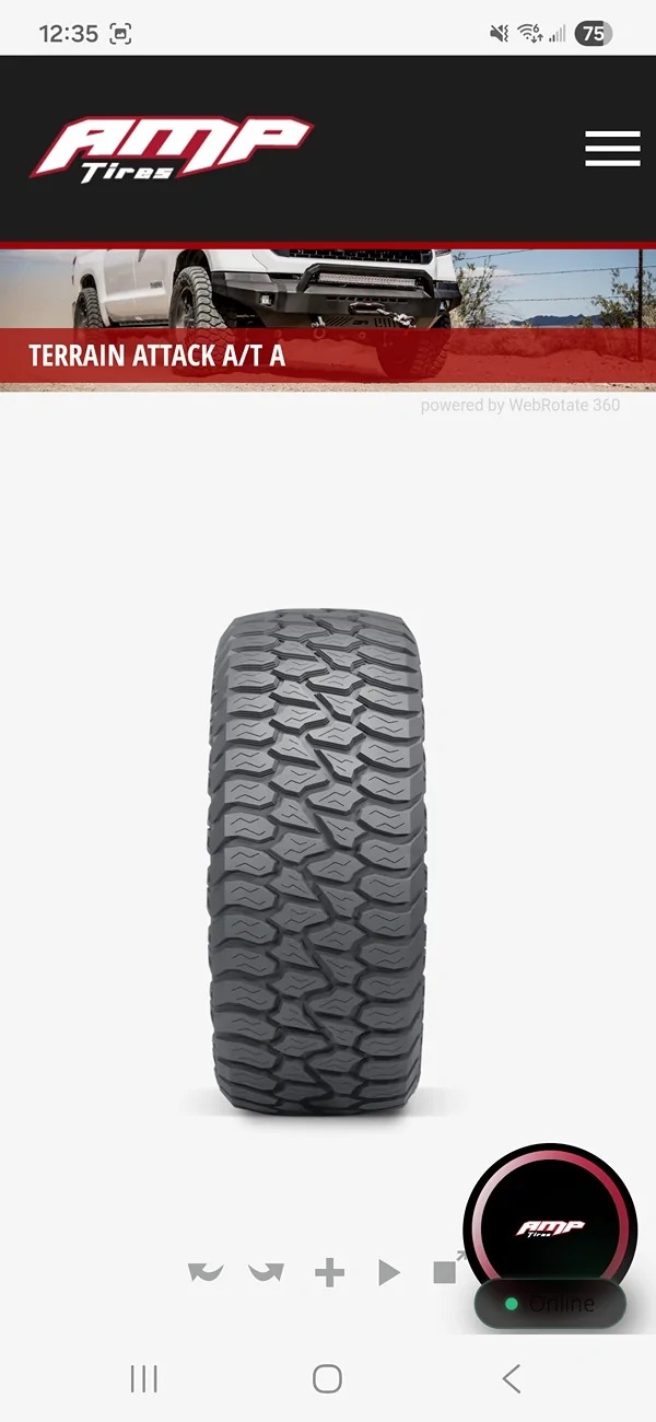

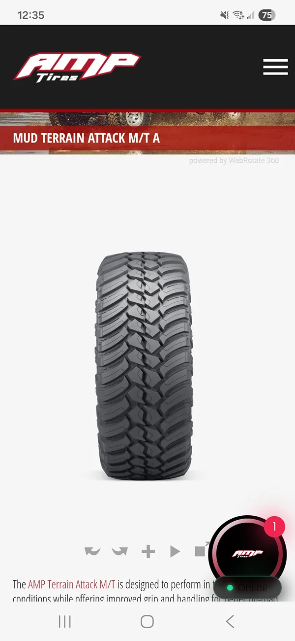

I've used these 35x12.5x20 "knockoff" similar too toyo open country with load range E and have been fairly decent when you consider the discounted price . The ride hasn't been too bad . The E load range tho is likely an inaccurate rating. But I've been pleased with them . Ive had the mt and the at on different trucks over the years. Id be looking for the same brand in 37s if I go that route

Honestly these things work pretty well i think they have a bfg pattern aswell. And the price point is real good .
