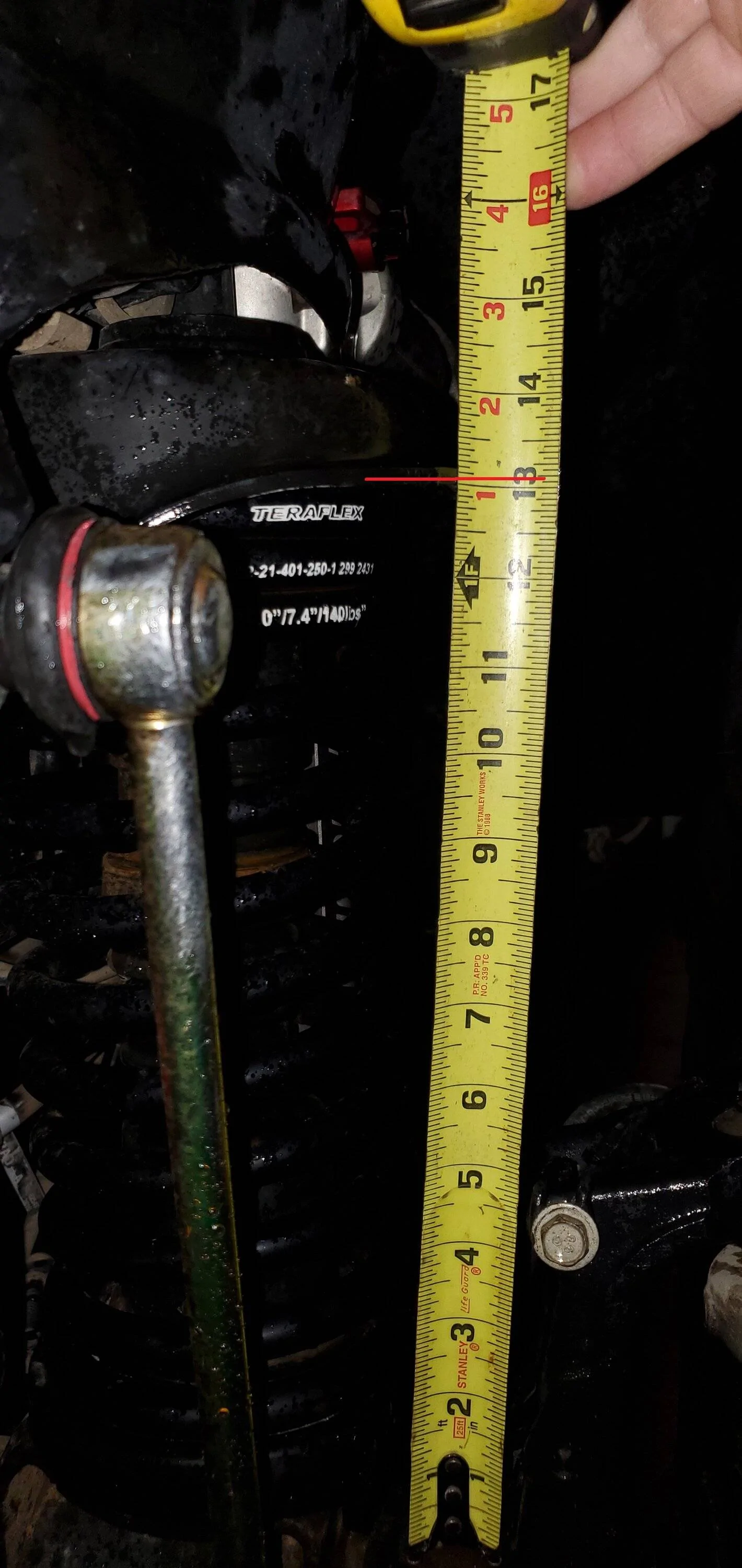

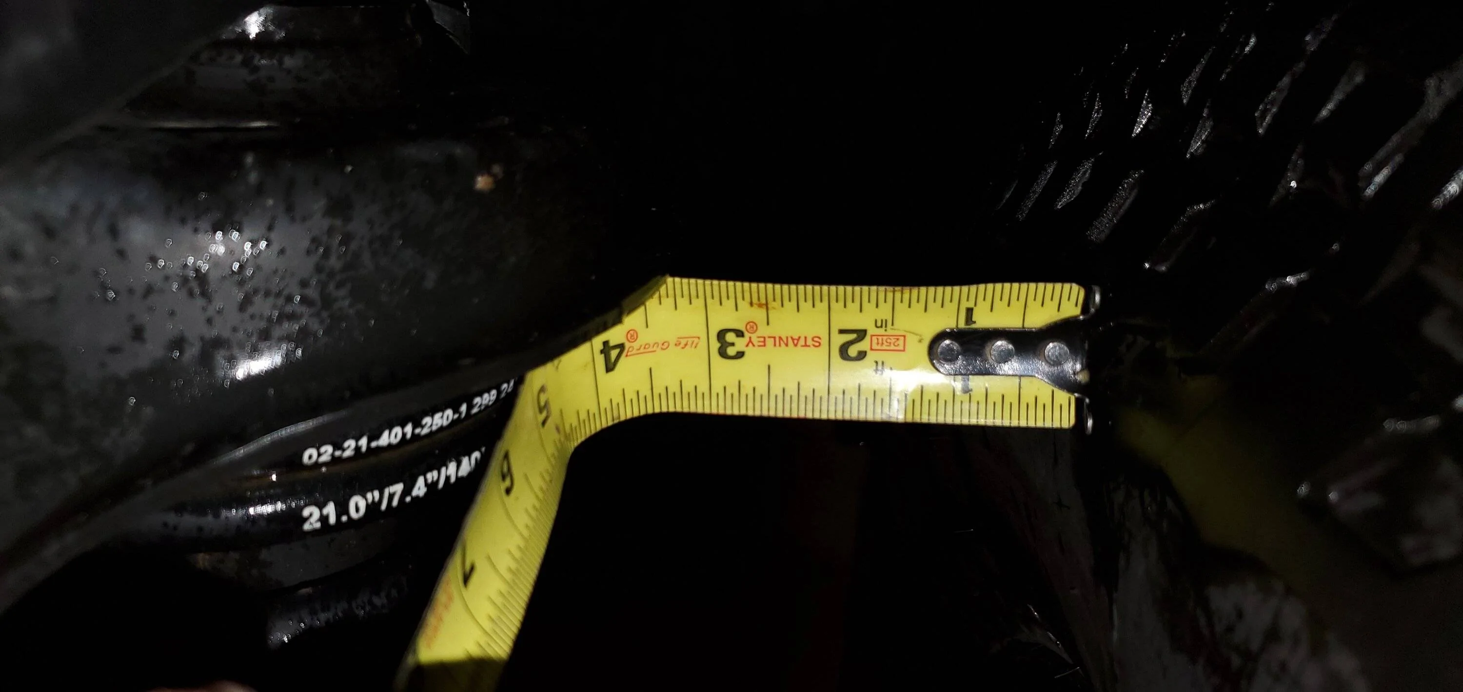

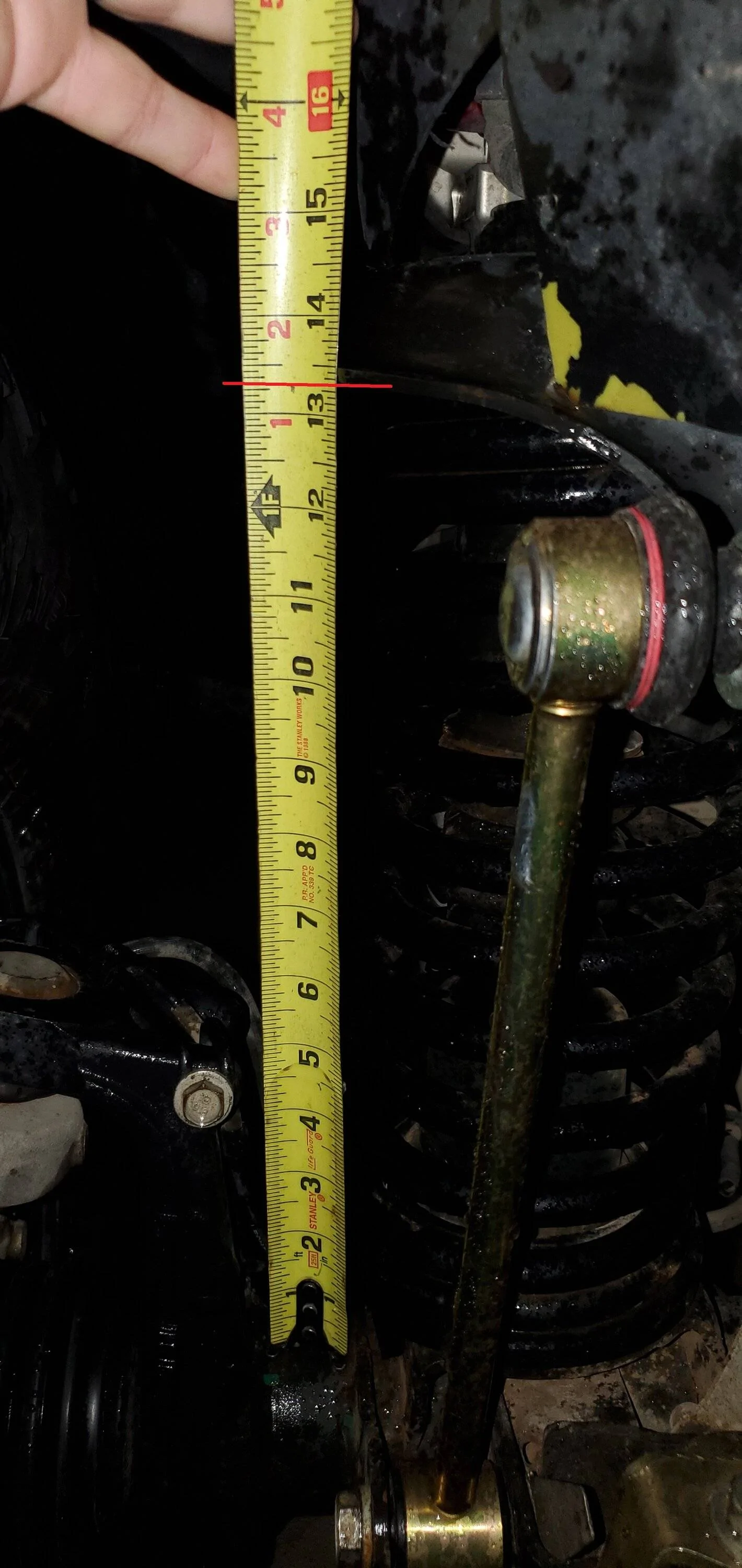

Is there a better way that I can measure axle centred?
I'm thinking the antisway bar end links are rubbing the same on each side. If the axle wasn't centred wouldn't they rub more on one side?

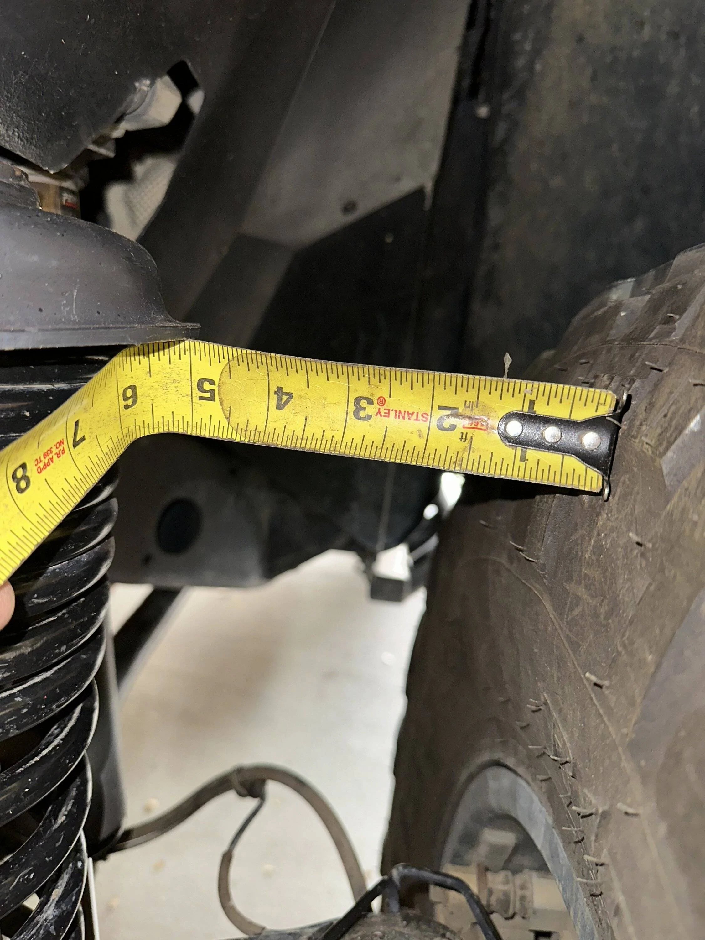

Put the end of the tape measure against the coil bucket and measure to the inside of the tire if tire is to tall to do like my pic. .that’s another indication that you don’t have 3.5” lift….

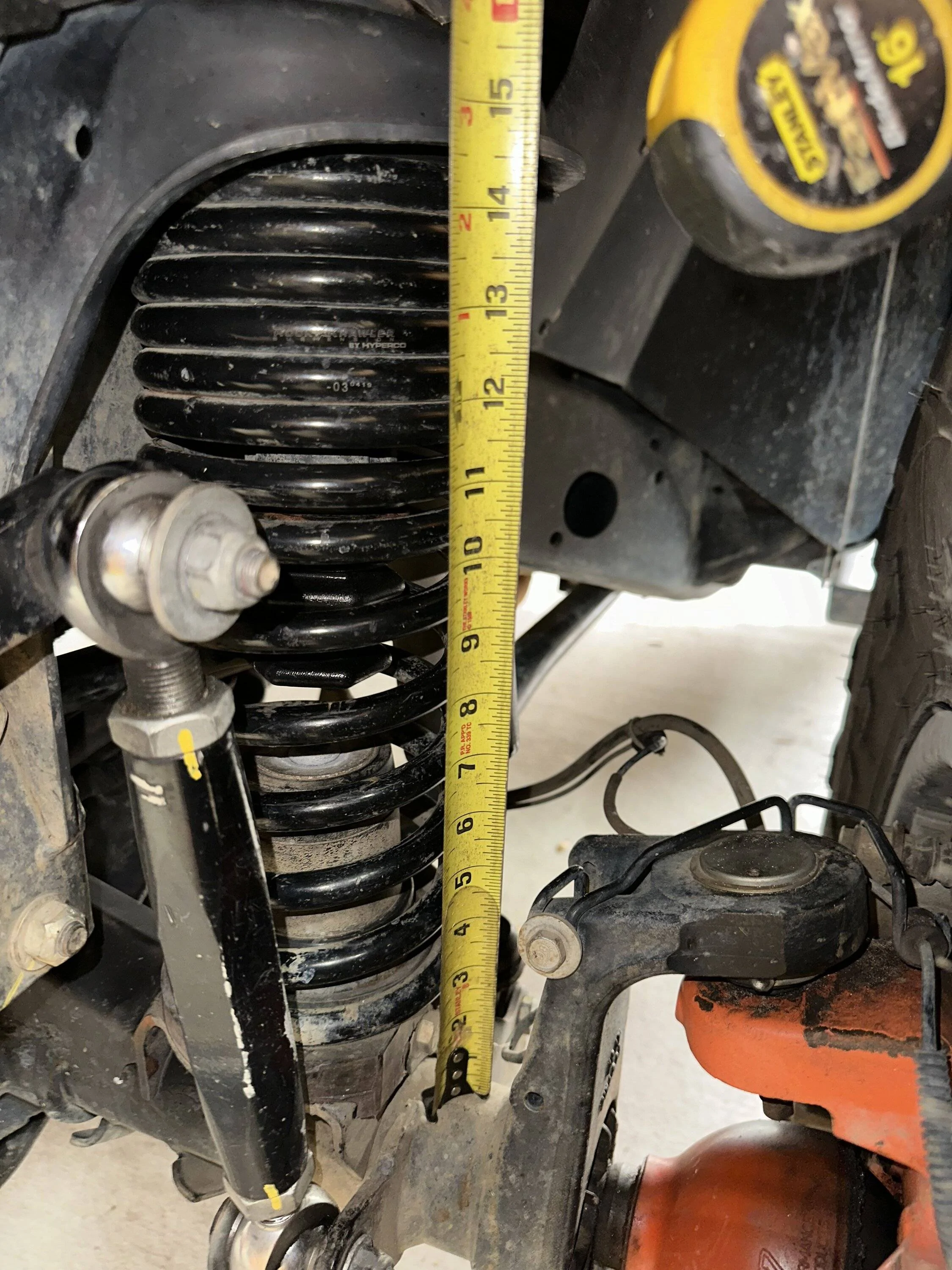

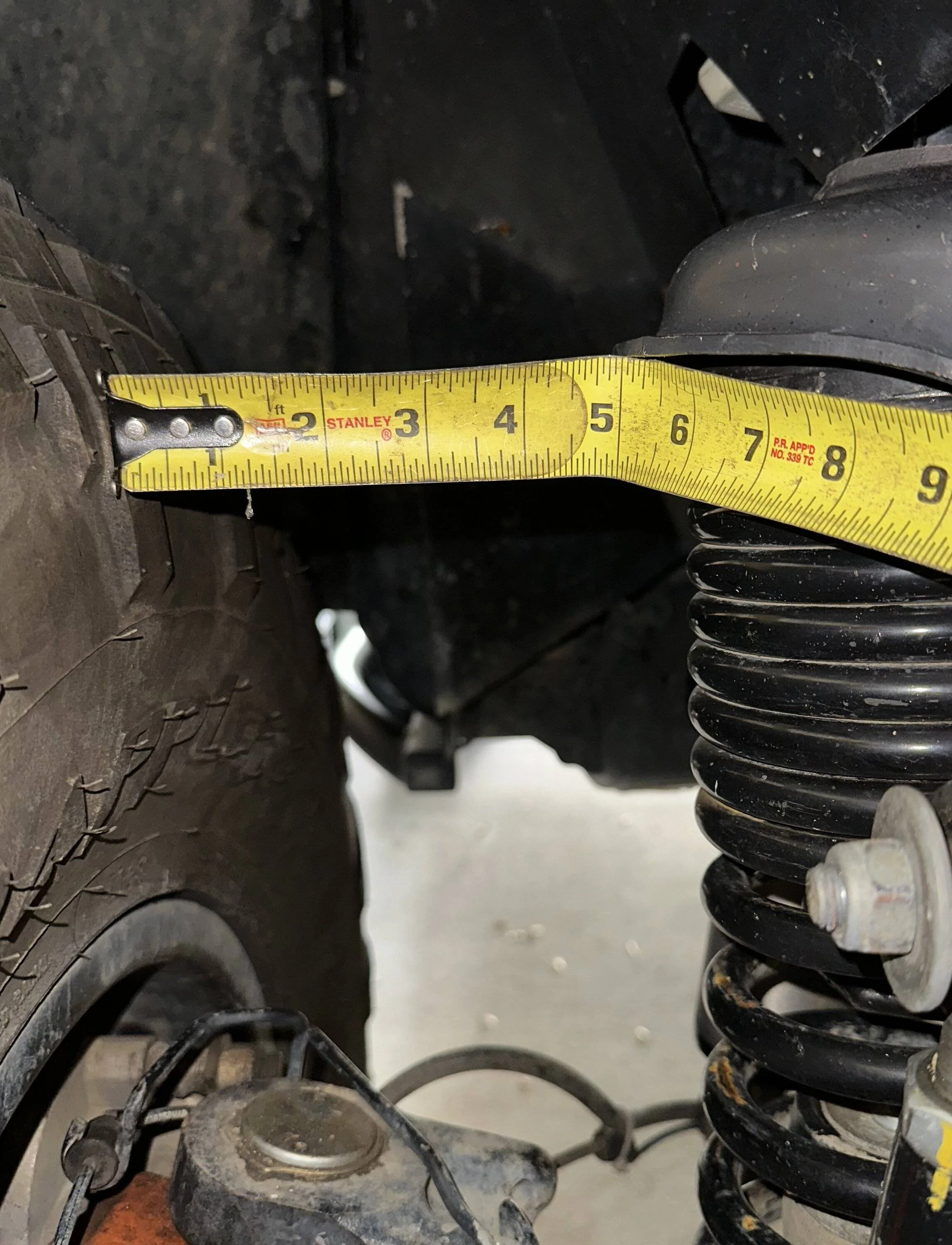

I went out and measured mine to show how you can measure…… looks like my 5 year old RK springs have settled an 1/8”, I can live with that…..?

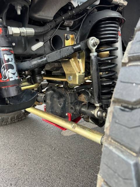

Here’s mine. I’m using different links but I put them at the same length as my MC ones were. Also, your backspacing is too much. I think MC says 3.5” to 4” backspacing for there lift. You do need to center your axle. How much of your lift is MC?
Do you know what the stock hight is?
some times the simplest things get you.
Why didn't I think to turn the tape around?

Stock Rubi 3.6 and 2.0 is 11.25 ish…..

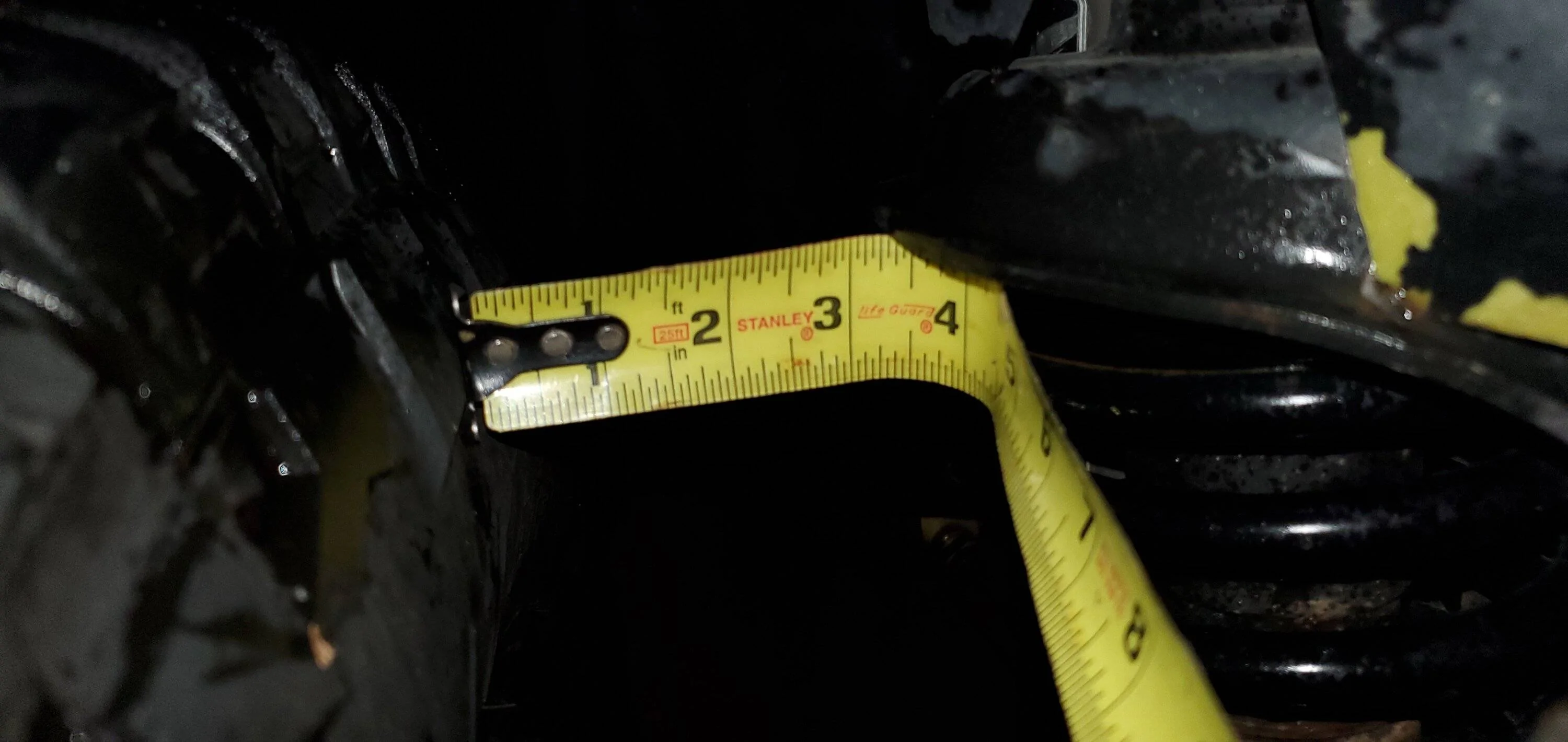

As it turns out except for the backspacing all is good.
See pic.
What type of spring are you running, looks like progressive.
All MC except for springs Teraflex shocks Falcon.
Axle is centred just the person measuring isn't quite centred.
The backspacing is to much so I found out, Dam AEV.
Will live with it though, only time it rubs is when aired down and flexing the tire.
What is your lift height and what type of spring are u running?
