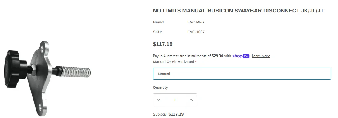

You could find someone offloading their electronic swaybar and just purchase this. Extremely simple to use. I have 2 sway bars off my JLURD and my 392, I think one of them even has longer endlinks from my metalcloack lift on my previous rig. Stop by if your ever in Vegas and you can have one of them.
On my first rig (JTM), I did have the apex which worked fine but did come loose every so often. Coulda shoulda used some blue loctite I guess.

I forget exactly what I paid for those rascals. I believe it was $450. I noticed they've gone up to $475. At the time I looked around for a rubi sway bar but couldn't find one locally or on the forum. I ended finding one on ebay. It was $500, plus shipping. Another $100 bones for EVO manual disconnect. I believe the rubi sway bar set up would have worked a little better with my factory wheels & skinny tires though. Fyi, Apex Lynx require a minimum of 4.5 BS.
