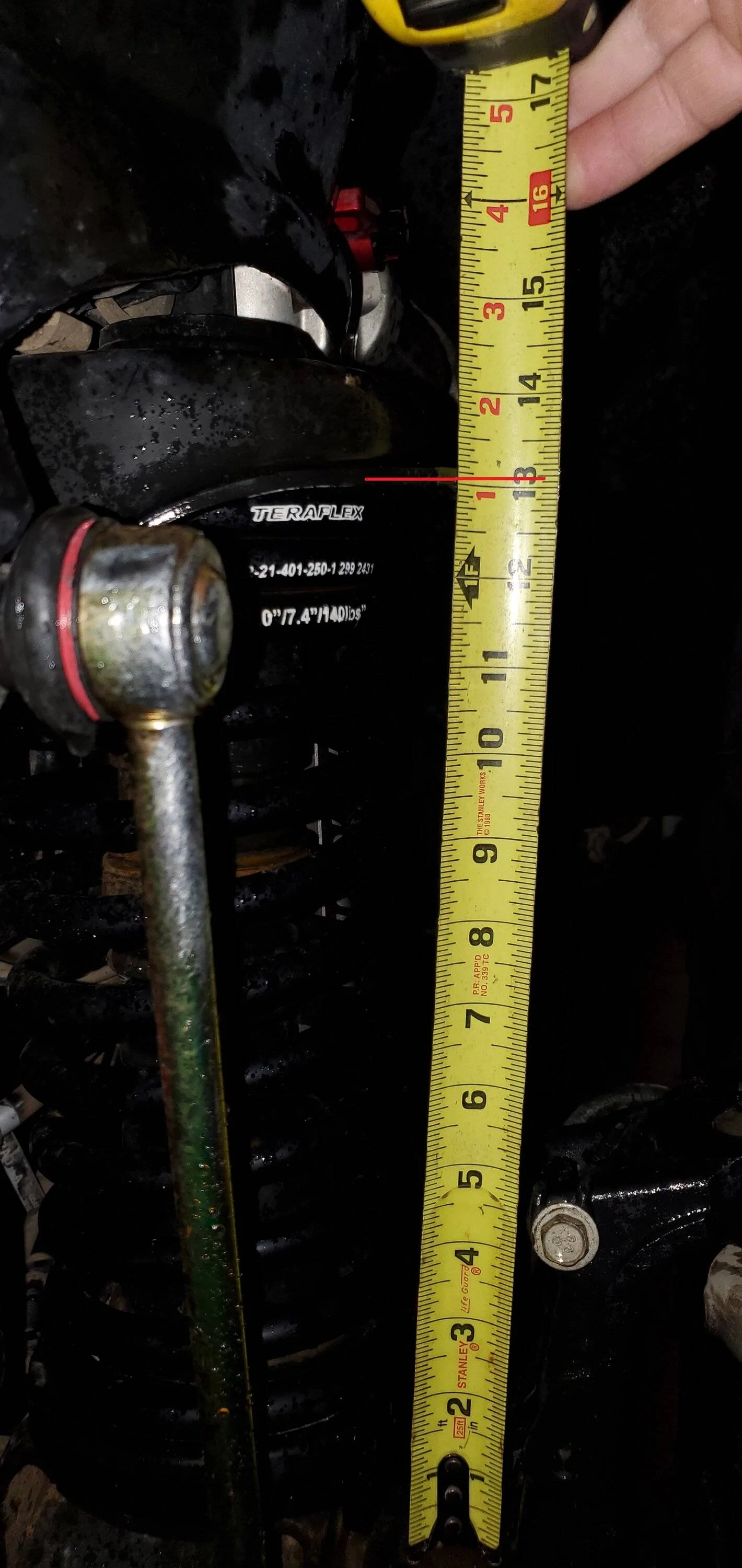

2019 Jeep Wrangler JLU Rubicon
All MC except for springs Teraflex shocks Falcon.

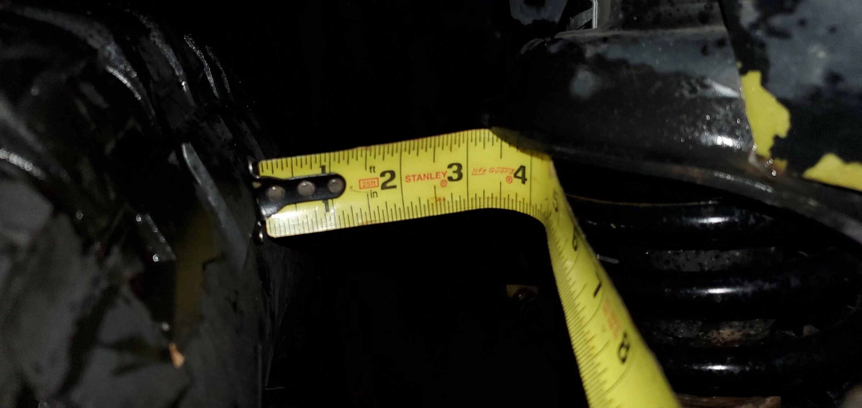

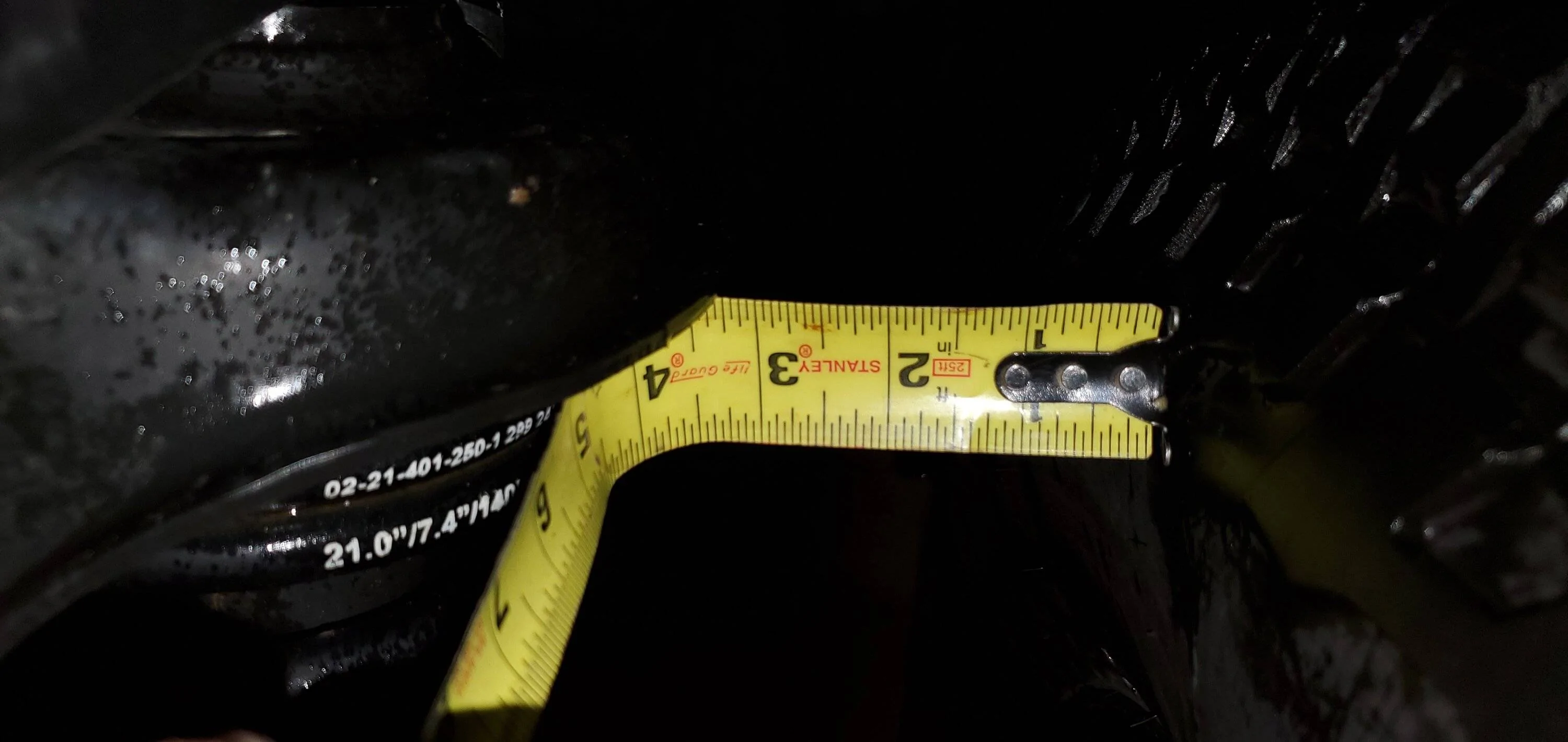

Axle is centred just the person measuring isn't quite centred.
The backspacing is to much so I found out, Dam AEV.
Will live with it though, only time it rubs is when aired down and flexing the tire.

That means I have bit less than 2in lift
Yeah, that’s what I was trying to tell you in post #2 that’s why your end links are angled up more than normal…. Then you posted that you have the MC 3.5 GC which I couldn’t figure out because your springs say Teraflex….. So whatever Teraflex lift was on before changing over to MC, was either a 2 “ lift, or a 2.5” lift that settled that much, I don’t know……. The more detailed information you can provide about your rig, like….. model, trim, engine, trans, bumpers, sliders, winch, lift, tires, rims, etc…helps us give you more accurate information which will get you to the fix quicker…….
